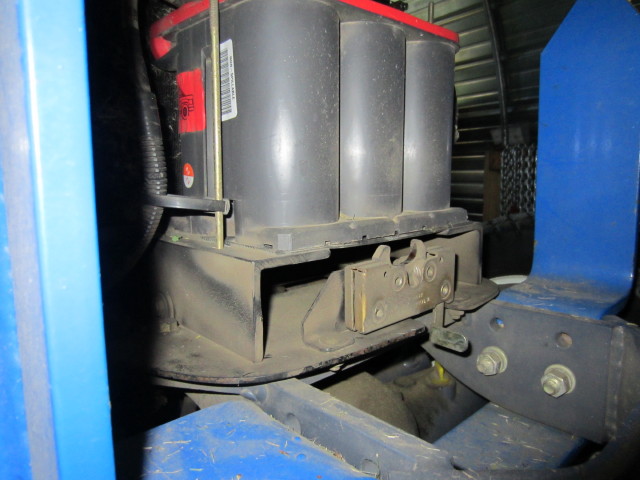

When I bought my TC33D about 12 years ago, I heard that the small battery in front of the radiator was giving up some acid and damaging the tractors. I saw the same thing was happening with mine so I replaced the battery with a larger Optima battery. I had to build a 2" riser so the battery would clear the hood latch. I have never had a problem since and am happy.
