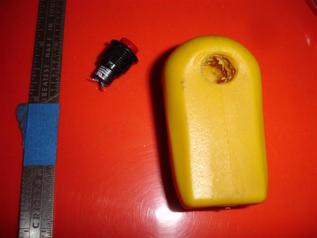

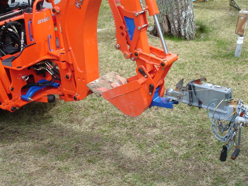

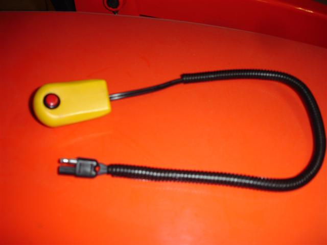

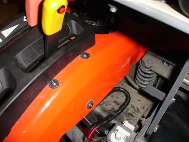

That slot is for the optional HST control lever. It allows you to control forward & reverse with your right hand (as though you were using the foot pedals).
Benefits are;
Can move the tractor standing next to it - watch your toes . . .
Much better control over the dreaded BX24 reverse "Slam".
Can move forward or backward while sitting with the seat in backhoe position -the red button in the pics overides the seat safety switch - great for trenching, or simply repositioning.
I rarely use the reverse pedal now as it is much easier to grab the lever, than step back on the reverse pedal.

Thats a great idea. I would love to see some pictures of the lever portion of it.

Dave, Do you have the kit number for that. What dealer did ytou order that from?? That would be great when trenching.

Keyman - you live about 10 miles from my house, your welcome to stop by & see how it was done - it was actually another Monster Garage project & probably a 20 + beer pimp. . . . the linkage took some time to figure out. I'll try to dig up some pics later but am off to work now.

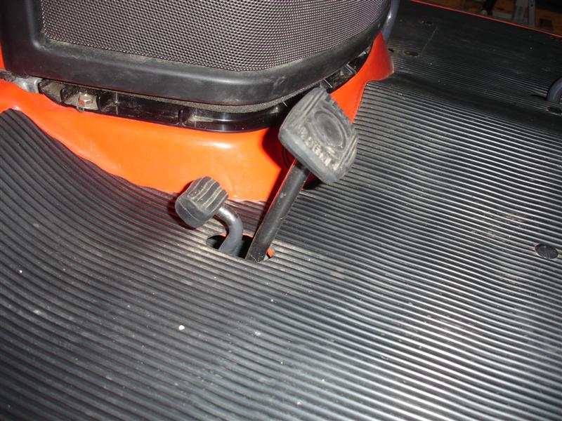

In the mean time here's another rarely seen option - a left foot brake pedal.
I found the stock setup pretty high and you must release the hst pedal to use it.
Hitting the new left pedal while slowing in reverse also eliminates that dreaded BX24 reverse slam.

I remember your June '08 post, but somehow overlooked the lever mod. I was focusing on the brake pedal mod as a solution for "neck snap." Except for the liability issue, these would make great aftermarket "kits." Again...great work...

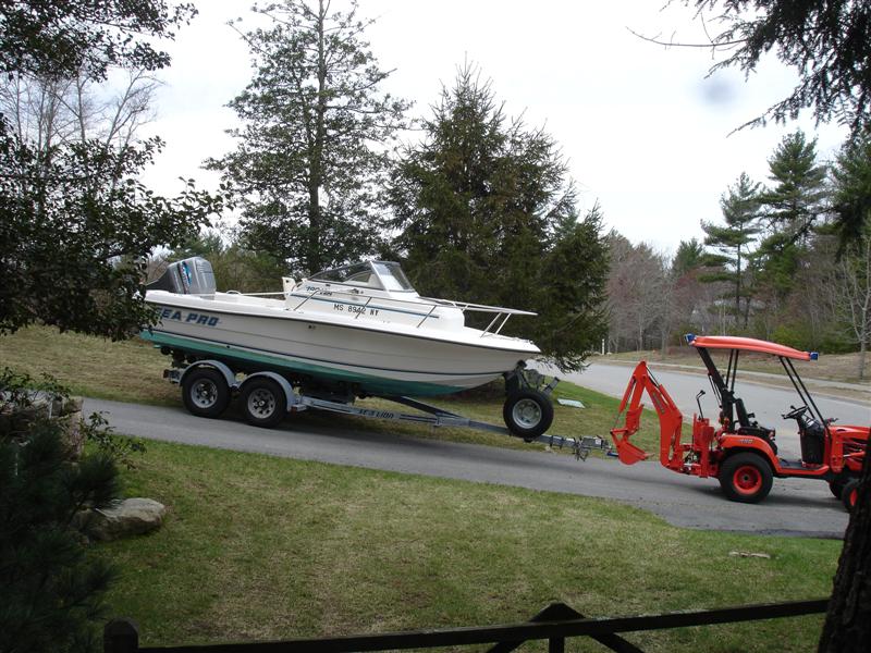

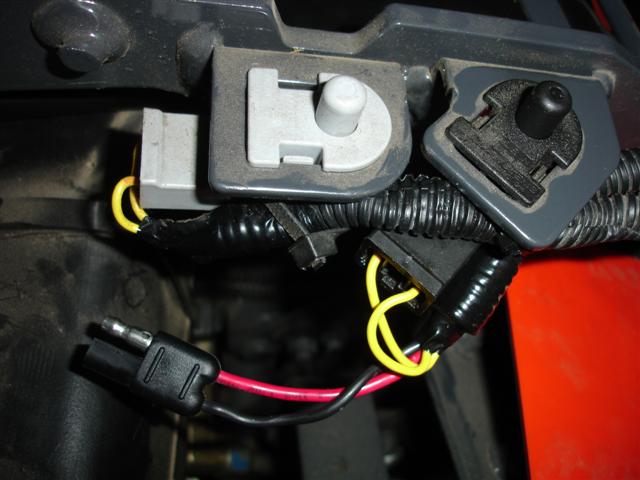

While both mods do mitigate the dreaded, publicly (& privately) embarassing BX24 reverse "Neck Snap" that many deny exists, though, those that knows knows, I still have on the shelf a cylinder ordered from Messicks (stock BX damper) for a future project to buffer the tail end of the reverse return travel - may not get to it for a while, but if it flys I will post some pics.
Time moves on though, and our snapped necks may simply become a faded memory as many upgrade to newer models.
Me, I'm married to the machine and TDDUP. . . . .
