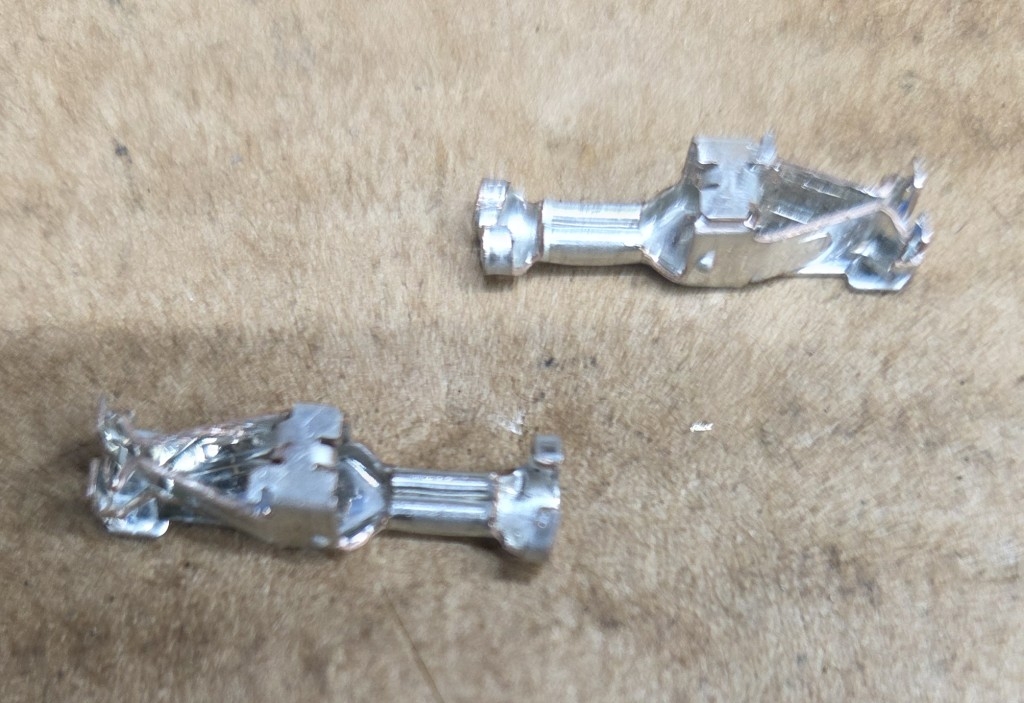

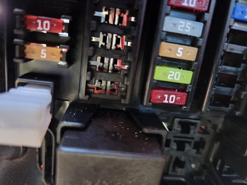

I'm adding some accessories to my new Kioti CK2620. It's fuse box has a bunch of open slots, but they don't have the terminals in them. So I'm looking for a source to get connectors that fit into the fuse block.
I don't want to use fuse taps or "piggy backs", I want to add an new fuse to one of the empty slots.
There was a couple blanks in the spare fuse slot, so I was able to pull them out, but they were already crimped. For now I soldered wires to them to add one new fuse which I've fed to another generic fuse box. But I'd like to just use the empty slots in the OEM fuse block.
Anyone found these anywhere?
Thanks,
Joe
This is what they look like:

Your photos are to fuzzy to zoom in well. Are you using a cell phone as a camera?
/ Fuse box terminal connector - Mini Low Profile #4
Worst comes to worst, you could solder pig tails to the fuses, and feed them through the empty slots.

Yes, I realized that when I cropped them, it was my cell phone. I've already re-installed them in the block, so I'm not able to take better ones.
Thanks, Midniteoyl, I have searched Amazon, eBay and other popular electronics suppliers, none I've found are like these. I even have some terminals from other fuse boxes and tried them, they don't lock in and or make contact with the fuse. I even tried to find a full "Low profile mini" fuse box, thinking I might be able to use ones from there, no luck.

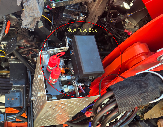

Midniteoyl, That's essentially what I did. I've been working on my own 3rd function system (I'm calling it a Dual 3rd Function, I discuss it here). So in doing that, I ended up purchasing a separate fuse/relay box and used the one fuse I was able to add to the OEM box to feed the ignition on voltage to it. It also has a separate direct battery feed for the hydraulic solenoids.
The impetus for this was adding work lights. So I did end up putting the fuse for them in the new box. I just can't believe it's so hard to find the correct terminal ends for the OEM box, Kioti had to get them from somewhere, I doubt they make their own.
