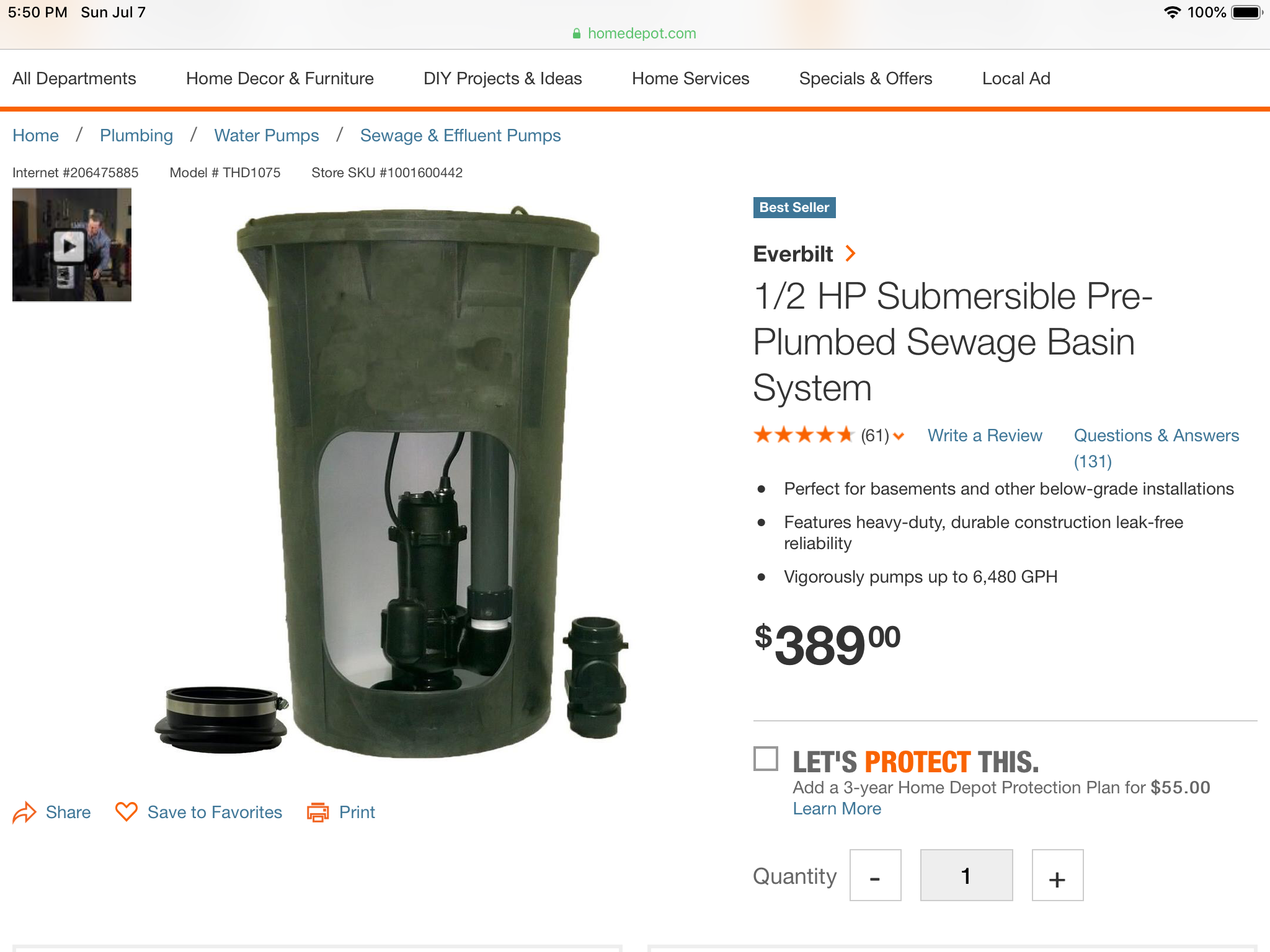

My shop is a couple of hundred feet from my house septic system. I installed one of these and ran a 2 pressure line to the septic tank. No problem for 15 years. Everbilt 1/2 HP Submersible Pre-Plumbed Sewage Basin System-THD175 - The Home Depot
