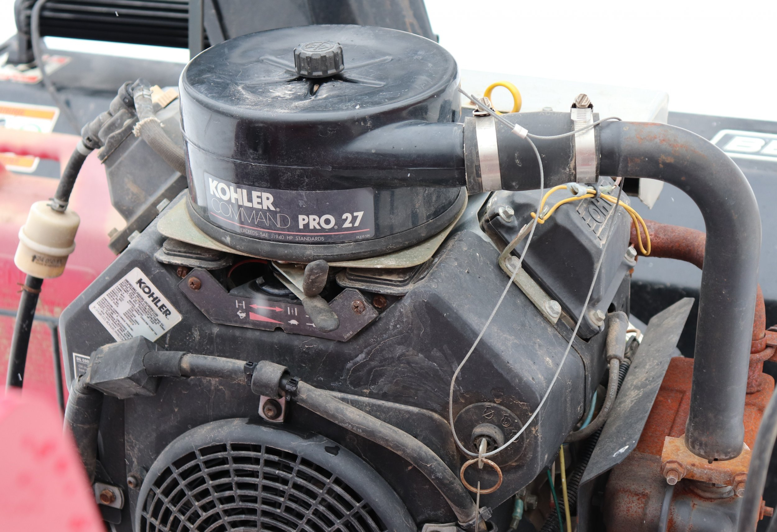

I have a BercoMac 66 inch blower that is powered by a 27 H.P. Kohler and it blows snow fantastic.

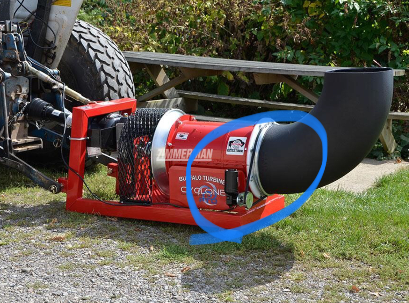

I see engine drive blowers on the internet designed like this with Honda GX 390 engines driving them but just curious if anyone has tried this with a rear mount before. Not quite sure if I would have to build a reverse gear box to have it turn in the proper orientation.
You might want the version with a 6:1 gear reduction on it to get you the correct shaft RPM. Have no idea what blower you have but 600 rpm should be closer to its intended speed than 3600 and you might need all the power you can get from the little engine.
The Honda engine is CC shaft rotation viewed from shaft side.
If you are using belt or chain it doesn’t really matter very much. Just turn the engine the right direction before you fabricate your mount.
Kind of like the circled duct adjuster here.
Change the mount so the shaft points towards the tractor vs away from it and you reverse the rotation relative to what it’s turning.

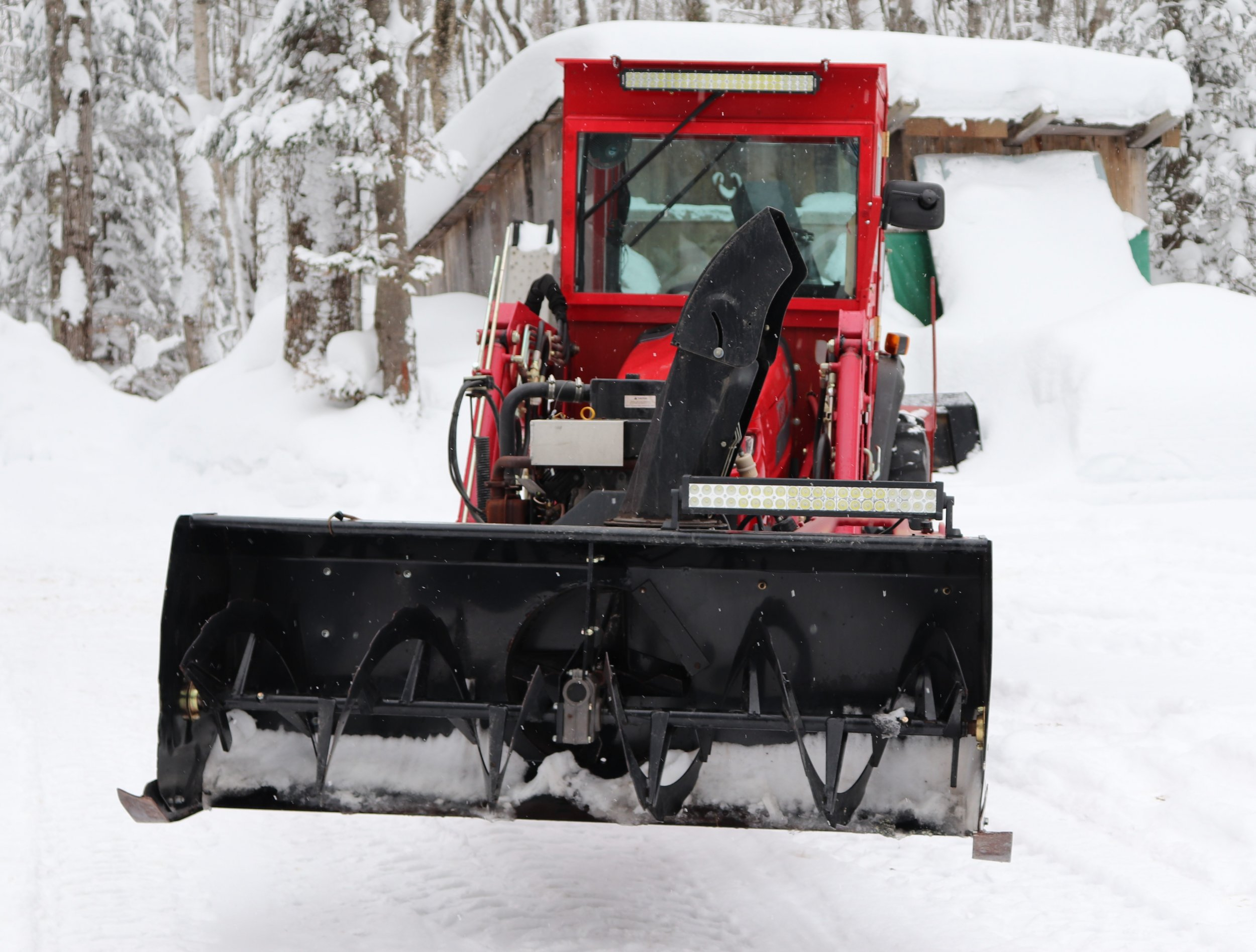

Might want to consider an inverted blower instead...
I'd love a front mounted hydraulic blower, but boy! They're spendy ($11K US).
As far as operating in reverse...that has never bothered me. Up to now, I've always had gear or reverser transmissions. The 4052 is an eHydro and the cruise control doesn't work in reverse. Bit of a bummer, but sitting in a nice warm cab makes up for that minor inconvenience...

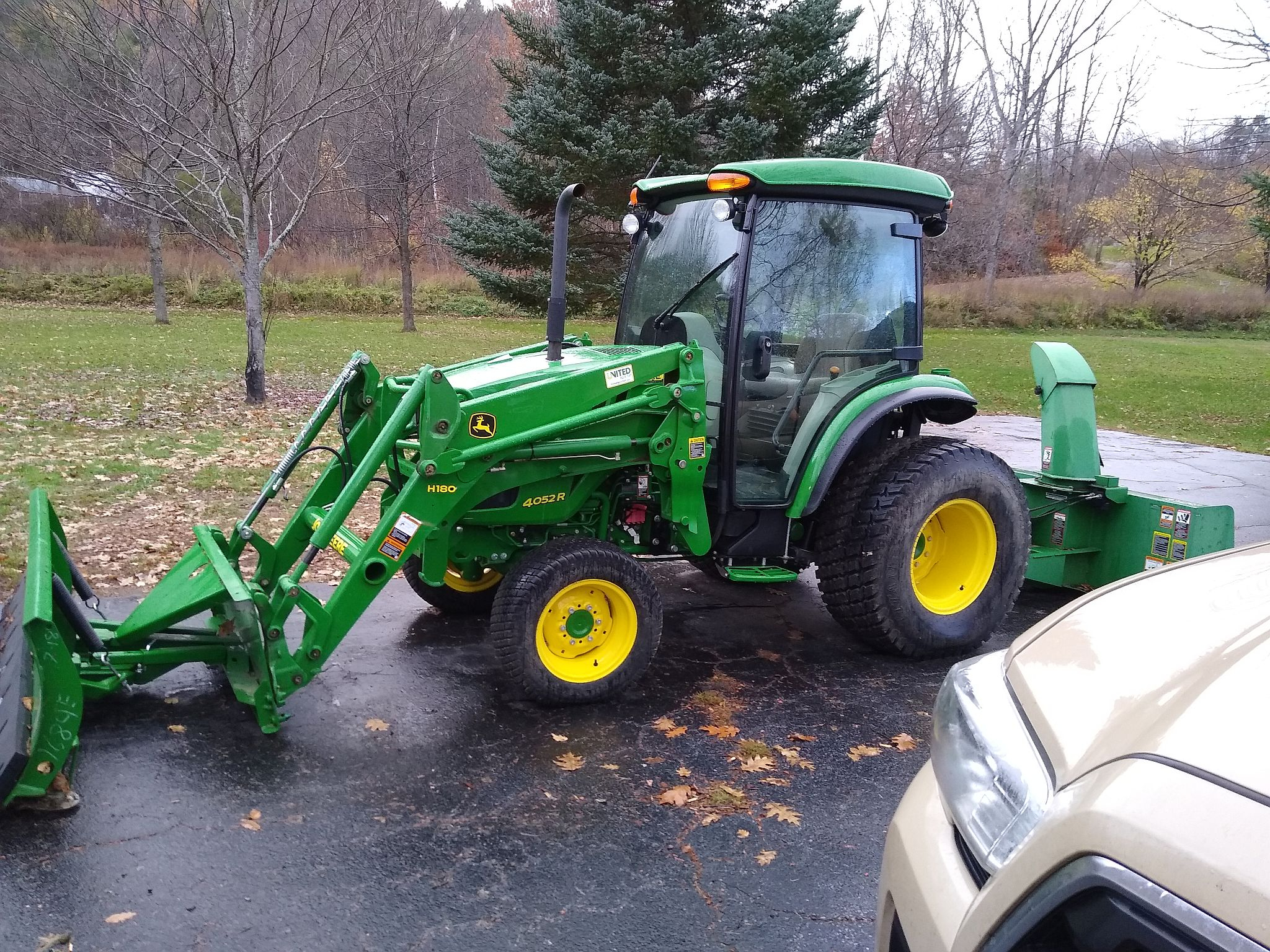

Best of both worlds:
One of these days, I might add hydraulics to the front blade and blower chute deflector (already have hydraulics for rotation). I have one rear remote and want to add two more, or get a diverter.
When I win the Powerball, I'll think about the front hydraulic snow blower.
One thing I've regretted is I had an Eagle Plow manual blade for the Gator. That was actually the fastest way to clear smaller (nuisance) snowfalls off the drive. Sold it for 50 bucks more than I paid for it...sure wished I kept it though.
The rig shown in the picture does my drive, neighbor's drive and the street (a cul-de-sac about and eight of a mile long)
No doubt, I could have (and maybe should have) gone with a smaller tractor...but you know the saying..."difference between men and boys is the price of their toys..."
