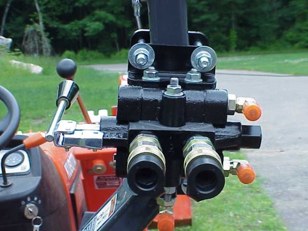

If you want to add a rear hydraulic valve to the BX23, it is quite easy. Kubota does have a kit for this, but it is difficult to hook it up the way that they have it set up. I modified it to work on the BX22 last year. If you decide to pursue this option, let me know and I will try to find the original post. The picture was taken during the early stages of the install.
Get the bar tires and forget the turfs. Not needed for general work and the bars will not damage your turf unless you are extremely careless.......
The high output alternator is a must if you add some additional lighting . If not, then the stock unit will work fine.
