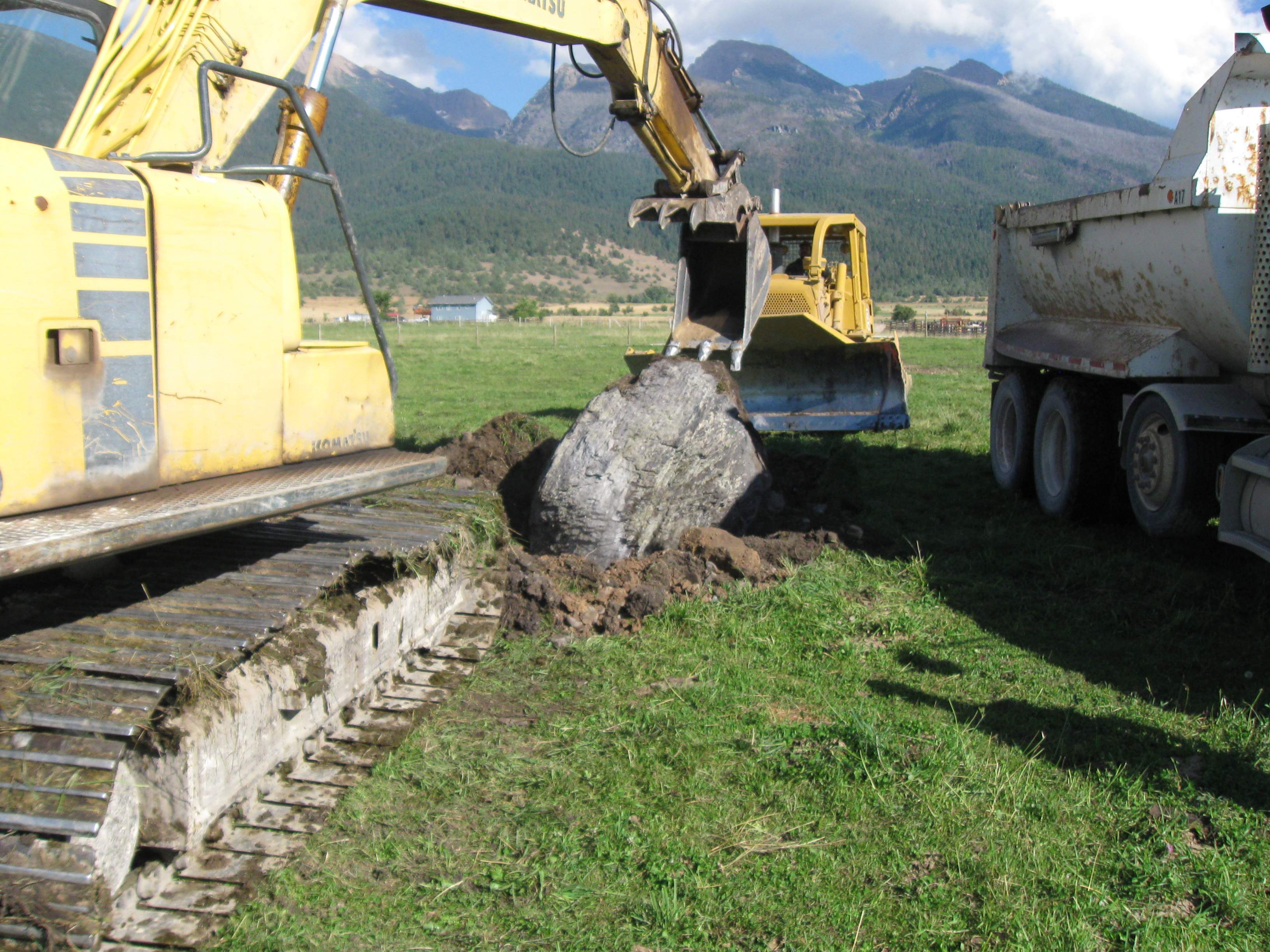

I live with large rocks (the size of VW's and PU Trucks). I have irrigated pastures and i just had some rock work done preparing a pasture for wheel line use. The rocks were so big that the Komatsu 120 trackhoe could not pick them up and we ended up burying them. (see thumbnail)
Is there a way you can fence around them? That's the easiest way to do it.
Another option, is to use high tensile fence above don't sink the line posts, just use them for wire spreaders and let them rest on the ground/rocks.
You can also build a platform supported post and you pile rocks on the platform to hold the post in place. These are use a lot on open range in rocky areas here in the West. I have a rocky irrigation ditch crossing where iI am considering making a basket out of field fence, 4 ft high, filling it with rocks and having a treated post set on the edge of iof the rock filed basket to nail the wire to. The rock basket holds the post in place which it turn holds the wire. There's also jack leg fence.
Without seeing the specific kind of problem you have it's hard to provide any better ideas. Maybe you could post a picture of the area you are talking about.
