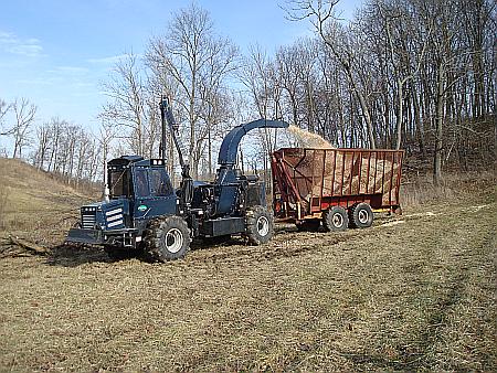

Have you considered Fecon RTC 22 Mobile Chipper with
unloading hopper?
Land Clearing - Mobile Wood Chipper - RTC22 - Fecon - YouTube
Or directly to truck:
Fecon RTC-22-Bio-Mass Chipper.MOD - YouTube
