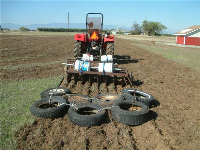

Rototillers are for small home gardens and small size row crop vegetable farms--not for hay farmers doing field cultivation. Tillers eventually clobber the soil microstructure to the point where drainage problems become critical. Figure if you rototill your 9 acres, you're going to have to apply manure, worm casings, compost, etc. to restore the soil's tilth, probably every year. And unless your tractor has a hydrostatic tranny, rototilling can be an aggrevation since your ground speed is limited to 1 mph or so to get the rototiller to work effectively. Also, rocks can do a number on the tiller tines.
Better to use a plow and disc for your field. If clumps are a problem, attach a home made drag to your disc. Or tow a cultipacker behind the disc.
Here's what I use for my 6-acre hayfield. It's thin gravely loam. The good soil is only 4-5 inches thick so I use the offset disc for primary tillage. Don't use a moldboard plow.
