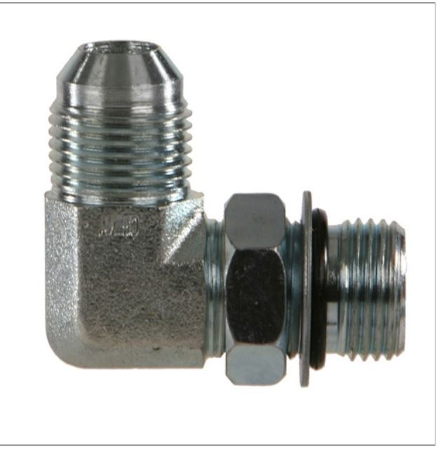

Can you alignment of this fitting be adjusted? Like can the direction of the JIC connection be adjusted around the radial axis of the orb connection?
   / ORB fitting question #2
Yes, that is one of the purposes of ORB fittings. Put it in whichever direction is required and then snug down the nut.
   / ORB fitting question #3
Yes you can orient an elbow like shown in the picture to a desired position.
Before installing make sure the jam nut is backed off and the O-ring is located towards the top of the area without threads. Screw the fitting in by hand until the O-ring makes contact. Now turn the fitting to the desired position and tighten the jam nut. Intention is to keep the O-ring sealing on the area without threads
