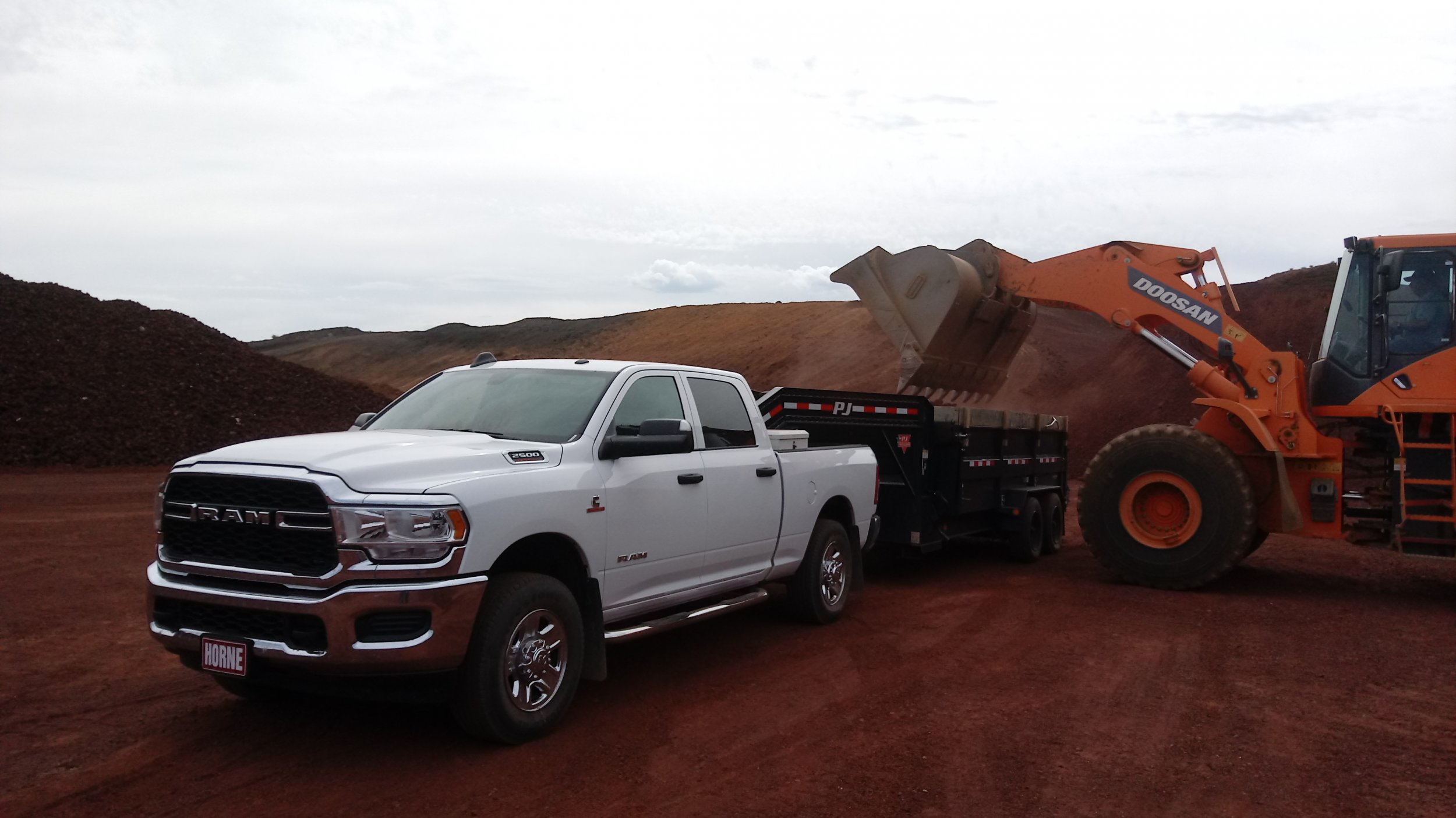

Other than rear suspension, there is virtually no difference between a new 2500 and a SO 3500 srw. Show me what you tow that my 2500 wont.

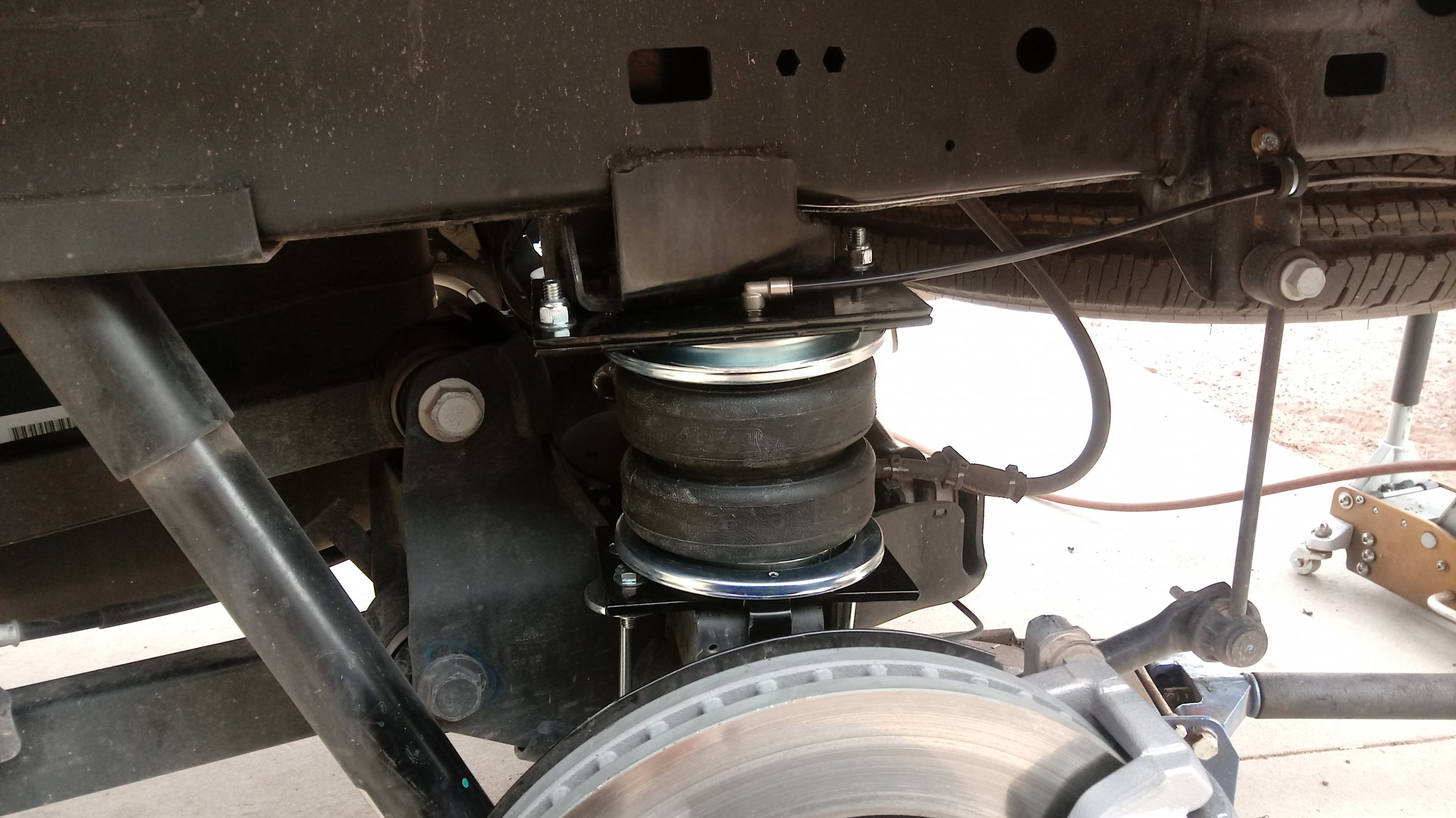

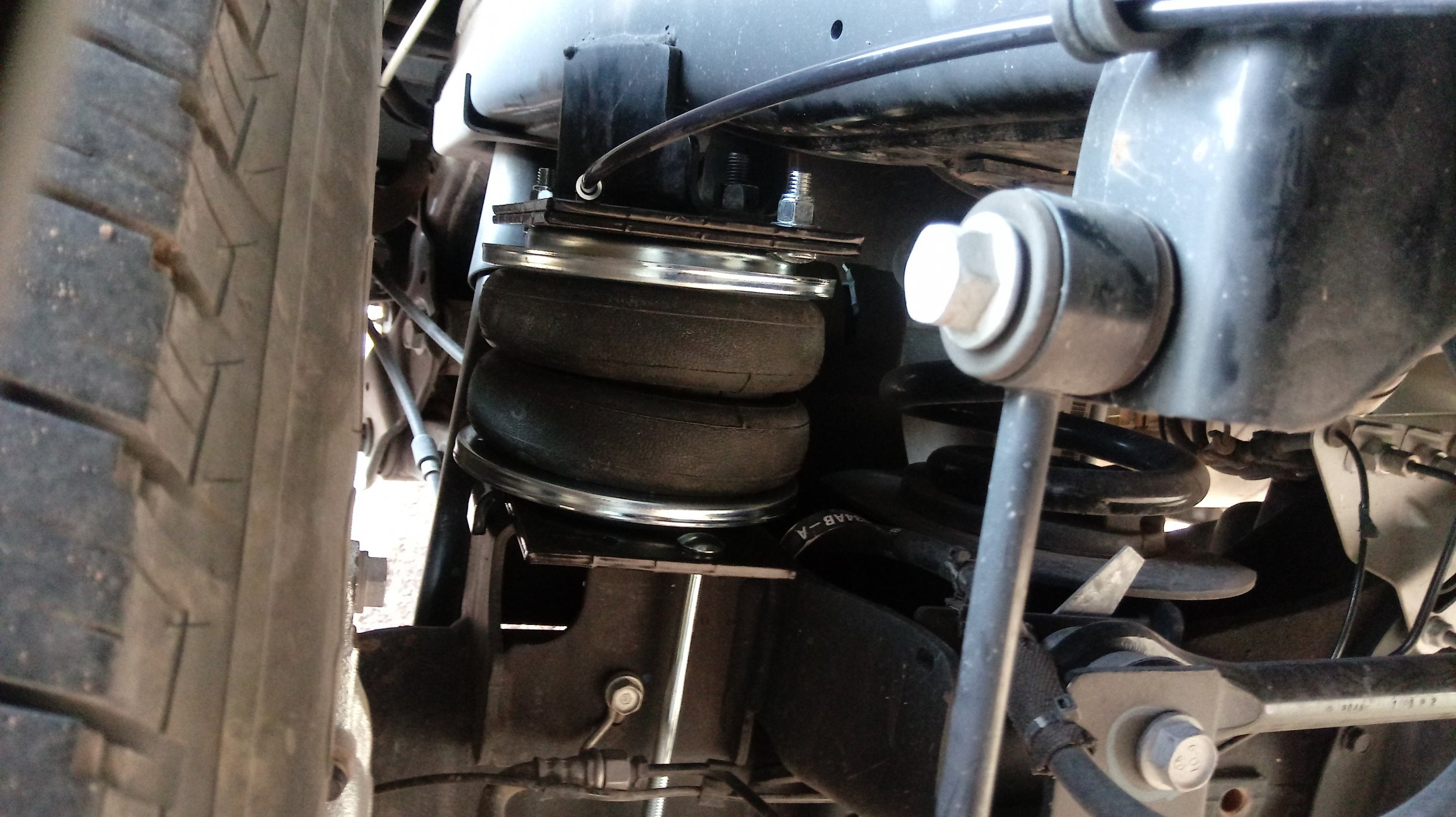

Coil springs are awesome. The ride is unreal and if you tow with a gooseneck ball, they are as stable (or more so) as any 1 ton. Think about it. 5 link is great. Just like traction bars only better. No axle wrap to cause drive line buck/misalignment. Track bar controls any sway you might encounter with axle/frame side movement, there is none. Then when you add air bags outboard of the frame, now you have support on both sides of the frame. What's not to like?
Then to top it off, the shocks are wide spaced because the frame is so wide. No leaf springs in the way. The shocks also both have a forward angle, so the resistance does not rock the axle like one mounted forward and one rearward.
A heavy overhead camper, not so much, but that is not what my truck is for.
I tow my dump trailer 20k miles per year, mostly off highway @ 26k+ gcw. It works for me.

Coil springs on anything other than a car blow. The ONLY reason they did that is coils are cheaper to manufacture and fit, versus leaves and leaves have inherent dampening, coils have none and rely 100% on the shocks for dampening and they will wear out much faster....and you still have air bags installed... boo hoo...
Additionally, with coils, you require track rods to hold the rear diff in alignment with even more bushings to wear out. With leaves, none of that is required.
