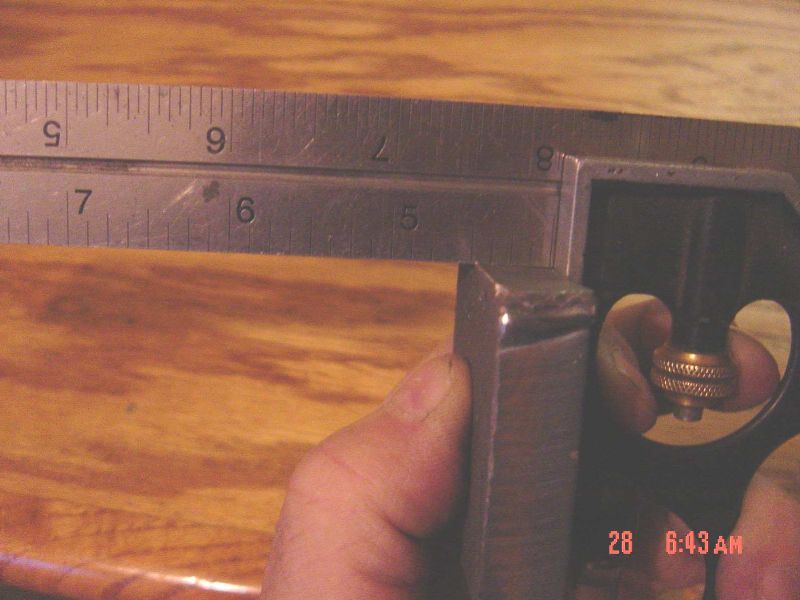

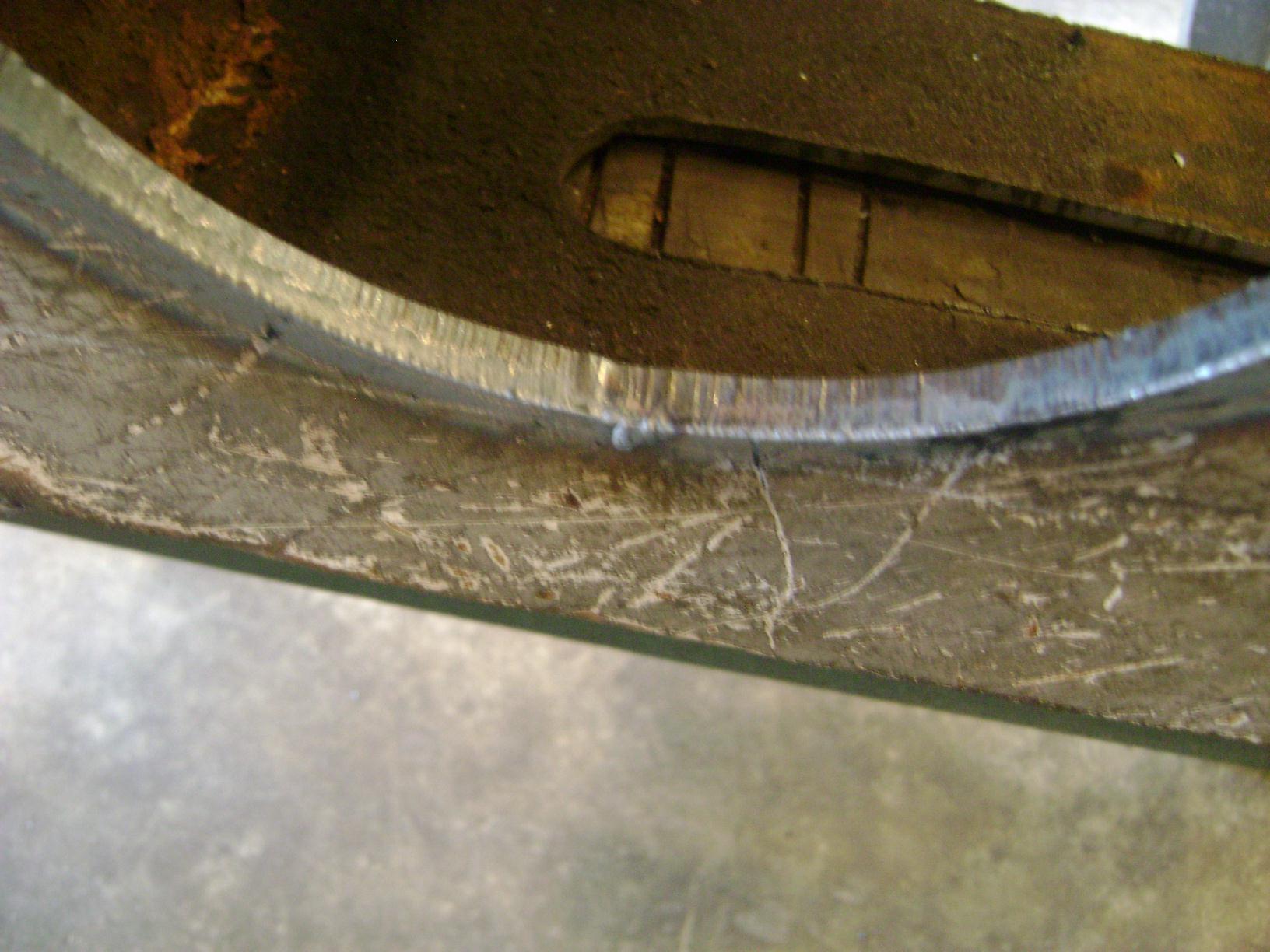

I don't have any good pictures of plasma cuts by hand, this is about as good as I have. The plasma cut is the slot in the back ground, the circle cut was with an O/A torch.
The picture with the tri square was on the CNC machine.

I would say you are getting what you get cutting 3/4 with that 50 amp unit. It was cut a little slow according to the dross but because of the slant of the cut lines, It looks like you couldn't rally go any faster. I would say you are at capacity. Some fancier brands will have a little more refined torches and consumables and can make that cut a little nicer. Don't get me wrong, I'm not ripping on your machine. Thats a good cut for the price you paid. Like you said, You can improve it with a cutting guide, Standoff or more practice.

Looking at it closer, it looks like you started a little rough, maybe a little impatient but about half way through the cut you found your rhythm and the dross disappears.
