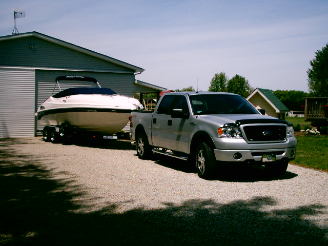

Hi Guys.. it's not hard to install them, just try and take a little extra time and use the proper items for the wiring, AVOID using scotch lock connectors sure they are simple and quick but a year later you will be back repairing the wires. Take the time to use barrel connectors with a good dual wall heat shrink (the type with glue on the inside) this will make a bullet proof connection. Bring all the wires including the grounds back to a junction box that you can mount (if there isn't one now) on the trailer,doing this with all the wires on the trailer will also help trouble shooting later either with the brakes or lights. Taking the grounds from the side of the trailer is asking for problems later in life.
Just remember the the backing plates have a left or right stamped on the back of them, if you get these reversed the brakes will not work as planed (unless you want REALLY good brakes in REVERSE LOL), before you mount the plates it's worth taking the adjusting wheels out and give them a little lube. remember once every thing is together to set the brakes shoes up.
Just take your time, and everything will go as planed.. Jim

Again good advise. I will say though I have 2 7K trailers both with brakes on one axle and both do fine behind my lighter 1/2 ton trucks and is a non issue behind both PSD 3/4 and 1 tons.

Got the brakes installed went pretty smooth,like anything else it would go faster the second time. I did kind of a hack job on the wireing useing stuff I had on hand. My next prodject will be rewireing the trailer. Thanks for all the input.

And speaking of wiring it seems to me as though the wire within a foot or so of the brake assembly and drum will need to have some slack given that this axle needs to move up and down with road deviation and potholes.
No Scotch Locks? Too late they are in but I did tape them up good. The trailer is all ready equipped with several Scotch locks by the manufacturer. To power my front axle brakes I just tee'd in to the powered brake immediately to the rear on each side.
