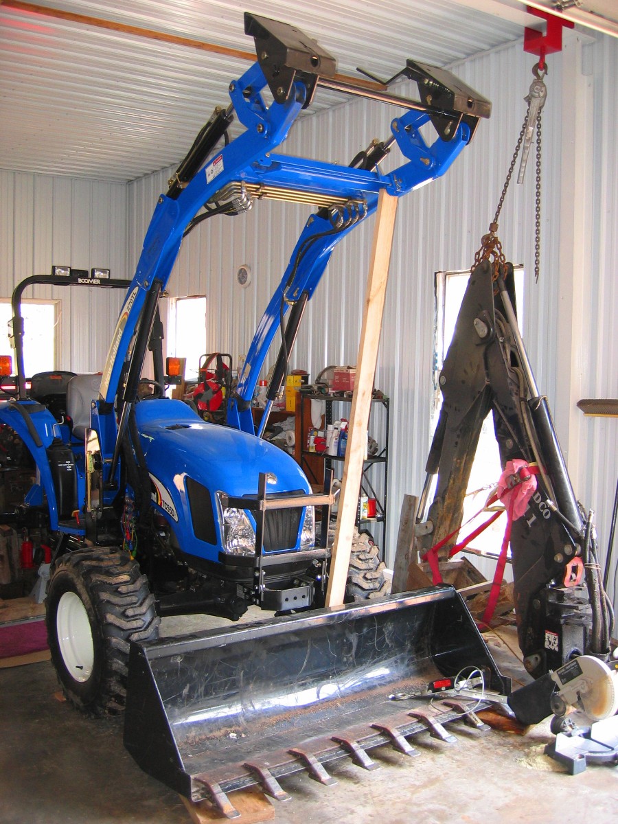

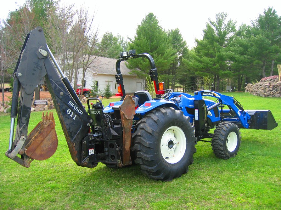

Yes, I looked at several different mounts and came up with a cross breed of my own design. I will try to dig up some pictures. It is constructed of 1/2" plate and 2 x 4 x 3/16 extensions to the front of the frame.
I didn't paint anything ( only primer ) because I wanted to test it out to see if there were any weak points to revisit. I'm happy to say it works beautiful and the 55DA provides enough flow at 1500 to operate the hydraulics. This spring in between seven other projects I will take the hoe off and give it some NH blue.
One thing I did try was lifting the rear axle up while digging and moving the machine forward without leaving the backhoe seat. It is solid as a rock. The 611 is overkill but works so well.Total cost of the mount in iron and bending the mounts was less than $250. with new steel.

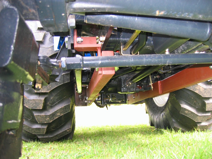

There is no magic involved. I looked at a few different mounts and basically made mine to fit this individual tractor. I coupled the base as close as I could get away with and mounted to the existing points on the rear axle housing. I didn't have room for the three point arms to remain in place so they are removed. The extra weight works out real well with the loader applications. I don't have wheel weights or fluid. ( yet )

Thanks for the pictures Joe! Do you have any shots from the rear, where the mounts come off the axle? Fabrication looks first rate, excellent installation. The Bradco looks to be well suited for the TC55. I'm sure you have to be careful, due to the 611 being a powerful hoe.:)

I didn't get any good pictures from the rear mount because I had the machine backed into a corner. At this point I had the mounts figured out. Just a matter of attaching and making sure everything fit properly. I ran across some stainless steel 3/4 " bolts at the steel place which worked very well. I should have some better pictures in spring when I remove it for paint. ( project # 9 )
I would like to buy or build a 24" bucket. I know the machine can handle one and it would remove material much faster than the 16" I have. I already bent the 16" tooth plate .... so your right IH3444, it has alot of torque !

To me the 611 looks to be the right size for the tractor . Good job on the sub-frame it looks strong enough . I would like to see the mount for the backhoe . We have a 509 and the said they sell a plate and sub-frame to attach it to my TC55 for around $1100.00 it seemed to high to worry with . I dont really need to use it on the 55 since we have other machines . But it would be handy to have more options since our work is scattered around .
