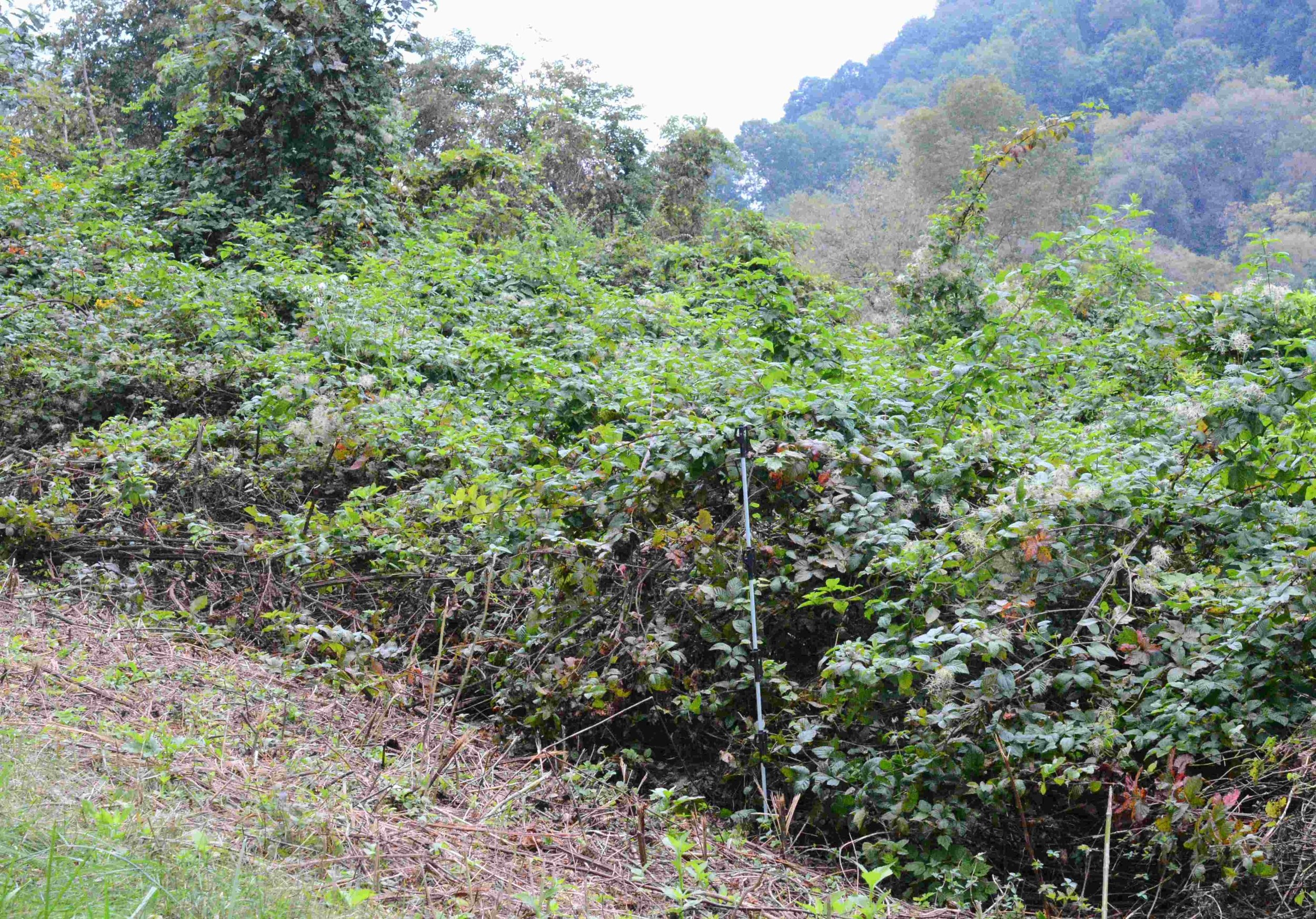

This is an example of the tangled brush pile I want to cut. There's a 48" step post sticking 42" out of the ground for perspective.

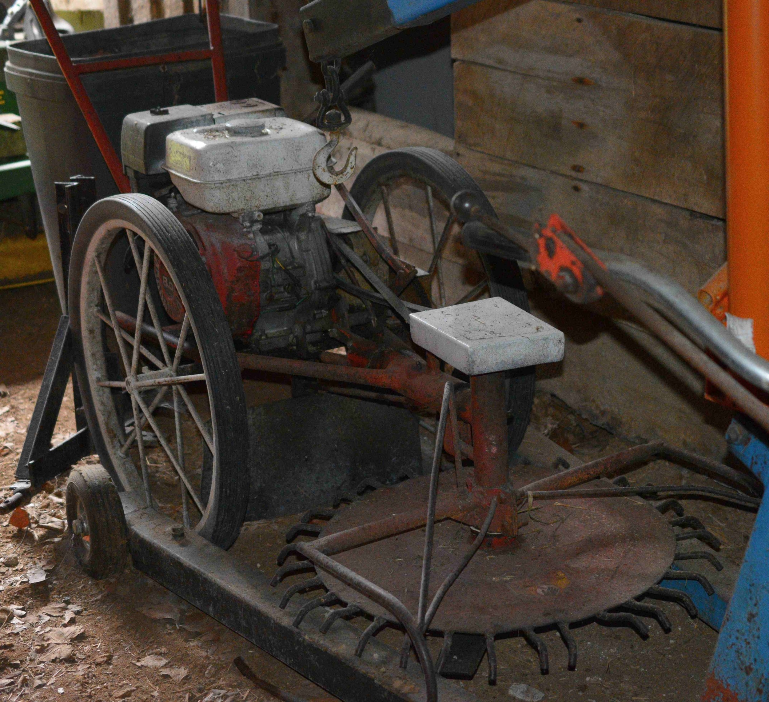

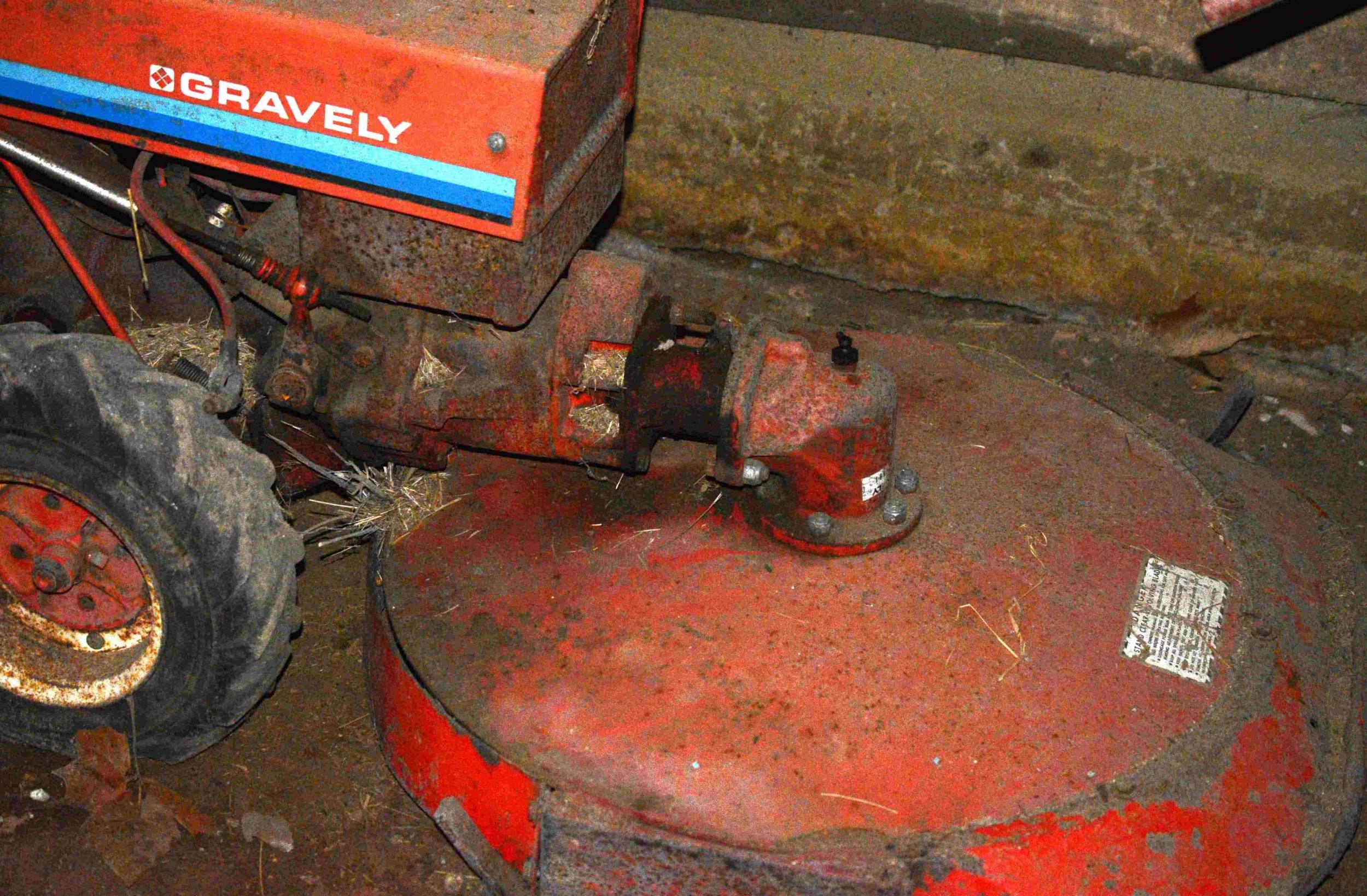

This is my Bachtold and this is my Gravely. If I were to try to cut this pile with either machine, I expect the cutting deck would push itself into the pile at cutting deck level until the brush pushed against the engine area stopping forward progress. Then I'd expect the pile to be severed from the ground, but still suspended above it in a tangled mess.
I could reverse out of the pile with the Gravely F/R lever, but would have to drag the Bachtold backwards. If there were even a way of adding a power reverse to the Bachtold, it would be a significant improvement in being able to work the pile down to shreds.
But is it even realistic to hope that even a tracked flail mower would be able to knock this pile down and then shred it?
For that matter, although I might have hopes of being able to lift the brush cutter on the PT425 enough to drop it down on this pile, I'm not so sure lifting the cutter very high on a slope is a good idea.

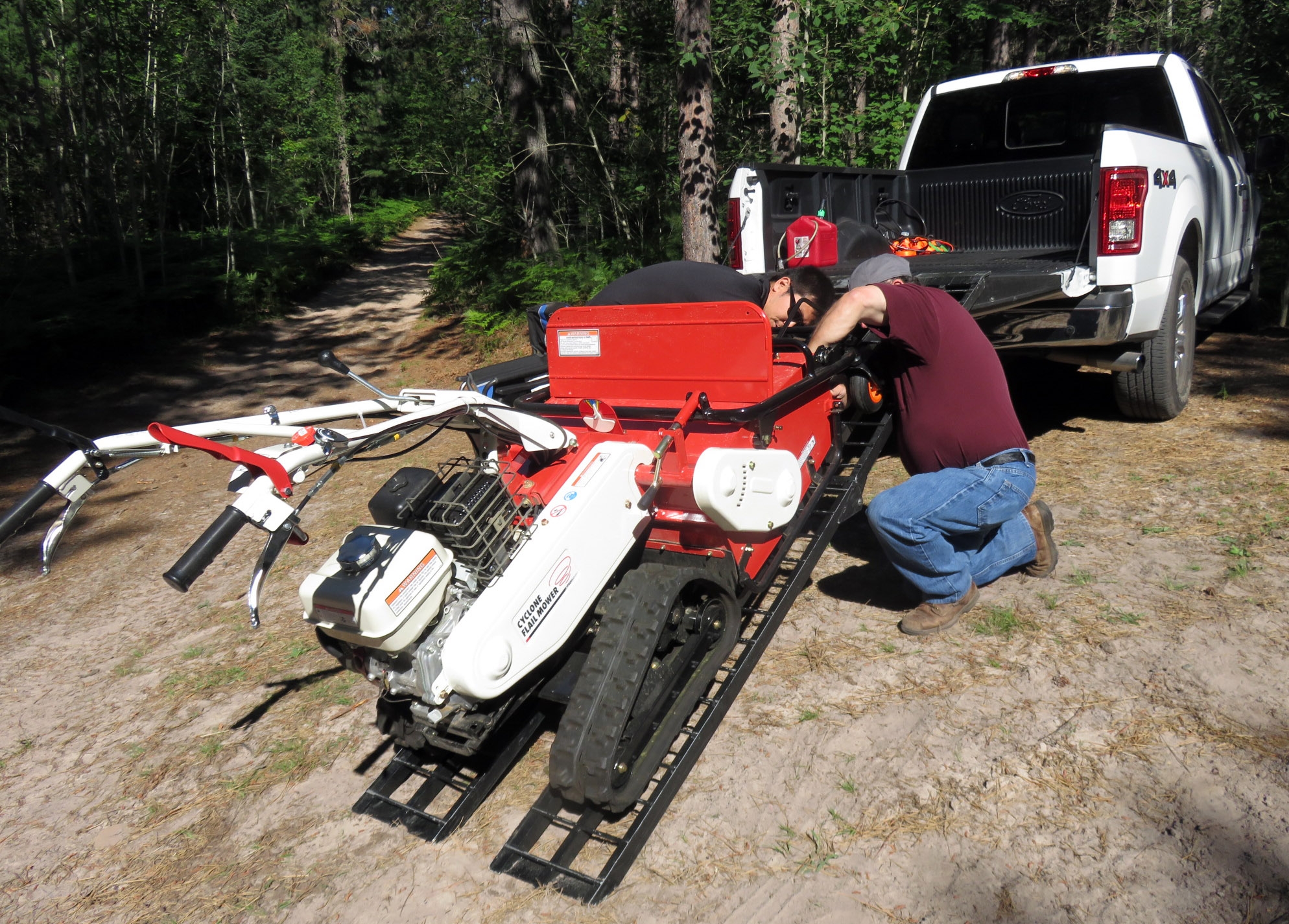

That Orec Cyclone is the one I am interested in. I think they paint them green today. What was your experience?
   / Orec tracked flail vs Grillo wheeled flail vs ride on #6

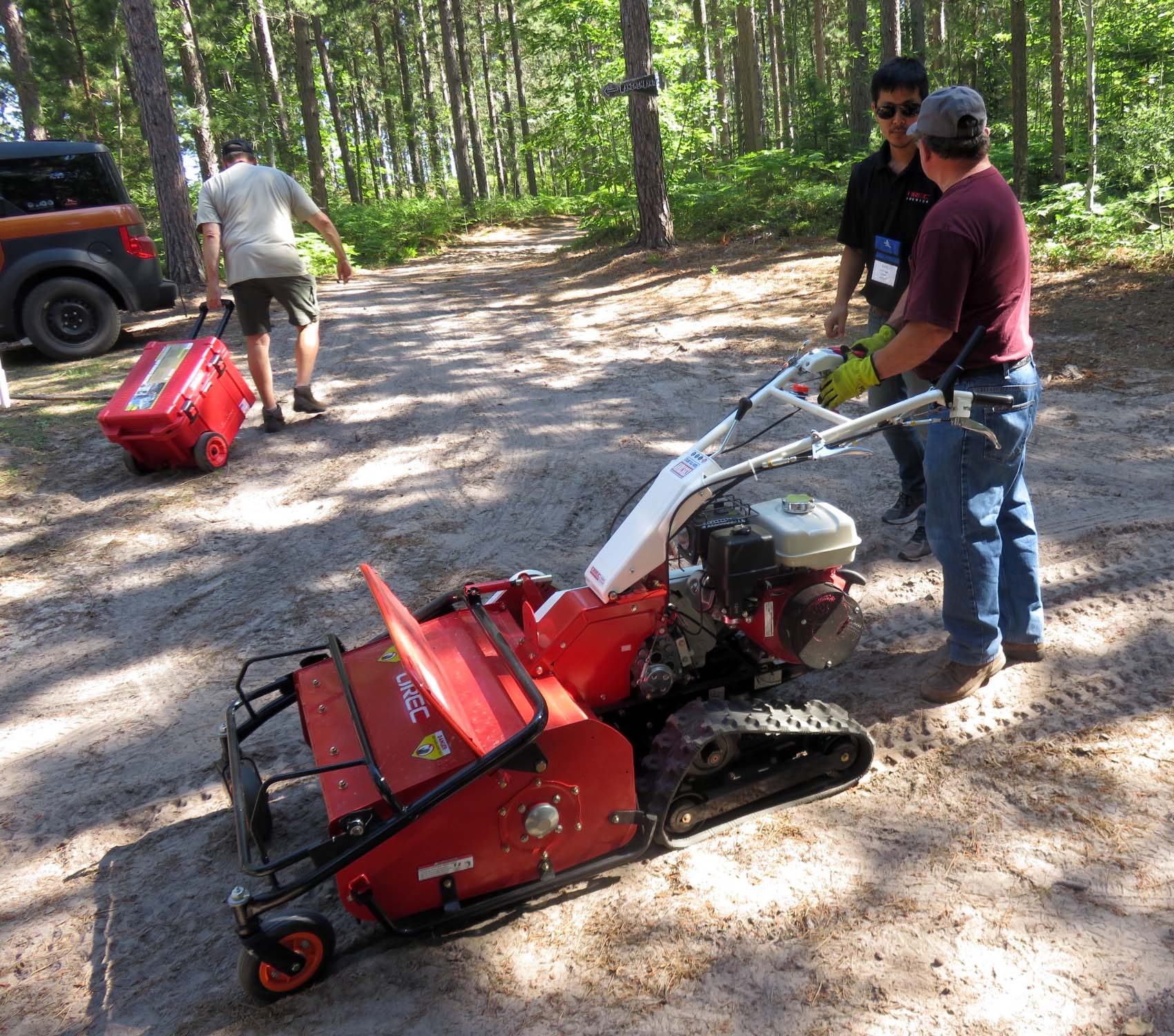

I'd buy one if we needed it for our trails. They make machines for real work and there roots is in the small ag fields in Japan.. At the demo we attended was a Orec company owner from japan.
   / Orec tracked flail vs Grillo wheeled flail vs ride on #7
The Asian looking fellow in this photo family is Orec. Any other machine manufacture owners attend demo days? :unsure:

"If it can push it over, it can cut it." That's the question I have.
My experience so far is the walk behinds I've tried so far can't really push over these kinds of briar thickets like I posted in #3 or climb over them. They can run into them and nibble at them by going back and forth repeatedly. The tires on mine will spin before they can climb up very far onto this kind of thicket.
I'm interested whether a flail would cut differently than a rotary brush cutter on a walk behind, e.,g whether the flail can actually eat away at the thicket and /or whether the track drive will enable it to ride up over the thicket and grind it up.
A 6' rotary cutter behind a tractor has the advantage of all the tractor being able to ride over the thicket and the weight of the cutter compacting the material to the point where the blades can grind it up. So far, I am not finding that to be the case with either of my walk behinds I suspect because they don't have the mass relative to the size of the briar thicket.
