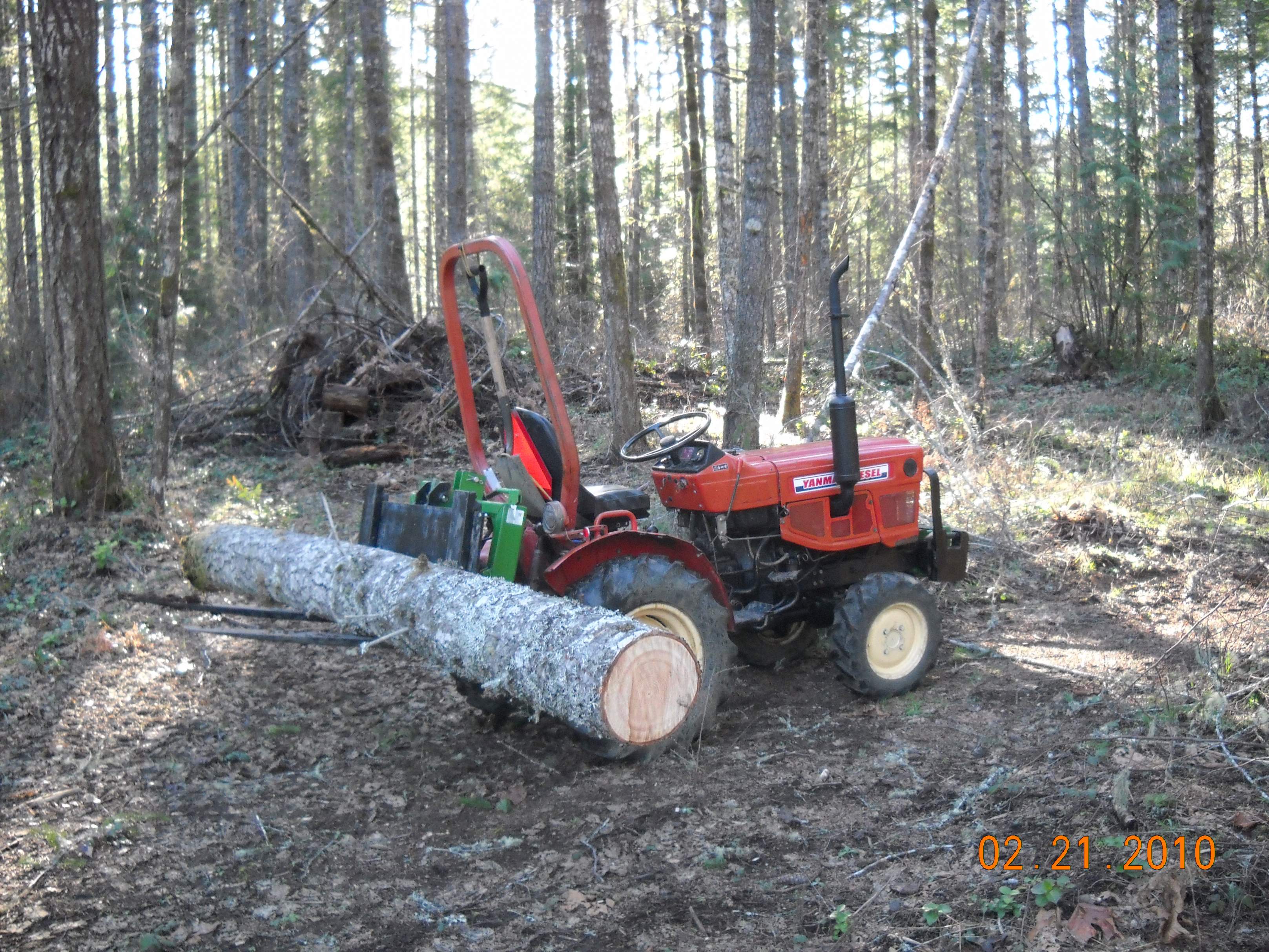

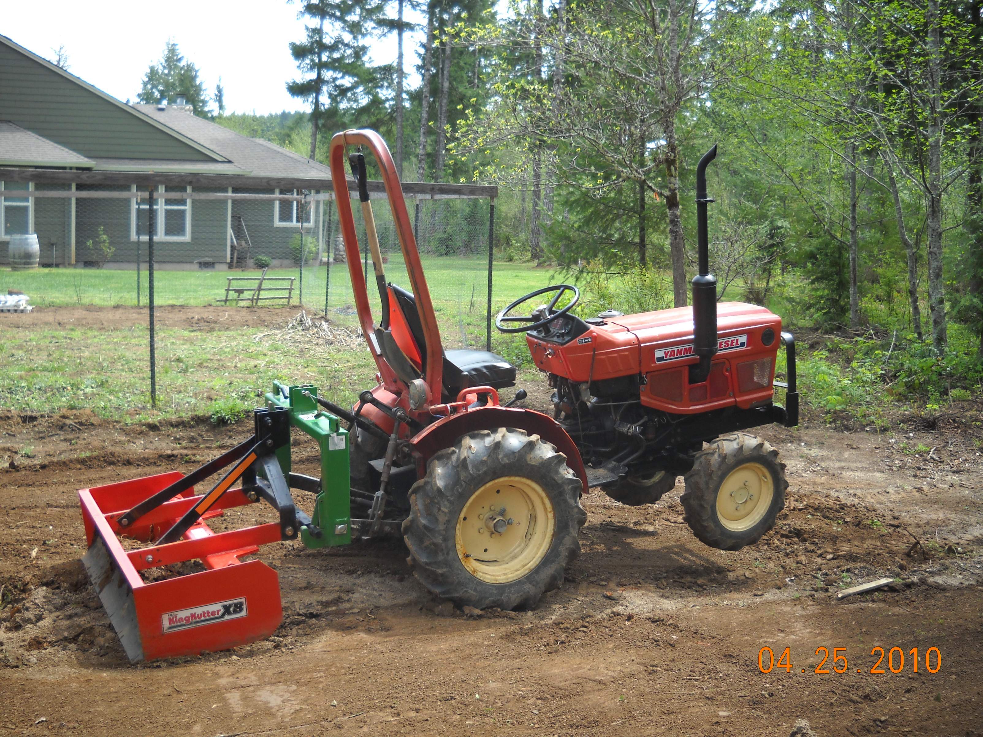

I am not sure they did on the 169D, the 3 point hitch can lift the front end right off the ground without weights out front.
Yep. This turns out to be exactly one of the ways to pump up a rating that I was speaking of. Obviously it doesn't do any good to lift the front. And so traditionally manufacturers had set their pressure cutout to prevent that from happening. The other way that the specs at that time were misleading was that the lift point was calculated at a different location than where the mass of the implement was located.

Here are a couple examples of it's lift power. I had to add 200 pounds of weight to the front in order to lift the log with my pallet forks. The photo with the box blade demonstrates lift without front ballast. :confused2:
I have a box blade too; but with a FEL for counter balance; notice; the more weight you (one) puts the further out the more unstable or more counter weight needed. The 3 pt hitch attached to your box blade is out further than most; so more counter balance will be needed ...
