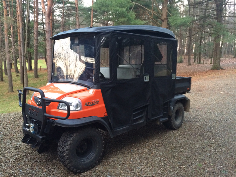

I am going to use my RTV for snow removal this year and wanted some protection. I've done a bit of research and found that there are a few soft cabs in the $600-1000 range that use zippered doors. On the high end, you can get a full hard Curtis cab for about $5500. In the "middle", at $1650, OTC offers a soft cab with actual hinged latched doors. My Kubota dealer happened to have one for sale from a demo unit, so I bought the OTC cab, used, from them. We just put it on this weekend and I thought I'd share some pictures. I have some initial thoughts on this which I'll share a little later...

The main problem I had with mine was water pooling on the soft top and water running in between the roof and door tops. See photo for why this was a problem before. I solved this (95% of it, anyway) by putting the OEM Kubota plastic top over top of the OTC soft top (had to punch holes for U-bolts). The plastic roof channels all the water away from the doors.

   / Original Tractor Cab Kubota RTV1140
With Kubota OEM plastic roof installed.

   / Original Tractor Cab Kubota RTV1140 #7
