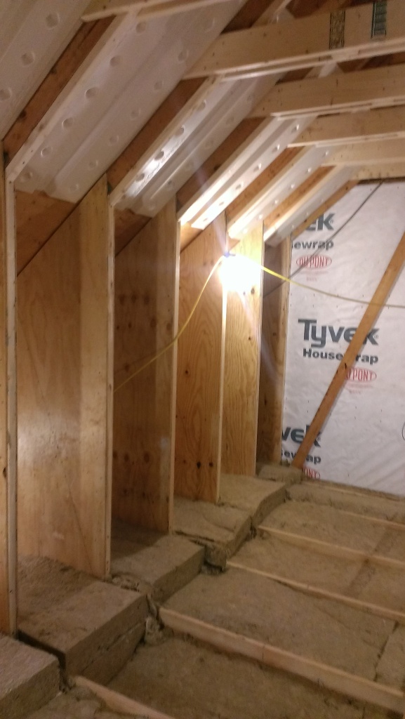

Earlier this year, I modified the trusses on one of the gable roofs over my house.
The engineer was very specific about the material, nailing pattern and glue to be used on the gussets that were scabbed on to the reinforced webs... 1/2" plywood. He stamped the drawing. Good enough for me. :thumbsup:
