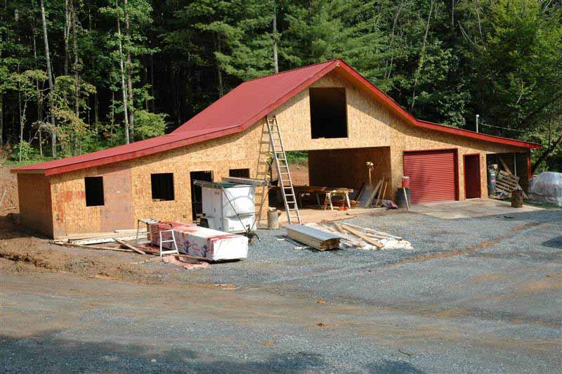

We have made some good progress in the last two weeks. Monday we start adding the log siding. The week after that will do the rock waynes coating. For now all the rough electric is in and main service panel has been switched to 200amp box.

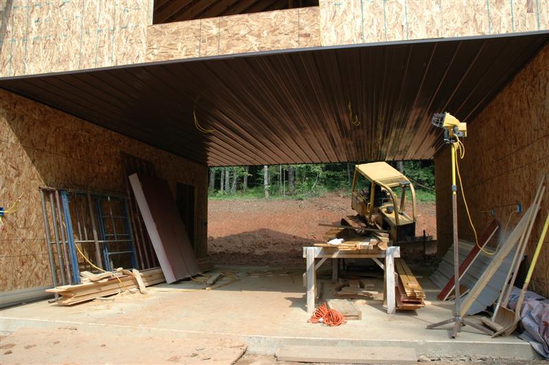

This show show the breeze way ceiling. We had the roof metal supplier run the metal with the color on the bottom. (Brown) Then you screw it to the ceiling and it hides all the beams. This get rid of all the places for bees and spiders.
