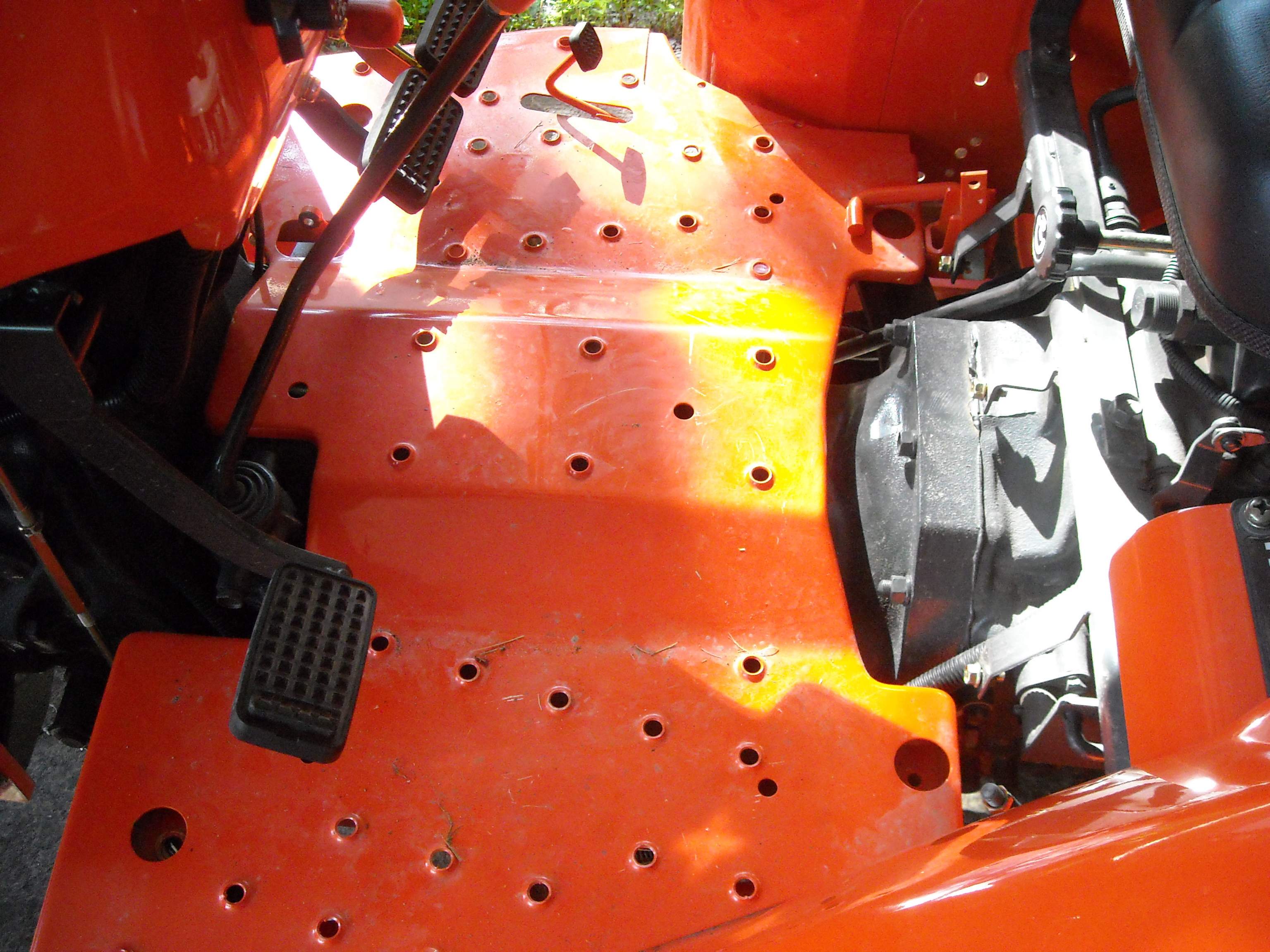

I bought a Herculiner bed liner kit, to redo my short bed. there were some gouges, and scrapes right down to bare metal. I got an excellent deal at the parts store $69.00 for the kit. I had just taken delivery of a New Kubota L4400, FEL,Backhoe,Grapple, and I thought I would use the bed liner material to coat the operators floor, on the tractor, and the Back hoe.
/ other uses for roll on bed liner
#2
So,I started the bed liner project this weekend, and it was a little more work than I thought it would be, The instructions call for a lot of prep work. I took off the panels on the tractor that I could, and loosened any the I could not. I washed everything with TSP, sanded, and scuffed, all glossy areas, and wiped everything down with Xylol. My daughter helped with scuffing and sanding, which was a big help. I have included some before pics, and some pics of the kit. At the same time, I was prepping the bed of my truck. That was not to bad, since it was a re coat, and I just had to prep the bare metal spots, and wash the bed.

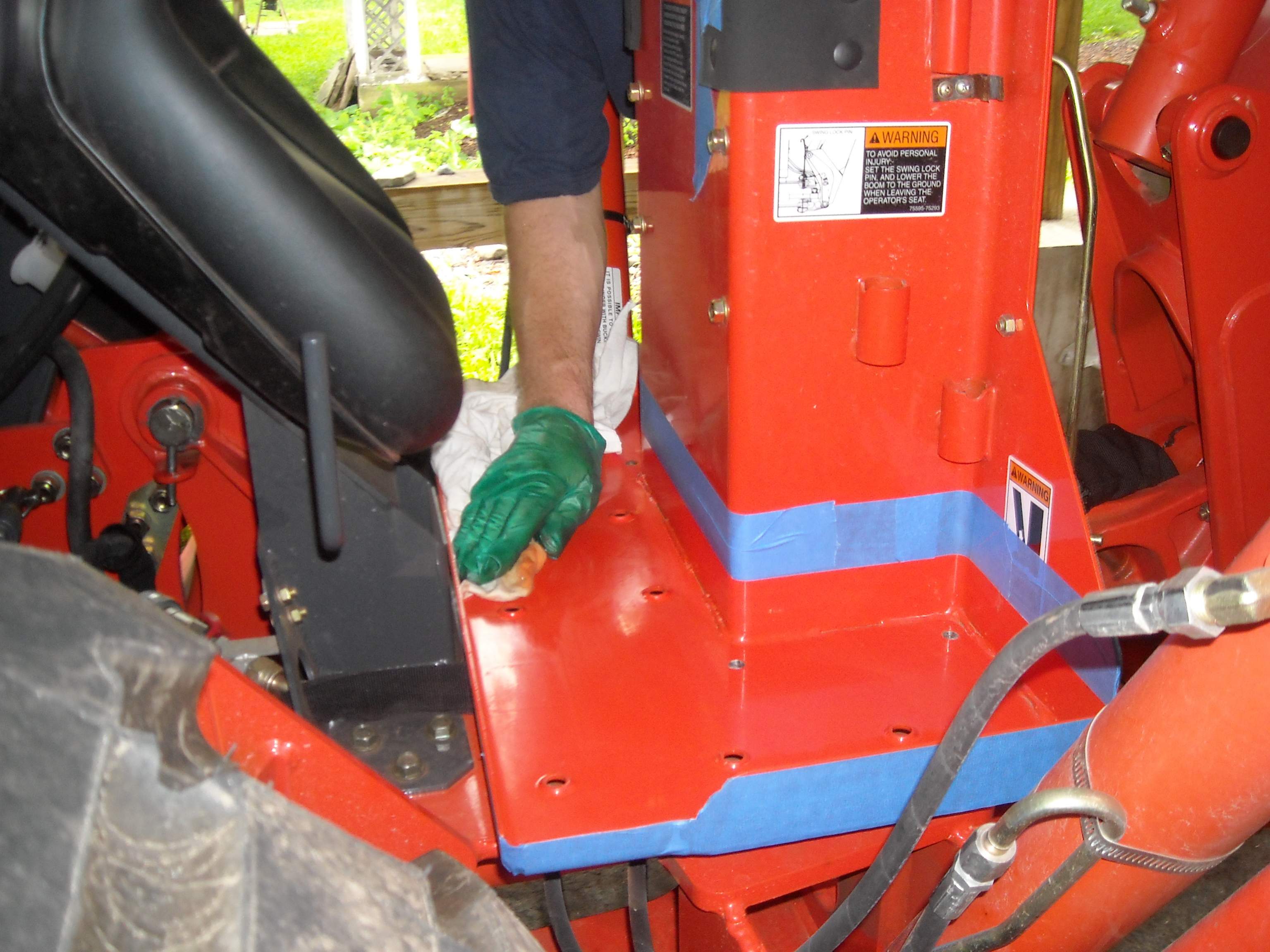

after the prep work, it was time to mask off all the areas I wanted to coat. I had taken all the bolts,and nuts off that were in the way, and that I did not want to risk getting stuck forever. I covered the holes, that were threaded, and just started to tape. I have, by this time already made some mistakes, so in the interest of preventing you from making the same, I will mention them now. It goes without saying, that you must make sure that your tape is flat, and tight on the work surface. You want a nice clean line. What is not readily known, is that when working with this stuff, you need to take off the tape before the material dries. For example you put on the first coat light, it is only a primer coat. Then immediately after you put on the second coat, you remove the the tape. I did not do this, and it gave me some headaches later. Note, the directions clearly tell you to do this. I did not see it, and it was my fault. In my defense, I was counting on putting at least three coats on, and I did. So maybe thats why I missed the instruction. Here are some More pics

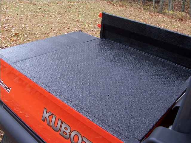

Great idea to use it on the steps of the tractor and the backhoe platform! I used Herculiner on the bed of our Kubota RTV900 and it has worked great. We haul lots of wood and have also hauled gravel as well. It has held up very well given the use it has been given. Here are some pictures right after the Herculiner was dry.

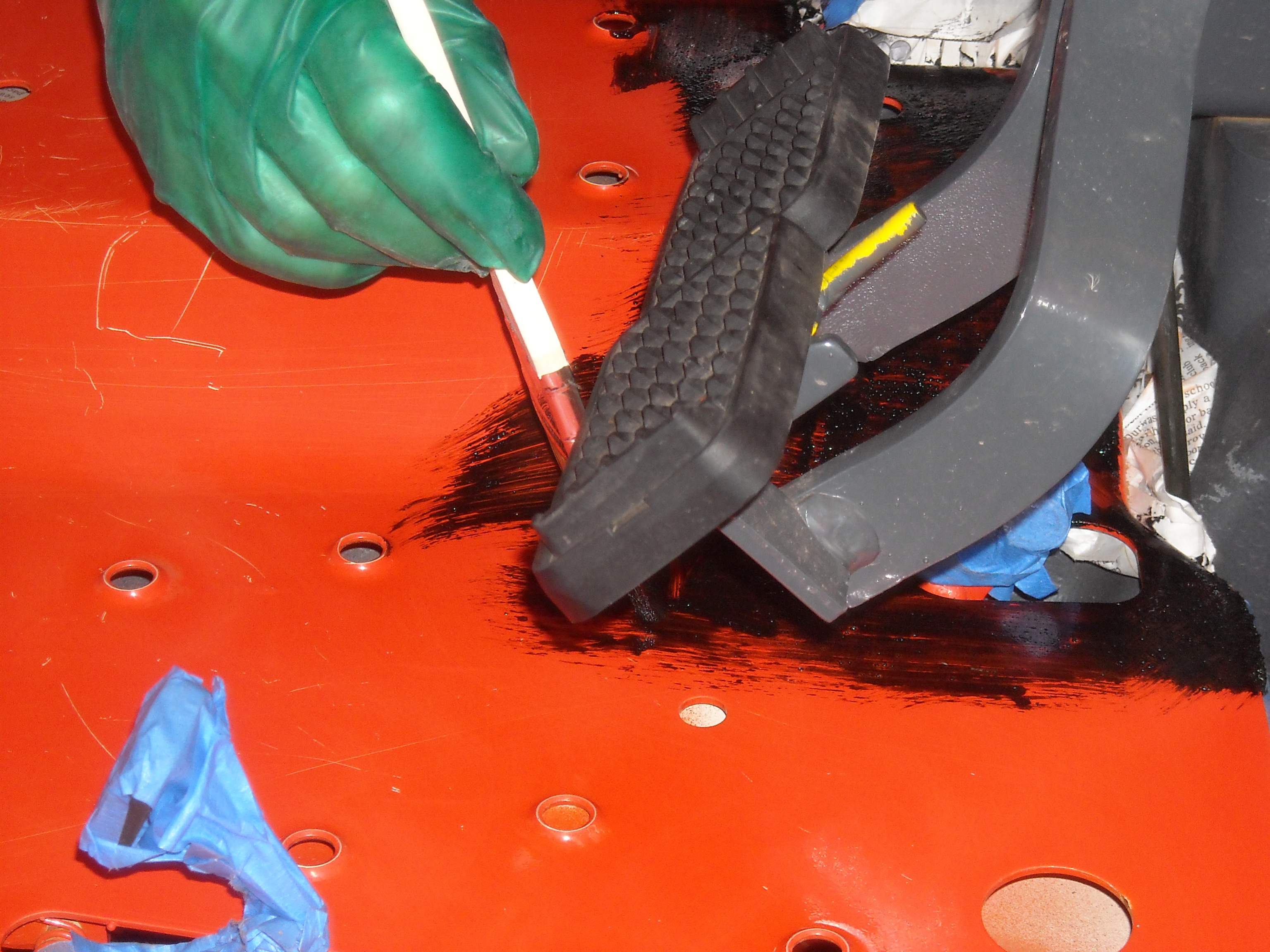

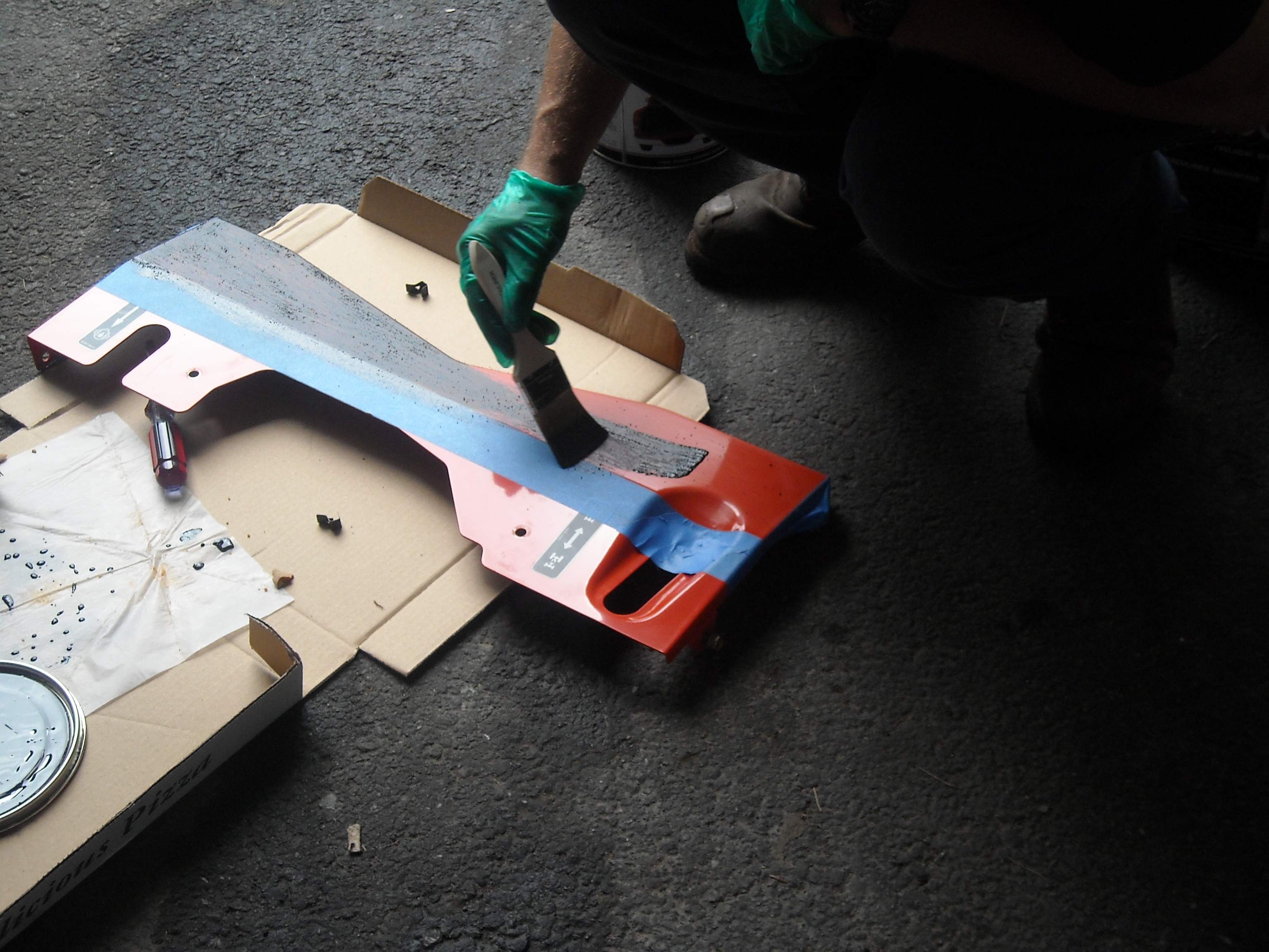

I know this sounds crazy, But I have been saying for a couple of years, that I would like to get my whole truck repainted in this stuff. #1 I hate washing the truck #2 I ain't shy about taking the truck in the woods, and # 3 It would look bad a%#. Here are some more pics, of the panels I did on the tractor. It is A Kubota L4400 I have had it a week, and only have 3 hours on it. My wife was ready to kill me when she saw me taking parts off, and painting the floor. The directions say to brush on a lite coat first, and to get all the seams real well.

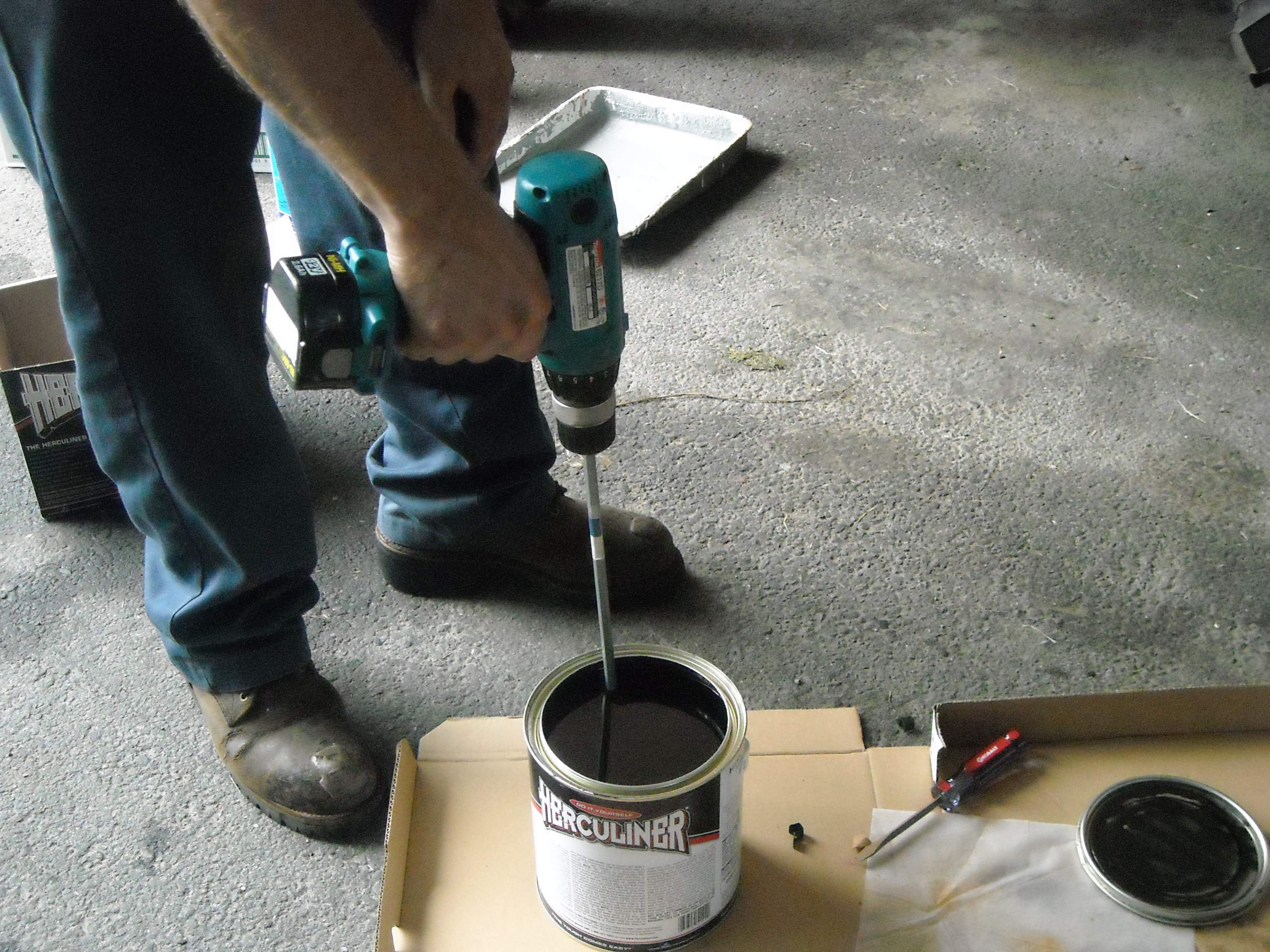

Well here is the finished project. It came out pretty good. I made a few mistakes, but the next time I do this,it will be easier. The instructions tell you to prep the surface with xylol. It can also be used to thin out the material, and remove drips, and runs.
