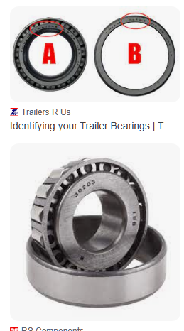

That's ridiculous, the bearing and race number should be on the outer face of each part like in the attached pic. If not, either take the old parts with you to a bearing shop or take the sizes, the manufacturers don't make their own bearings. I've got no use for companies that gouge like that.

Yeah, I'm on this one. One down side, the bearing I actually NEED is missing the portion that would have those numbers stamped on it. All I have is the inner portion that help support the bearings.

Richard, check your other wheels, and remove the most floppy one. Take it apart to get the proper numbers you require. You might want to check them all, especially if you can find a supplier that sells them reasonably.
   / Ouch, anyone able to explain the cost difference? #9
As was said, check the other side, chances are if they're all the same age that it could be on the way out also and it'll give you a chance to get the numbers. If you can't get the numbers you can measure it. 10 to 1 you'll find it's a standard size trailer wheel bearing.

Just took it off and looks like I can get the big one (seems to be ok but I'll probably replace everything) for under $50 and this small one, the one that blew up, for $10-20 depending on vendor.
