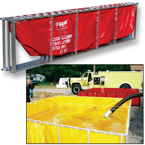

Tanks, would a fold-a-tank work for what you need? Fill it during fire season or when needed? Cheap, lightweight and can be used by the FD easily. Portable Collapsible Fol-Da-Tank | Water Supplies | Dump Tanks |

3. Tanks, would a fold-a-tank work for what you need? Fill it during fire season or when needed?

3. I like the folding tanks but they are just as spendy (or more) as a permanent tank. I found one on ebay last week. At $650 for 3000 gal still too much for me right now.
