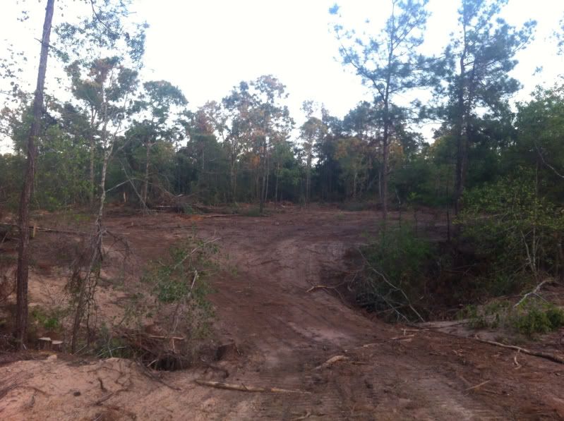

This is finally happening! After lots of headaches and emails we have actually made progress in building our home. We started back in Oct '12. We bought 12.86 acres in gods country. I had my wife on board with moving to the country and raise our son and wanting to get away from all the headaches of town.
I started by getting a survey crew out to help locate the pins. We were able to find all but one! That elusive one could have been found for a hefty price due to the amount of chopping needed. I figured, it'll be ok. I'll find it...more in that later.
I knew I wanted to leave a buffer for the privacy and also keep the dust down. It's still 5 years till the road gets paved so to make the best of it we left about 60' along the roads. I drug a Dozer out dec 22 2012 and officially started clearing. This was slow going for me by myself. I was able to underbrush and burn off a couple acres before having to do some figuring. Here's the beginning. It was pretty thick.
We have a creek that runs right down the middle and it's decent sized. I was able to track down a big culvert to aid in accessing the back of the property. Here's the culvert installed temporarily.

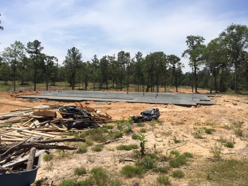

We finally have our slab! They will begin framing on Tuesday!

Congratulations, it's a huge step when you get your slab poured!!!!
Pouring the porches at the same time as the slab might lead to some issues down the road. Concrete expands and contracts with the change in temperatures, and since the inside of the house is usually pretty constant, and the outside porches change so much, the porches are usually poured at a later date then the slab. Some places even do the garage separately. Do you have expansion boards between the porches and the house slab? If not, be sure to cut the concrete there so you don't end up with cracking into the house.

No expansion boards placed. It's structural and has full beams and full thickness concrete. Hopefully we don't have any issues. Never even thought of that so thanks for the heads up. I'll ask builder tomorrow. Any other tricks or tips?

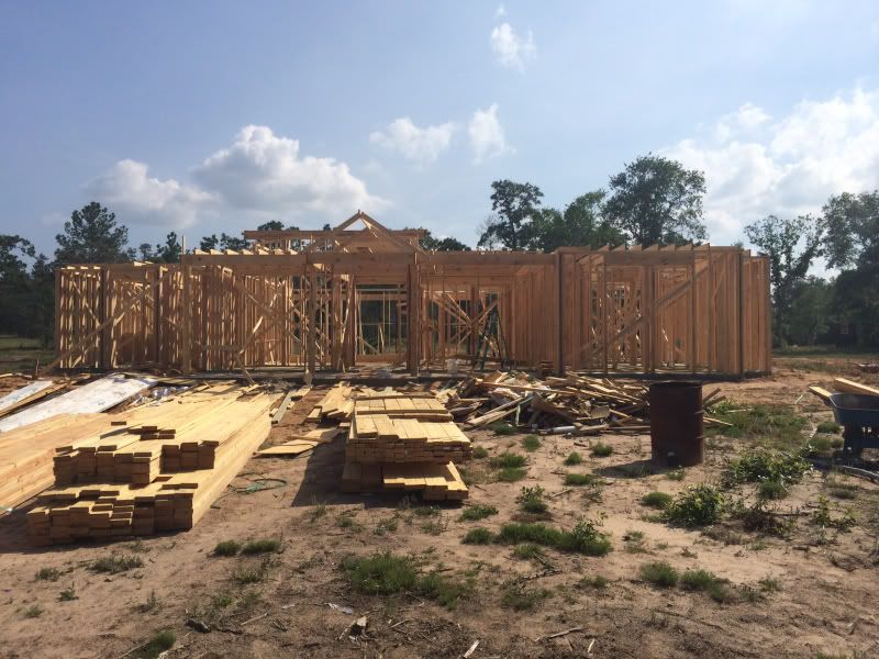

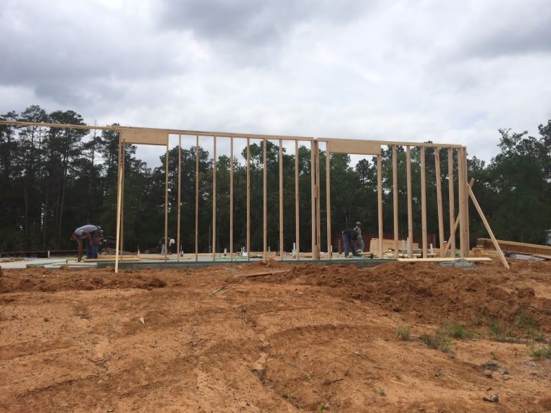

Started getting walls up today. Builder said it will be more than two but hopefully less than three weeks of framing!
Brett
   / Our Home In The Woods!

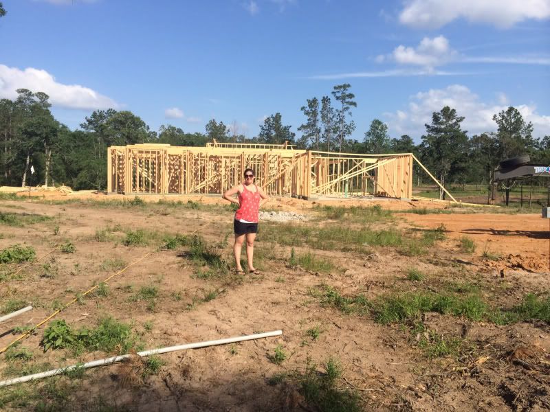

They have been making progress!
Front of the house is taking shape.
Garage side. The garage is getting a beam so the sagging boards are only temporary.
One weeks down, hopefully they will be wrapped up in a week and a half or so. Been 4 guys going at it lately.
