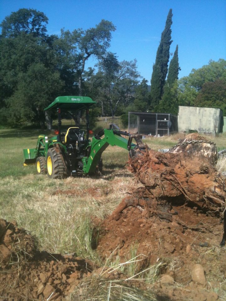

Stump 2 has been safely removed. I find that like the controls on the tower truck at the fire department, moving over and down controls at the same time slows the action of both motions.
Getting better!
