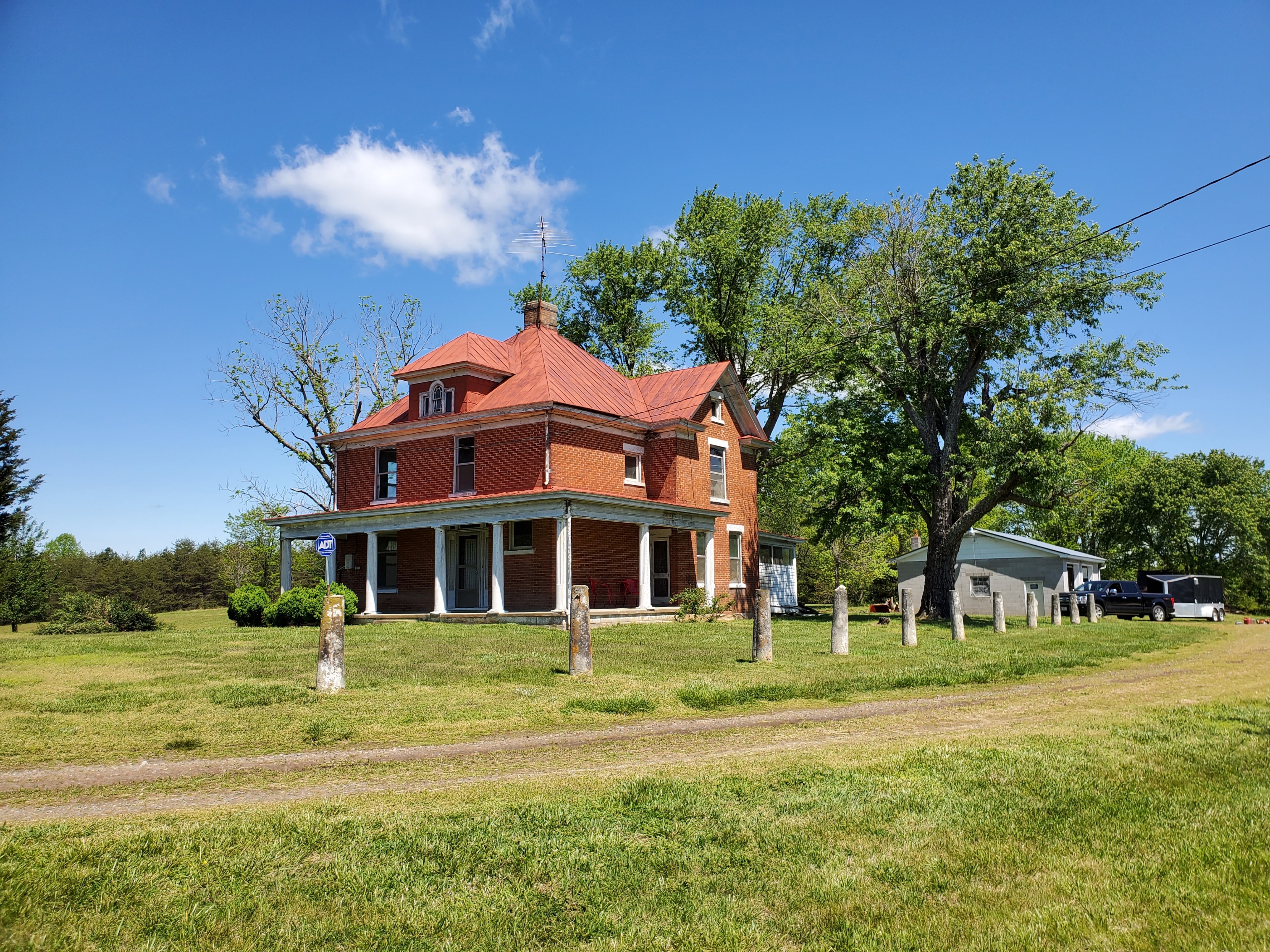

welcome to this forum, wise to post here...interesting project, where are you located, & what type of work will you be doing to the place? posting pics is a must on the forum :) best regards, & good luck, looks like you're safety conscious for good reason
   / Out of the norm question #10
This is crazy; I was telling my wife just last night I need a manlift for our farm house project to do it right. Do you have a picture of your rig?
