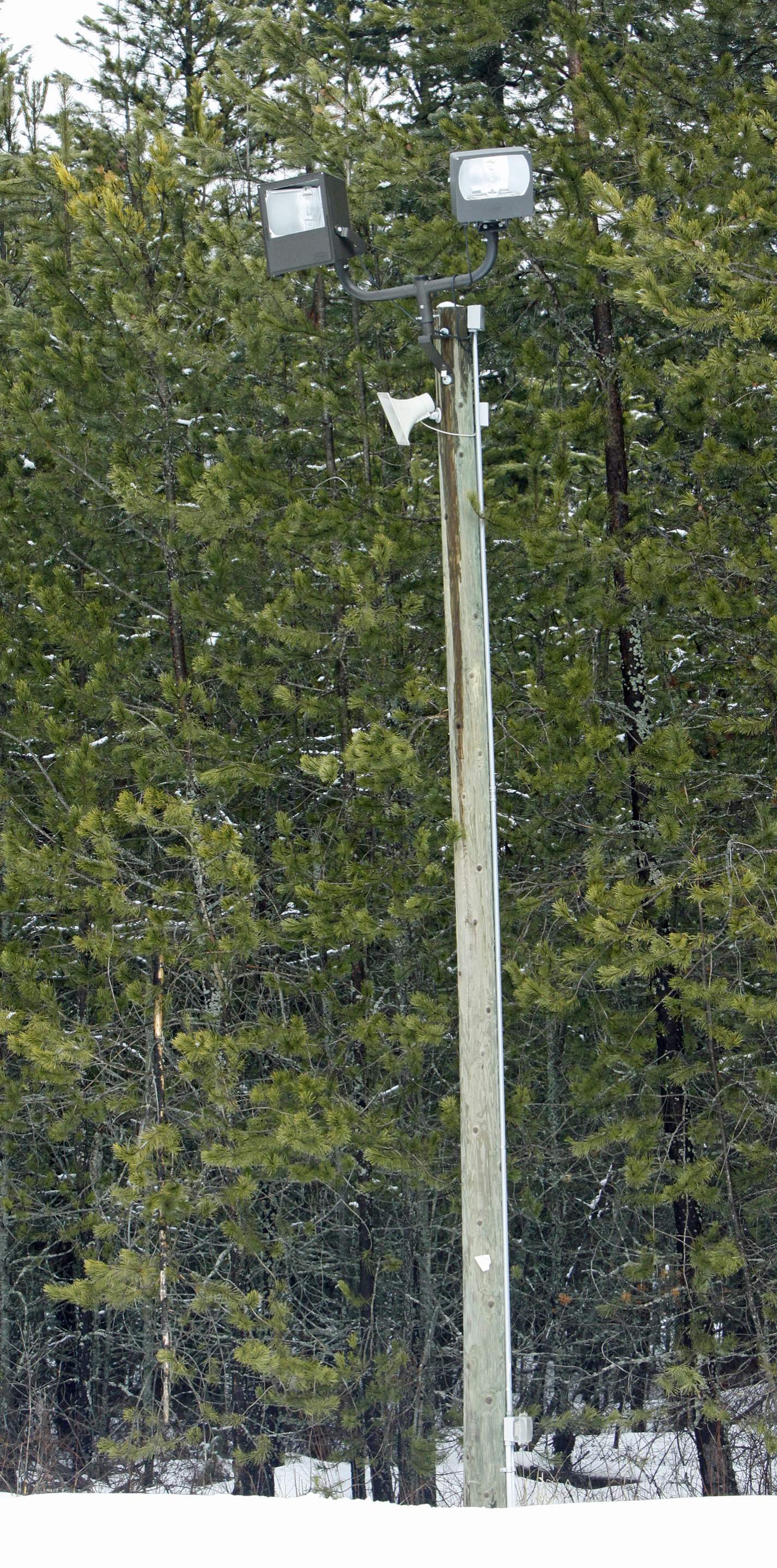

on my arena i put 28 foot utility poles (treated round poles) set 5 foot into the ground. I installed Lithonia 1000 watt metal halide lights towards the center and 250 watt metal halide lights to the side. on my arena i have 4 of the 1000 watt and 4 of the 250 watt lamps, all wired to 240 volts. I ran them to a lighting contactor so i could control all 8 lights with a single switch.
on a 150 x 300 you would probibly be better off with 6 light standards, using the 1000 watt lamps on the center set of poles and you can use a combination on the others. it all depends on how light you want it to be. ours is plenty bright, but were only spanning an 80-90 foot width. it does tend to be alittle brighter towards the center than the edges.
we pay $0.06/kwh for elect here, so when the arena is lit, were using 5000 watts, or $0.30 per hour that the arena is lit. the wife will use it a few hours a night, maybe 2 days a week, so it doesnt amount to much power usage.
The metal halide lighting is the most efficient for arena lighting (outdoor arena). they do tend to loose some of their brightness over time, but i dont use mine too often, there 4 years old and still as bright as when new. when they get too dim, simply replace lamp. Metal halide lights are the bright white lights used in parking lots.
i can take some pictures of the bracketing used to install the lights tomorrow and post them.

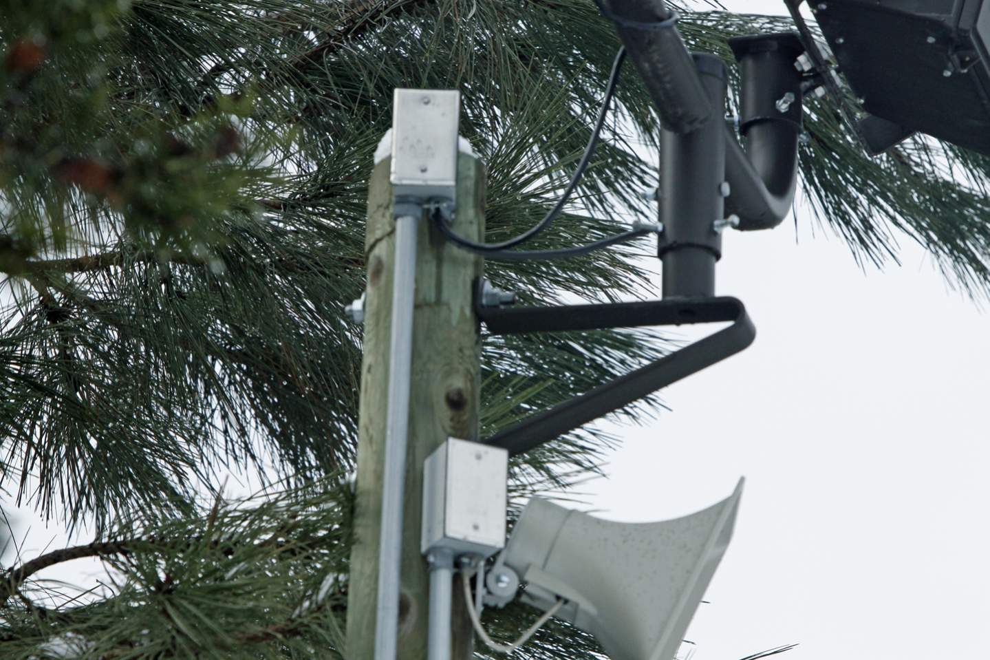

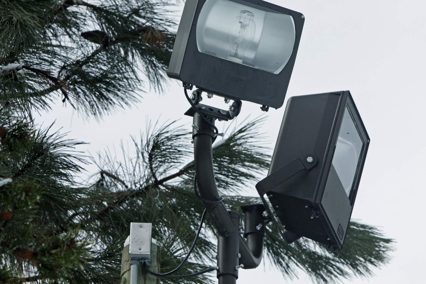

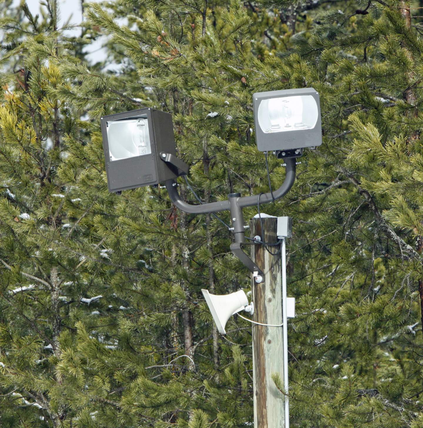

   / Outdoor Arena Construction #27
ok...i went to get some pics of the lights today, but its real cloudy out here. hope that these come out ok.
you can buy the brackets at any electrical wholesaler shop. there made by many different companies. i purchased the pole mounting kit, then added the dual swivel arm, then added the actual light mount base unit . all 3 pieces fit together with bolts, and install very easily. all parts are powder coated. The main bracket is bolted through the wood pole.
i was cautioned not to use more than 2 lights per pole, due to the weight and forces of the wind. if i used alum poles, i could add a lot more lights, but just price out an aluminum light pole, and you'll see why i opted not to use them.
i added a sound system so my horses can get used to the sounds and screeching of PA systems. makes them easier to handle in the show ring. I watch other horses go bonkers, while mine keep their heads.
my power source is only about 40 feet from the 1st pole, so i got by with #10 copper wire runs.:laughing::):D
