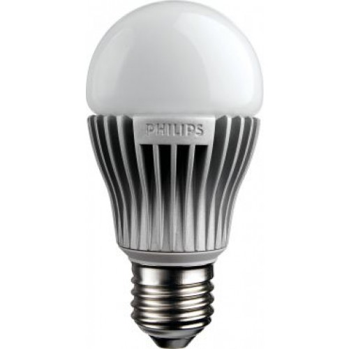

Ive been using a Phillips 8W LED For about 3 years now. Dusk to dawn every day. Keeps on ticking and doesnt attract bugs as a nice bonus! However it wasnt the cheapest LED on the shelf at over $30 when I bought it. Like a lot of things, you get what you pay for. Will it last 10 more years? Ill update this thread 10 years from now and let you know;)
