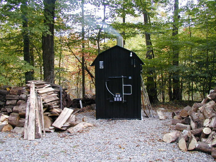

   / Outdoor Furnace #12
Steve: I have a Central Boiler CL40 woodstove. I heat my house, hot water heater and a small machine shop. The wood that I use to heat my house is mostly dead wood that I get from my 10 acres of hardwoods. The nice thing about a outside wood stove is that you never have to split wood again. I use green wood, wet wood & dead roten wood just about anything. If you get a real big tree just cut them shorter so you can lift them. I spend about 4 days of hard work to get enough wood for the winter. I get my wife to drive my JD 4700 while I put the wood in the bucket and she dumps it off at the wood stove. Some people go to the health club but I go to the woods. Free work out. I save about $1000 a year in my heating cost.
The stove does smoke when it kicks in from the down mode, but only for a short time. Not a problem if you live in the country but might bother your neighbors in town. I burn mine in the summer time and if the windows are open once and a while I can smell smoke. In the summer 3 or 4 pieces of wood will last 3 or more days. Just for heating my hot water heater.
Central Boiler has a 10 year warranty, but they told me they haven't had one fail in 25 years. When I bought my stove 3 other people I work with bought a stove too. They all love them. Compared to my heat pump this heat is a more even warm heat.
One guy bought there biggest stove $12,000 he heats his house, water heater, 48x60 pole barn and his driveway. He owens a tree cutting service.
Dan

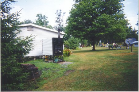

   / Outdoor Furnace #13
I own a Taylor WaterStove (e.g. outdoor wood-burning furnace) at our second home. The wood burner was already installed when we bought the place, so I'm not faced with the same ROI question that you've got. Based on on the reading that I've done, if you've got a reasonable cost for gas, oil, or electric, new wood stoves are hard to cost justify.....
However, just look at what's going on in California these days.... just wait, outrageous electric bills could happen to you too!
More on the upside...... the low operating cost is great, cutting and hauling wood is a great way to stay healthy (I think this is a greatest benefit of all).
Things to think about are prevailing winds (you really don't want the smoke blowing across your back porch all day), keep the wood dry (it makes a huge difference in the efficiency and smoke levels), and you can't leave a wood stove unattended in the winter time (usually).
Since I use my second home on an irregular basis, I've rigged the plumbing so that we can drain the boiler quickly and also pump a 50% pink anti-freeze solution into the interior hot water heating pipes. So far it's worked great!
Good luck!
Henry
   / Outdoor Furnace #14
Here's a picture of our Taylor stove
