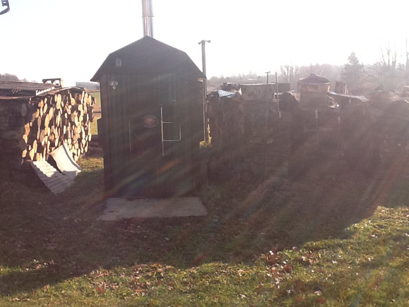

I love my central boiler

I have one and heat two homes. Have had it about 10 years. They do like their wood. That's for sure

You did something wrong in sizing your unit or picking the brand that you did or ? I heat my house, shop and hot water and can easily get a 24 hour burn if I so desire. Before I added the shop, it used about 15 - 20% more wood than an inside wood stove but my house was warmer and it provided the hot water as well. I also liked that there was no mess in the house and I did not have to pay for a new chimney nor worry about a fire in the house.
There is a huge variation in the quality and efficiencies of wood boilers. Family and friends liked mine so much that they asked that I become a dealer so they could get them as well. They have all been extremely happy with their wood boilers. Like any wood burning heating system, if you do not enjoy cutting your own firewood, they make less sense.
