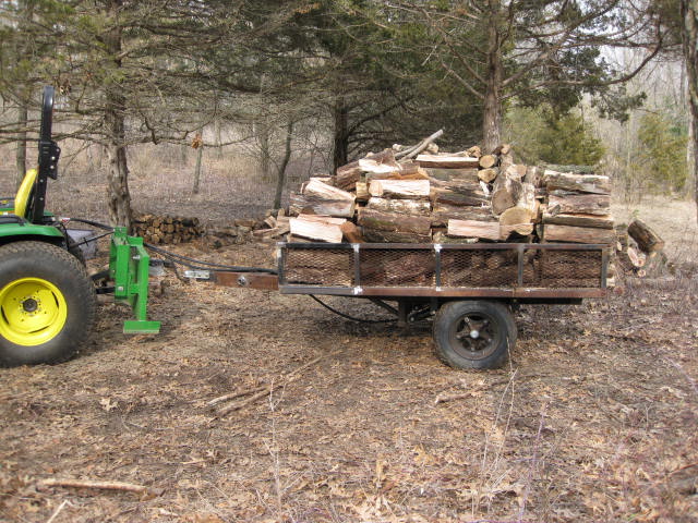

I tried that route one winter, 3'x 10-18'' dia. didn't like it. My boiler is smaller a CL-40 so the opening might be smaller, harder to handle the bigger pieces in the opening I think. I now cut at 18'' and split everything down to 6'' dia. It dries better in less time, I have a 1 year rotation. So now I can get 2 rows deep in the fire box and tightly packed, I fill it about every 4 days (average). The house is 2000sq ft and I have no idea how much wood I burn per year :eek: and I get LP about every 4 years. This is my current wood hauler.
