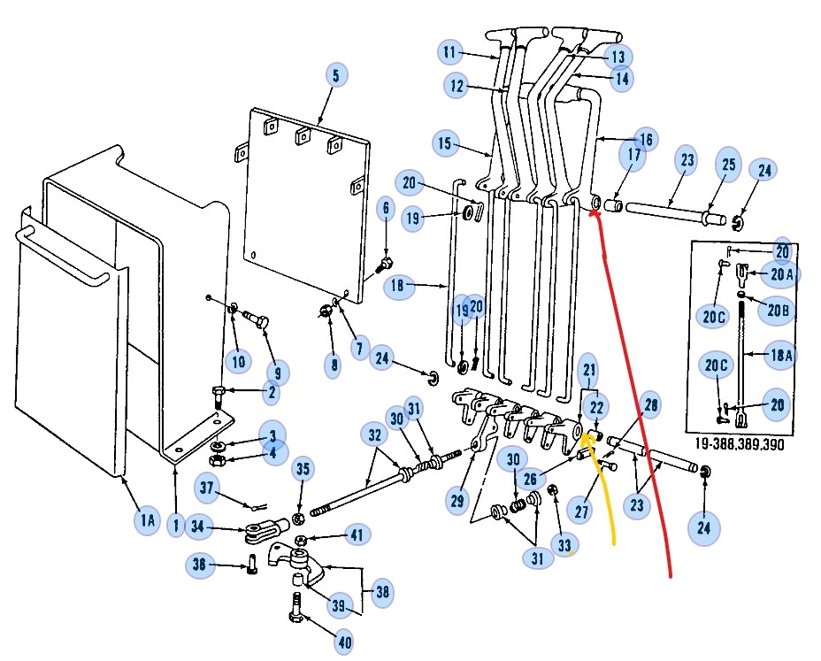

I’m working on my Ford 4500 industrial just got hose replaced from backhoe to manifold cost a lot more than I was quoted but I got screwed. It is what it is anyway my outrigger levers seem to be sticking together. I can’t get them to work independently it’s very difficult. What is the repair for this?

Sticking together? So if you operate the right stabilizer, the left will move too?
The levers are located on opposite sides of the controls and the valve. Just trying to figure out how this is happening.
   / Outrigger levers Ford 4500 industrial stuck together
Yes, they’re on opposite sides. I don’t know how it’s happening. They’ve always been kind of sticky. I will send a picture later.
   / Outrigger levers Ford 4500 industrial stuck together #4
Being that the controls operate on a pivot rod and the bellcranks for the controls operate on another rod, I would look at the pivots for the stablizer controls at those two places. Look for the control and bellcrank pivoting on the shaft rather than the shaft pivoting with the movement of the controls.

Look at the picture. Top and bottom pivots
Thank you I will look at that. What do you think? Makes it jam up where both of them move with one lever or the other and they don’t move independently I will look at the top and bottom and see if I can see. Why it is happening. do you think it’s a matter of lubrication or mechanically jammed thanks again. You seem to be the only one answering me. I appreciate it.
   / Outrigger levers Ford 4500 industrial stuck together #9
That is the only thing I can think of that would cause both stabilizers to work together. The bushings in those pivots are nylon-type, but it is possible that the bushing is gone and things are binding. Lubrication will help.
