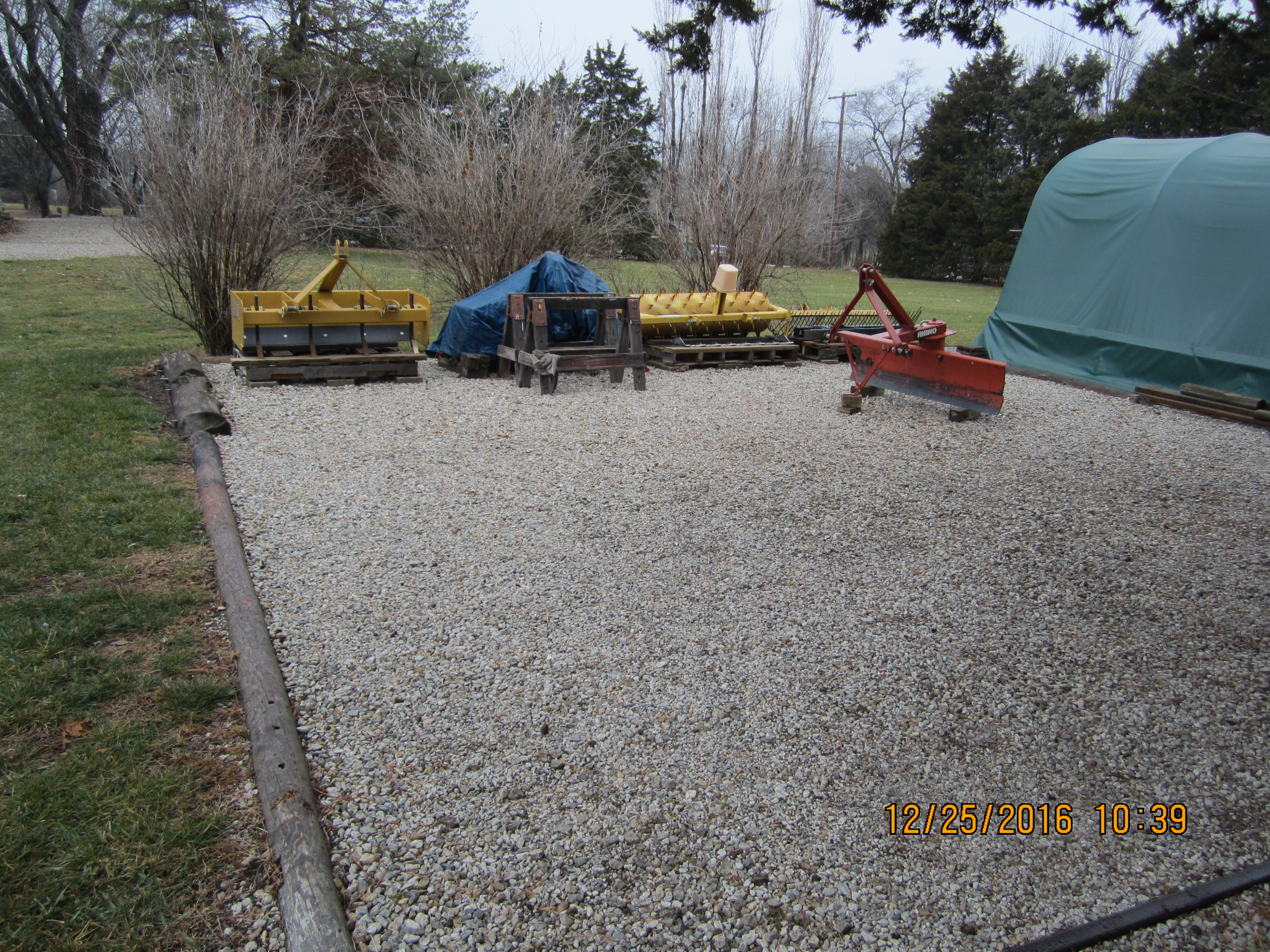

I store all attachments outside and only cover the tiller with a canvas tarp. All are stored on wooden pallets however over a gravel base. There is some fading of the paint jobs, but it doesn't affect their utility. The rusty working/digging parts shine right up when put to work. I spray the mold board plow and the potato plow with Fluid Film which helps a bit, but probably doesn't make much difference anyway. Two tractors are stored in a ShelterLogic unit...and the other is either in the garage or covered with a tarp outdoors. Been doing this for about 10 years.
Cheers,
Mike
P.S. That is a cheap blue plastic cover over a canvas tarp covering the tiller which is also sprayed with Fluid Film.
