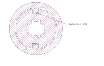

Somewhere along the way, I bought a NH 1925 this year, after reading all the great information here, I found a reference where I should be running an over running coupler / clutch when using a bush hog to prevent back driving of my HST xmsn. (relevant post on the NH board) I asked several folks, the dealer I bought my tractor from and the NH dealer if I could just leave the ORC on when using my other PTO driven equipment and everyone said, all it would effect was driveline length and if the implement was spinning faster than the PTO.
I then bought the only type I had seen that pinned on.
So, after crawling around in the rain and in the dark installing this thing which while it sounds very straightforward and easy, caused much cussing and greif before I got it all lined up and finished off so the wife could use it the next morning.
Bush hog stuff went fine, then had to switch over and dig / drill some holes. Had been using the PHD no problem in the past.
The PHD would spin and start to dig, then it would stop, Thinking I had sheared a pin I lifted it and it started spinning again, up, down, up down, yep, you get the picture, the village idiot drilling holes. Pull the pin, (bolt actually) and look at it, scratch my head, wonder what is wrong, realize that I have added the ORC, oh it must be defective. Of course I do not have the tools with me to change it. Home we go, this job not getting done today. Get another ORC from my dealer explaining that this one is bad / defective and will not drive my PHD. Dealer agrees, sureley something must be wrong.
Install new one, test in yard, same results, then take the new one apart to see how it works, maybe it is backwards, spend an hour drawing circles in the air and looking at the rotation of my PTO trying to figure out if the darn thing is backwards or not. Go to rural King with snap ring pliers and dissasemble one of theirs and see if it is the same??? Go to TSC and do the same. Wander around on the web till I stumble in to the QD ones and realize that this is probably done becuase they do not work for driving all implements, if they did, why bother with a QD?
Go to my dealer, who thinks I am nuts and disassemble his, and another on the shelf from a different vendor, they are all the same.
Finally buy the QD one and mount it on the bush hog where I leave it because that is where I need it.
Soooooooooo, That is why I suggest buying the QD over running clutch.
And it never came close to shearing the shear bolt on the post hole digger when we were using it. And we probably shear 2 to 6 of them a day when we are using it heavy for planting.

I agree that I've never had my ORC slip in the drive position.. and as I posted.. a friedn had an orc nearly twist in half when his hog hit a stump.. go figure.
Another thing I'm wondering is why a HST trannied tractor needs an external ORC on the PTO... that HST will have independent pto.. and no direct driveline connection.. right?
( I know it is driven off the counter shaft.. but the acutal driveline should be isolated.. right? )

Go find New Holland Assit bulletin #443 that says class II boomers (which when I called and spoke with Tech services NH also applied to my 1925) Do I need to provide thier phone # to prove it?
It was referenced here on TBN on the NH forums as I said
link
Anyway, as I also said, I thought it would be like a ratchet, however, the ones I have seen, are not. I am sure there are other makes I have not seen, but if you look at the attatchment that soundguy posted you will see that it is actually ramped in both directions, and there is room for the locking pawls to collapse inside against the springs.
Ratchets, as a general statement, have a positive lock in where they cannot slip in the driven direction, increased torque increases the bite of the pawl, until something gives. Or said another way, the angles are different than in the ORC's that I have seen.
But hey, whatever, anyone that is interested can come by the house with a video camera and I will hook it up and run it for them.
And Soundman, how did his ORC (Almost) twist in half? It should have been upstream from an Slip clutch or shear bolt?

That bulletin, taken with the rest of the posts in that section show that the orc is necescary.. due to a DEFECT .. and should not be considdered regular operation. The ORC was a bandaid around the real problem.. which was probably a bearing seized on the tranny countershaft which drove the pot and in that case.. allowed the pto to backfeed the tractor drive train. In normal situations ( correctly functioning machine ).. that wouldn't happen. I believe the answer came down that the unit had been run low on oil allowing either the bearing or aft gear to sieze to the shaft.
This proves nothing.. except NH wanted to bandaid a problem rather than fix it.. whether it is a manufacturing/design problem.. or a user defect doesn't affect the situation any.
</font><font color="blueclass=small">( but if you look at the attatchment that soundguy posted you will see that it is actually ramped in both directions, and there is room for the locking pawls to collapse inside against the springs )</font>
Under tremendous load.. yes.not normal operation.... we already covered that.
</font><font color="blueclass=small">( how did his ORC (Almost) twist in half? It should have been upstream from an Slip clutch or shear bolt? )</font>
He was running it with no slip clutch and it had a hardened bolt for the shear bolt ( previous owner ). He was told by the previous owner, when he bought the mower and the tractor, that the ORC WAS designed to slip and protect the mower.. obviously it didnt... /forums/images/graemlins/confused.gif the ORC didn't ratched forwad, and instead put a half inch twist in the spline.. and stalled the tractor as the mower stopped on a huge shock load to the drivetrain.

Your conclusion was that the ORC must be slipping because the PHD stalled, and the motor did not, and you verified that by trying another ORC which worked the same. But what if the ORC was not what was slipping? With the ORC on, could you actually see the PTO shaft fromthe tractor spining? I can't imagine what would slip in the tractor PTO drive, other than the PTO clutch, but I am not afmiliar with your particular tractor either. Again, I've run the same TSC PHD digger through the ORC that's been on my tractor for about 25yrs, and I broke many shear pins through the ORC - it never slipped. Another possibility is that they are made differently now, with the most likely difference being that they are now made out of lousey materials and with poor tolerances
/ Over Running Couplers #30
And then I verified it by removing the ORC from the system and it all works fine. Which led me to the conclusion that the ORC was the problem.
As I stated, it worked fine prior to installation of the ORC, I installed the ORC, it then did not work, I changed the ORC believeing it to be defective, it did the same thing. (recognizing that this ORC was the same manufacturer)
We then took the ORC off and my PHD again works.
Just a thought, but if your ORC is 25 years old, when was the last time it was disassembled and greased?
I realize that there are grease fittings on the ORC (more than Likely) but I believe that you will find that the grease put in through those fittings has a very hard time going down and lubricating the actual pawls of the mechanism.

Alan, I had a hard time figuring out the whole need for an over running coupler back in the NH form when that was a new subject. I stayed out of the conversation as I had nothing to offer, but it made no sense at all to me. It sure sounded like the tractor broke, and the cheapest thing for the company/dealer to do was use an orc. Did not, and still does not, make sense to me. But I just can't get a good handle on what the deal is with that. Shook my head on that whole thread.
May I ask what size post hole digger you are using? I have used a 12" in my clay soils - I have rocks too. Worked fine with my b-i-l's 15 hp compact. Really, they don't draw all that much raw power. I can't imagine stressing an ORC with a post hole digger.
On the other hand, I used my 55hp tractor with a cheap ORC from bankrupt Quality chain. I was running a 9' mower condioner. (To make this story longer, my tractor had live pto, but the collar pto yoke would not fit, so had to use the OCR just as a way to couple the moco to the tractor. Normally I use an 85 hp tractor on the moco, 50 hp is very light weight & I had to drive slow.)
So anyhow, a good share of the hp was put into that ORC. It did not slip, not ever. This was several hours of cutting time, no breaks. Full power, full throttle. I actually wore the roll pin out, but it got my alfalfa cut when I needed it.
Anyhow, normal ORC's don't slip in the opposite direction. Not the one's I've ever seen. Mine took 50 hp on a difficult load, no problem, no slippage.
Now, it isn't that I don't believe you. You are just bringing up some points that are difficult to comprehend. I've worked on this farm for 35+ years, do my own mechanical work on tractors, planter, combines. I've run into all kinds of weird deals, & I'm certainly open to things working differently than I would expect them to -heck that happens all the time! /forums/images/graemlins/smile.gif
But I've never ever heard of an OCR 'slipping' in the forward direction, and have not experienced it myself under some trying conditions.
I find your experience extraordinary, & puzzling.
