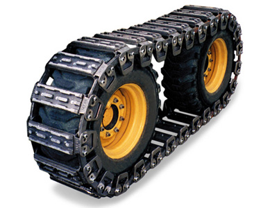

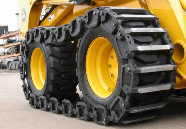

Howdy again ! One of my sons who is not a TBN member (yet) asked me to post and ask for him . He has a SSV75 Kubota wheel loader .
Questions has anybody here ever ordered and mounted those over the wheel tracked systems for there wheel loaders for better traction in theory when they have to go in mud / snow / wetter areas ?
If the system works decent did you go with rubber instead of steel tracks ? Weve been viewing some YouTube vids on these over the tire tracks and wanted to hear from any TBN folks opinions please .
From what research we have done the better brands appear to be Grouser Tracks , Camso and McLaren . My son was leaning towards heavy hard rubber over steel tracks to in theory tear up the land less ? Also we are aware some might require spacers and even out set wider rims and tires . He is just a land owner and does not use the skid steer to make a living .
Once again anyone out here with any hands on experience regarding these "over track tire" skid steer questions ? Big thanks in advance !!!

They’re not even close to as good as a real tracked machine. You still only have the same ground contact pressure of the wheels. Some people claim the traction is better and sometimes it might be but they’re also prone to getting slicked with mud and letting the wheels slip inside them.

A number of years ago I went through the same dilemma you have now. I have a Cat 246 that was a tire machine and was horrible in snow. I asked plenty of questions about over tire tracks. Not many good reviews. One that really sealed the deal was a guy who had rocks bounce onto the middle of his track and get sucked around between the track and tire, puncturing the tire ..at that point it was clear I didn’t want them. I ended up getting a full bolt on set of tracks from Logering..they were about 10k and have been excellent

I put a set of steel on a skid steer one time...
Traction was improved drastically!!
They tore up the ground worse than my dozer does!!
I HATED the skid steer and got rid of it!!
