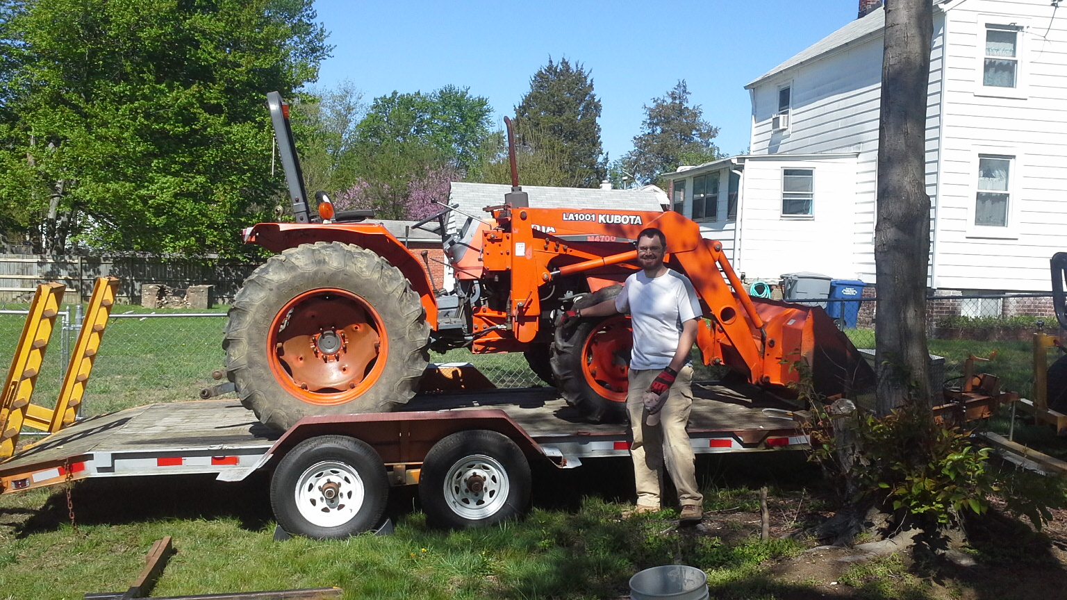

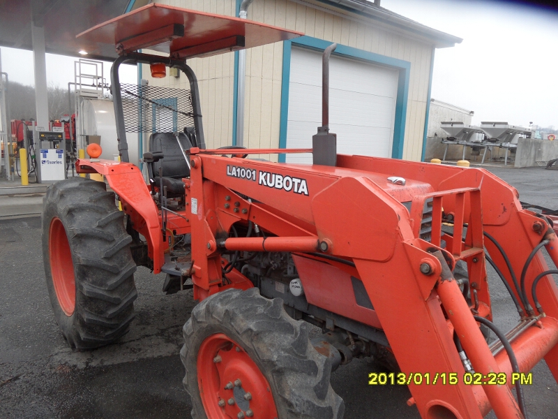

My M4700 HAD a canopy:
I've 4 shops to park it in, do things with it:
As you can see the shop on the far right has a rather "standard" garage door.
But that is the one shop with my chain hoist in it.
I removed the canopy to trailer it from Alexandria Va. down to Mississippi.
With the canopy off it fits in the small shop with about an inch to spare if the door is rolled ALL the way up.
Serendipity.
I may not put the canopy back on. A cab definitely would not fit.
To the OP - measure three times, you won't be able to CUT.
