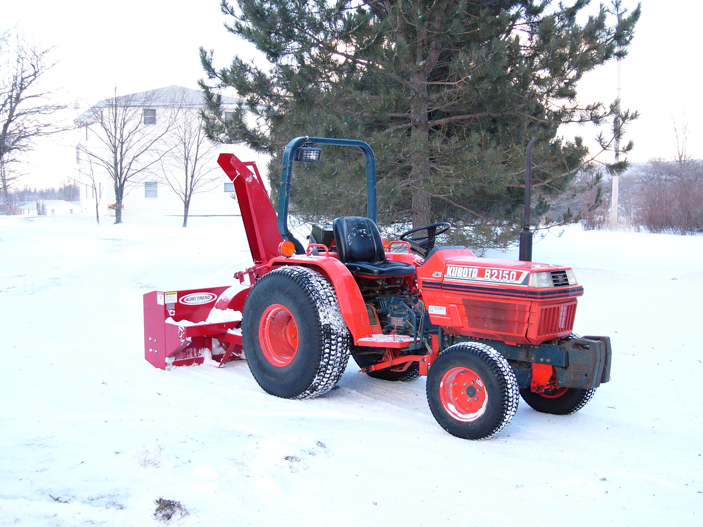

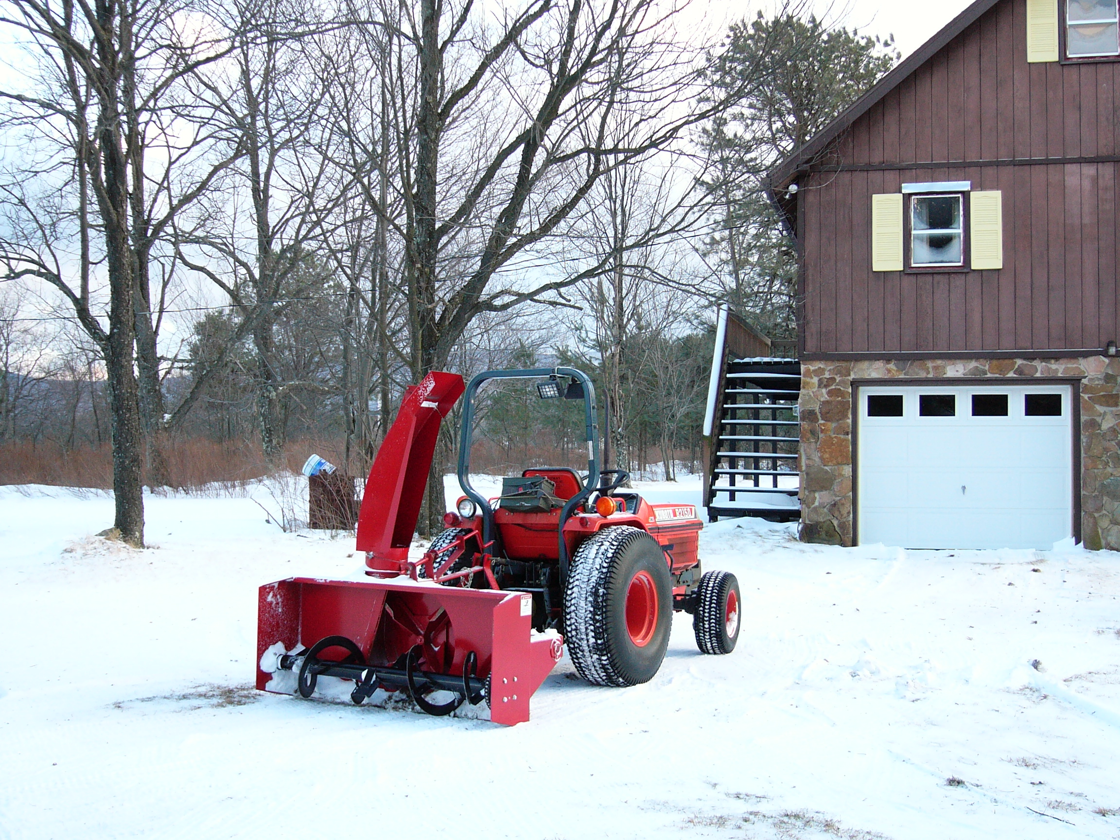

Nothing great about this, but here are 2 pics of the blower I use up in WV with an older B2150 Kubota. This is a 5ft Agro-Trend blower made in Canada. For some reason a lot of blowers are made up there. I got it new from a dealer in PA. Never a problem with it , but I sure recommend buying from a dealer close to you.
Note the fat turf tires on the B2150 which totally preclude chains on the rear. These pics are from 12 or 13 years ago. I have since swapped these tires out for R1 ag tread tires and found they are so much better in snow that I don't even need/want chains anymore. I'm sure my snow challenges are quite minor compared to Hailey Idaho (!) and your new machine should be a thing of beauty for that area. I see a foot or two most seasons and a few times 30 inches. Big problem back East is heavy wet snow at times and snow followed by rain and freezing. Only being up there (in WV) sporadically, I tend to face badly packed snow that has been on the ground a while.
