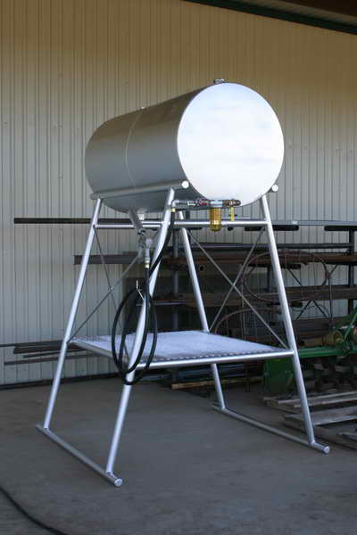

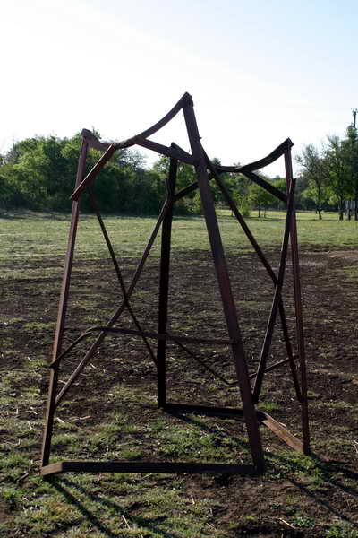

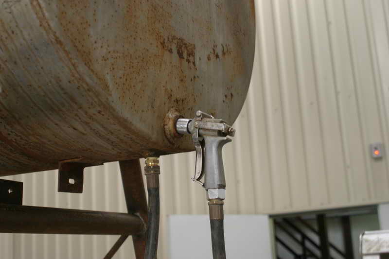

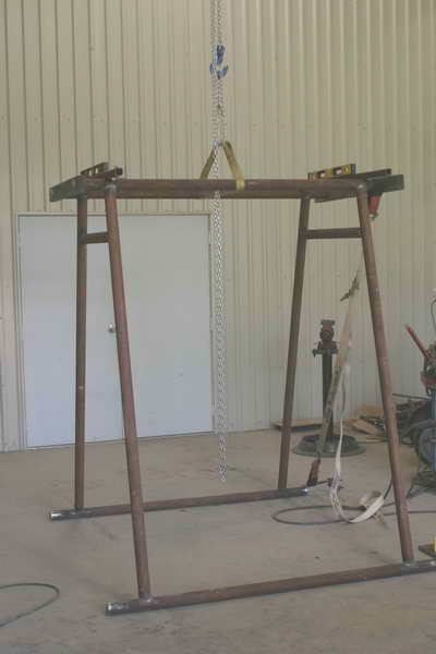

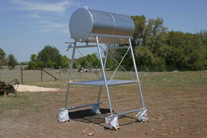

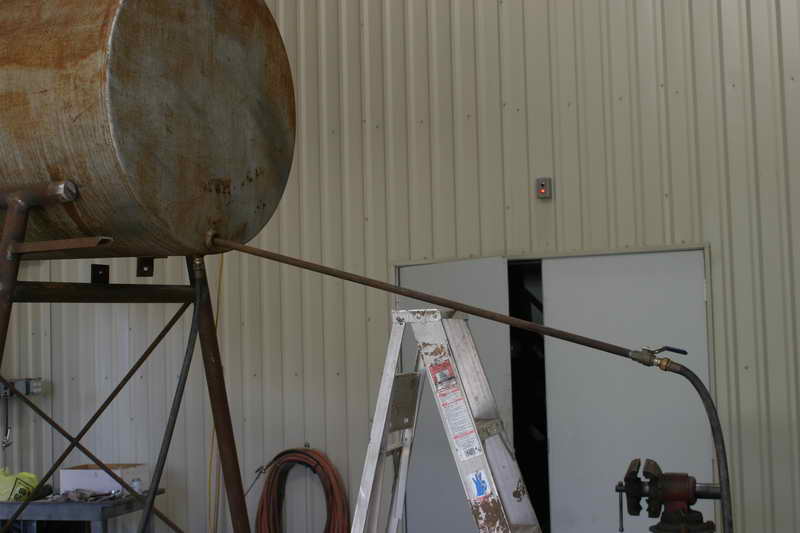

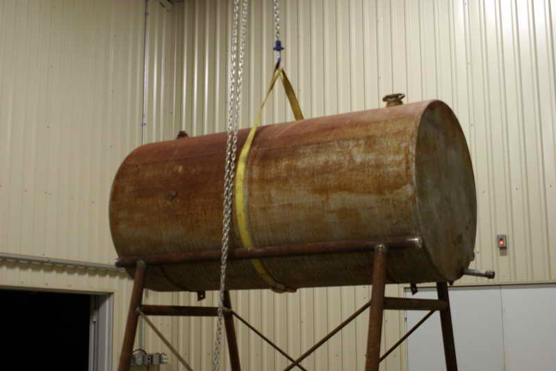

I re-furbished a used overhead diesel tank that I purchsed for $60. The stand was a little beat up, so I built a new one. The tank itself was dirty inside, but almost no rust. I replaced all the fittings, hose and nozzel.
To clean the tank out, I used a hose nozzel followed by a custom made spray nozzel to get 360 degree coverage. They were hooked up to the hot water outlet. I then plumbed my 175cfm air compressor into the tank and blew it dry. Between the hot water and the hot air from the compressor, it was clean and dry as a bone when I was done.
The only thing I wish I had done different was use teflon tape instead of recto-seal for the pipe threads. Some of that stuff will come loose and wash through, I'm sure. Hopefully the filter will catch any from the tank fitting and the rest I think dried well enough.
I put 10 gallons in it to check for leaks and all everything looks good. I'll get some diesel delivered this coming week.

More pics. I sandblasted and painted it this weekend.

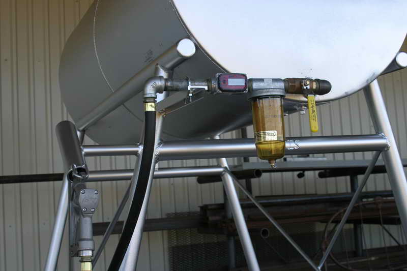

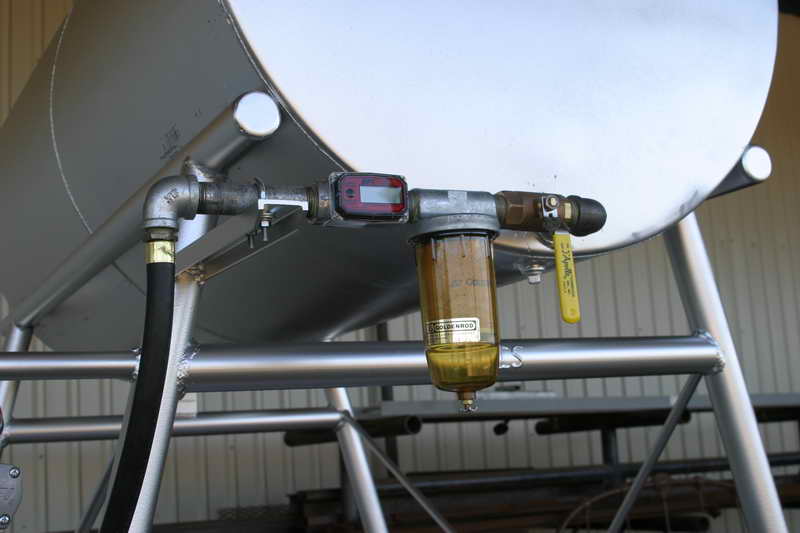

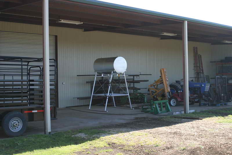

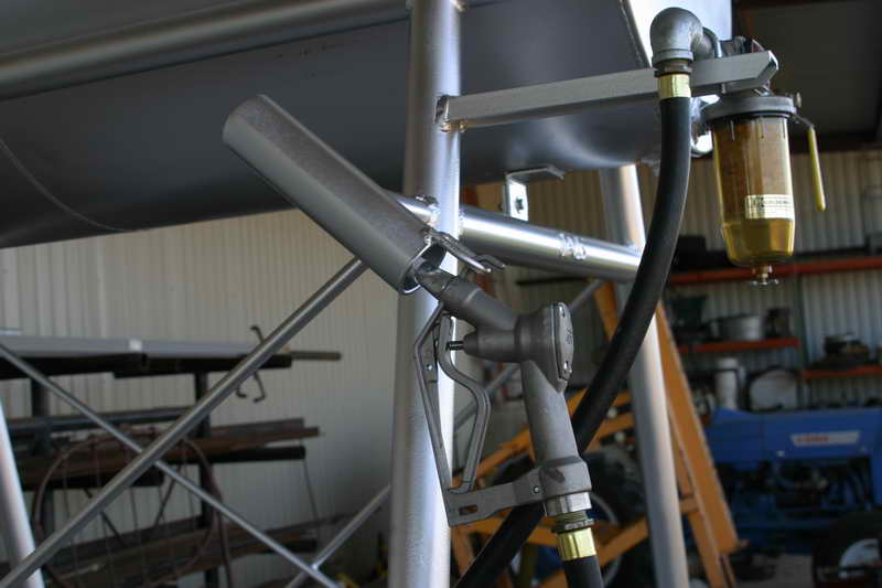

Last of the pics. The fuel meter was a bit pricy, but a fun thing to have. The ball valve is a locking version, but I don't think it would stop anyone determined to get some fuel. I just couldn't find one I liked better.
The tank is 3'x6' and will hold about 300 gallons. A 500 gallon tank is commonly 4'x6' and the stand is built to hold either one.

   / Overhead Diesel Tank Project #4
Tank and stand came out nice !
Silly question maybe............ but how does the fuel guy fill the tank? Surely he won't climb a ladder to get to the fill. Around here, the fuel guys won't hardly step on snow, or in a puddle to get to your fill........ nevermind having to climb to get to it. Maybe you don't have Nancy-Boy fuel truck drivers in Tx.?

Here are some pictures of the spray head I made for the end of the pipe I stick into the tank to clean it out. I hook the 1/2" pipe to the hot water and go through the outlet hole on the face end of the tank (where you normally hook up the hose and nozzel). The spray head is a 1/2" cap that I've turned down on the lathe and then drilled with 1/8" holes at 45 degree spacings. Otherwise, it would not fit through the 1" pipe thread hole. If I had it to do over, I'd plug the end of the pipe and drill the holes in the end of the pipe itself.

1. Yes, the raised tank is for gravity fueling and therefore no pump required. I don't know what the flow rate is but it's faster than my hand pump for sure!
2. The stand isn't meant to be moved around much. I can lift it with the tractor and pallet forks, but I don't attempt to move it when it's full of diesel. So, it will stay in one place between fill ups.
3. I wouldn't store gasoline inside a building for sure. However, this tank has diesel in it and is under a lean-to cover. Check with your local fire department and your insurance company if you think there might be an issue.
4. When I was building my tank stand, I asked the local fuel delivery if they wanted a ladder welded to the tank. They said no, we just back the truck up to the tank and stand on it. Sure enough, the delivery truck had steps built into it just for this purpose.
