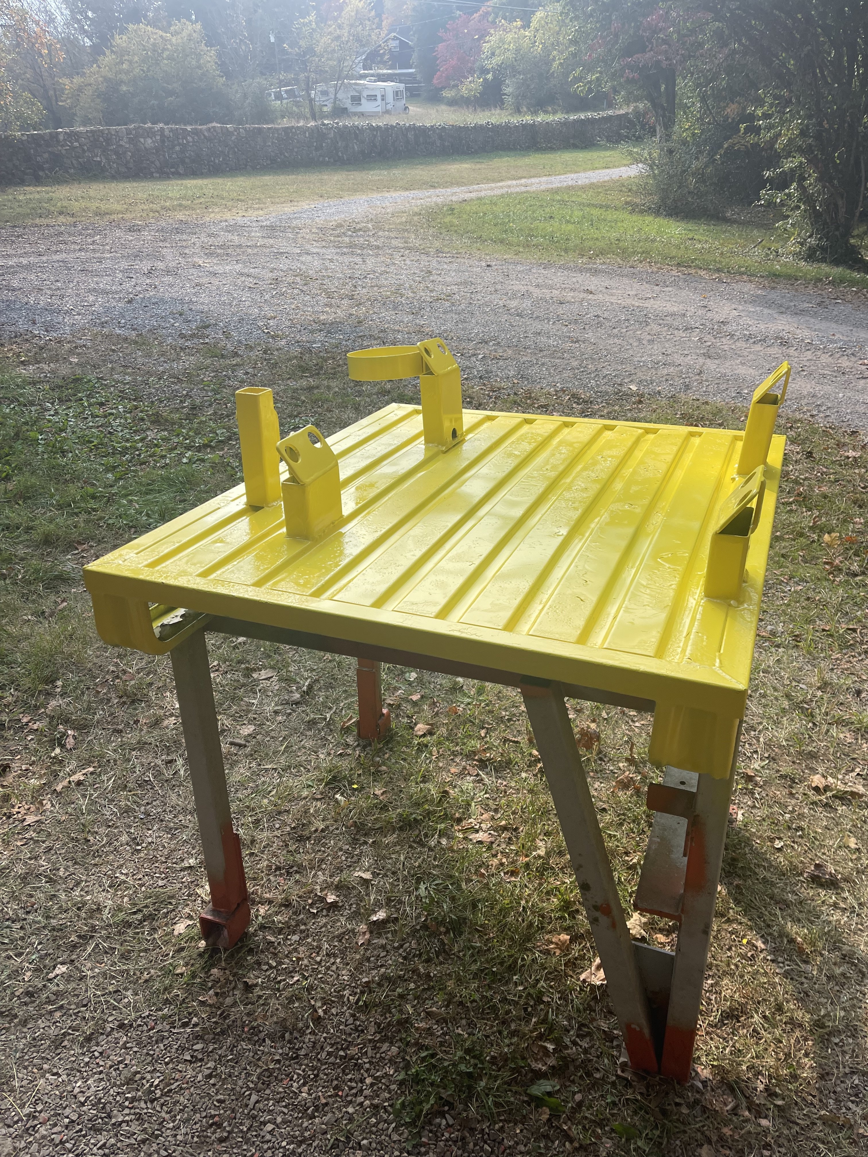

Age and injury made 5gallon cans harder to deal with. Decided on Vevor 116gallon tank and pump. $733. Quickly shipped.

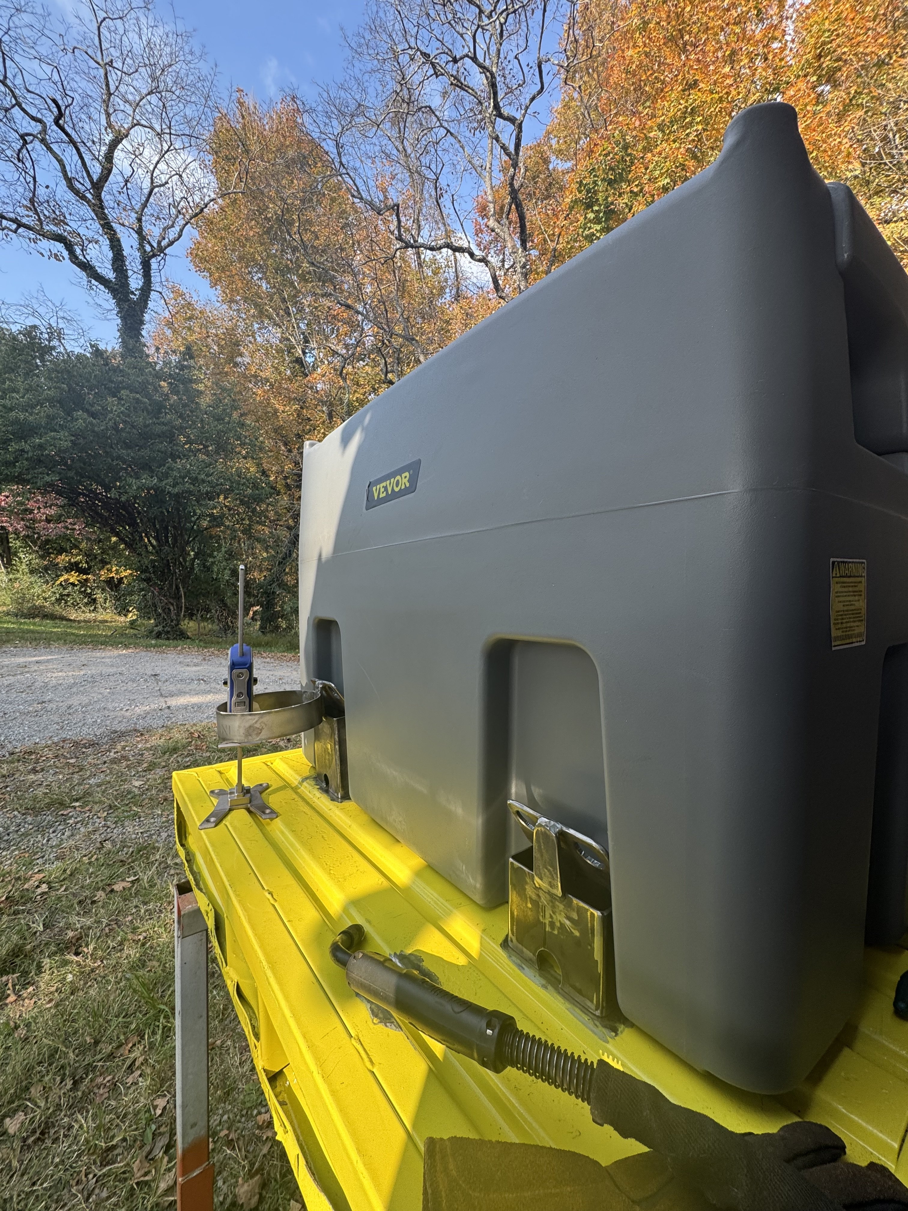

Plastic tank has fork pockets. Tractors are poor fork lifts so needed to mount on pallet. $24 metal pallet from scrapyard much more durable, allows 4-way entry and takes bumps and rubs better. Made guides/post to lock into the tank’s recess hand grooves.

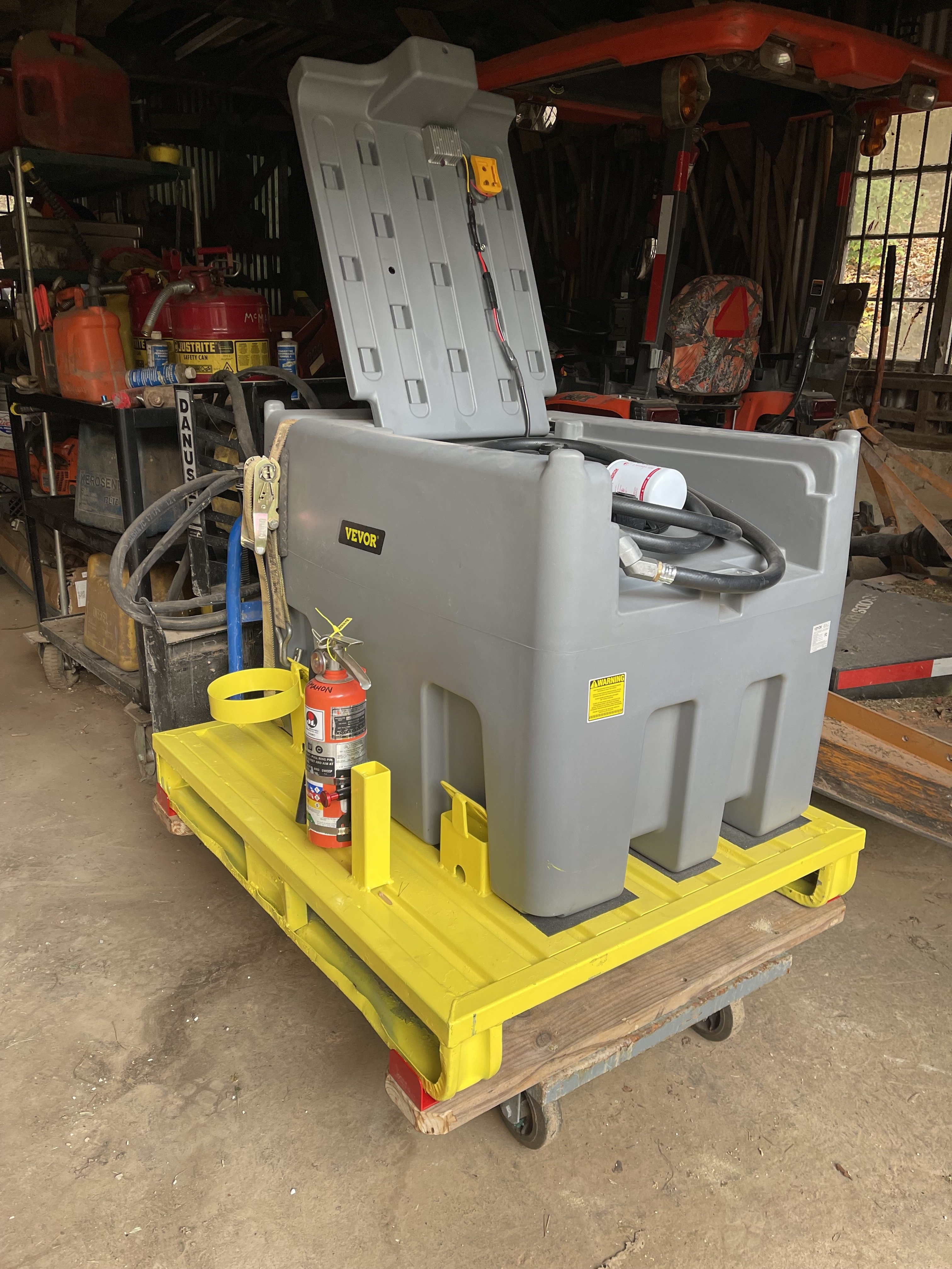

Added tubing for an extra nozzle dock and fire extinguisher mount.
Added a converter to use Dewalt 20v battery option under the lid.
Need to check and tighten all fittings, filter, and mounting hardware.
Glued gasket to fill cap.
Added two-way swivel fitting between nozzle and hose.

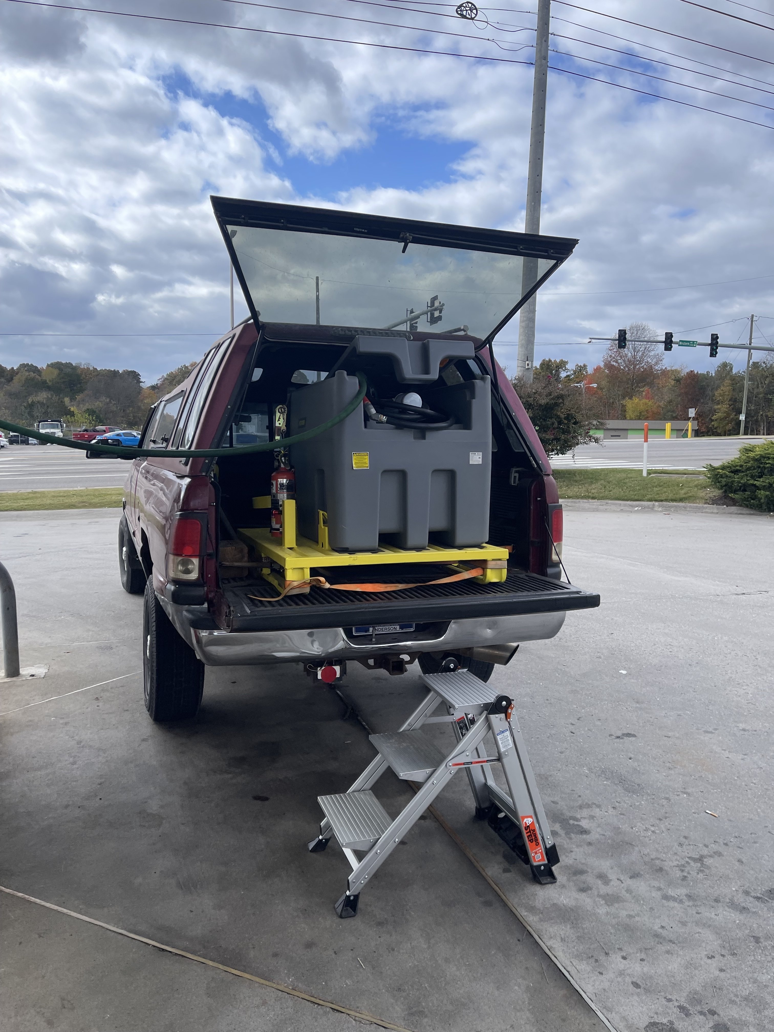

Loaded and took to station to fill. Bought taxed diesel at $2.75/gal. 107 gallons filled to about 2” from top. Didn’t spill a drop transporting home.
Unloaded and set on 2x4’ flat cart for easy moving in tractor shed.
Using a Dewalt 5ah battery. The pump easily primed. Filled both tractors. Didn’t spill a drop. So easy! Automatic nozzle shut off. Did a five minute recirculating test back to tank. Pump and converter barely got warm. Pump is 10-11 gallon per minute and 30 minute duty cycle. Battery pack stiil had two of three bar charge left. Two wire connector still allows connection to battery clips cable if needed. Pump is rated at 140watts and converter rated at 180watts. Access to tractor batteries is more difficult. Converter and battery receptacle $20 from amazon.
Pump has screen inlet and 30micron with water blocking absorbing media discharge filter. Pump flow slows indicating need to change canister filter. Vevor doesn’t stock replacement parts. Haven’t yet sourced a replacement filter.

Overall, nice-looking tank setups! I've got mine installed in the back of the truck. Can fill truck or tractors as needed! Buy fuel when I find good price.
Road fuel, by the way. Don't use enough to justify off-road fuel. Plus this way, no lifting of cans!

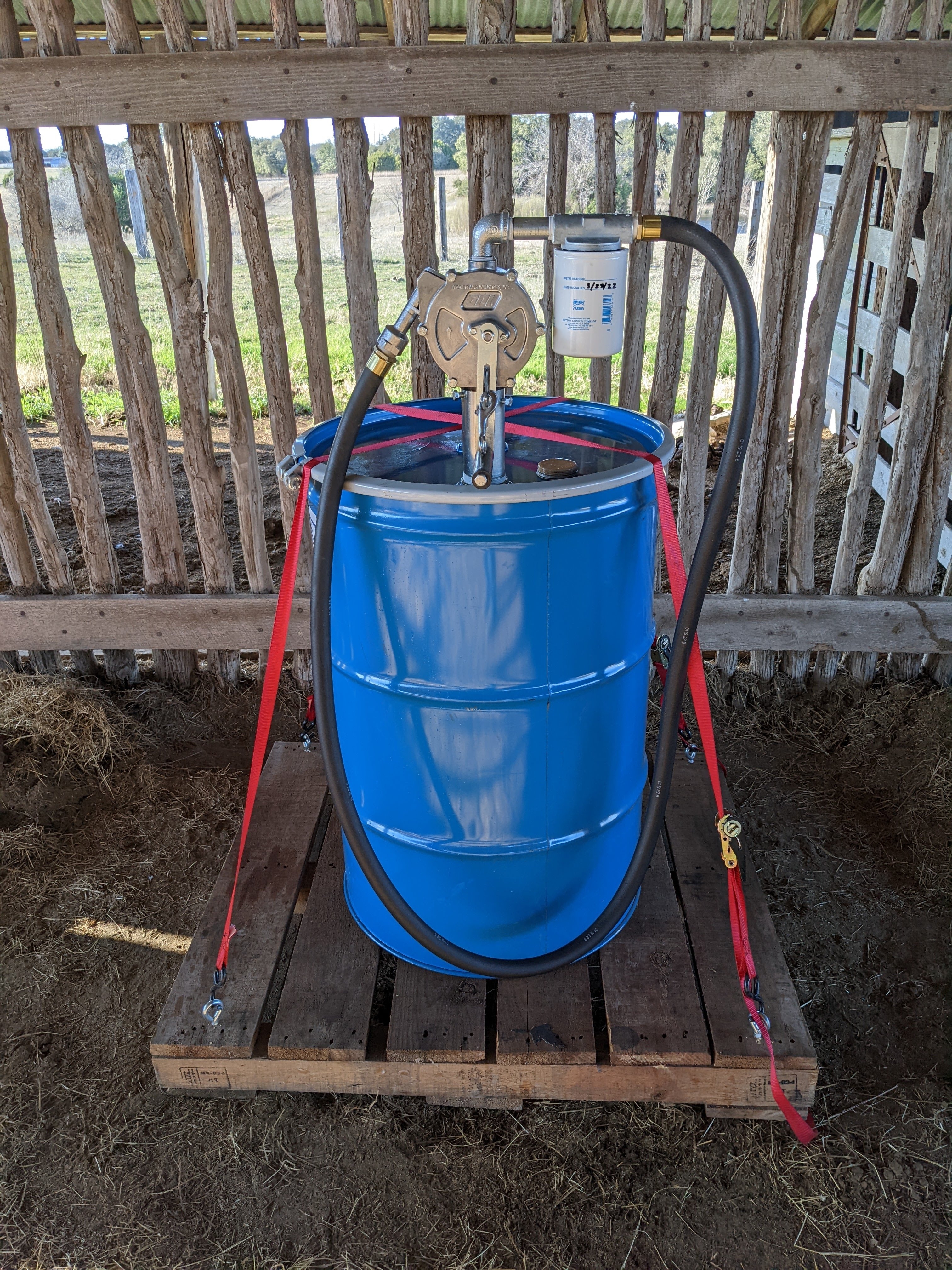

I use a 55 gallon drum and a rotary hand pump I put together for diesel a couple of years ago. It's not this clean any longer...🤷‍♂️
I want to do something similar for ethanol free gas for the mowers/splitter/generator/etc but I just don't want to spend the $ on what they want now for the pumps... 5 gallon containers for gas still....

Like the fuel filter. Is it the water absorbing kind plus particulate filtration.

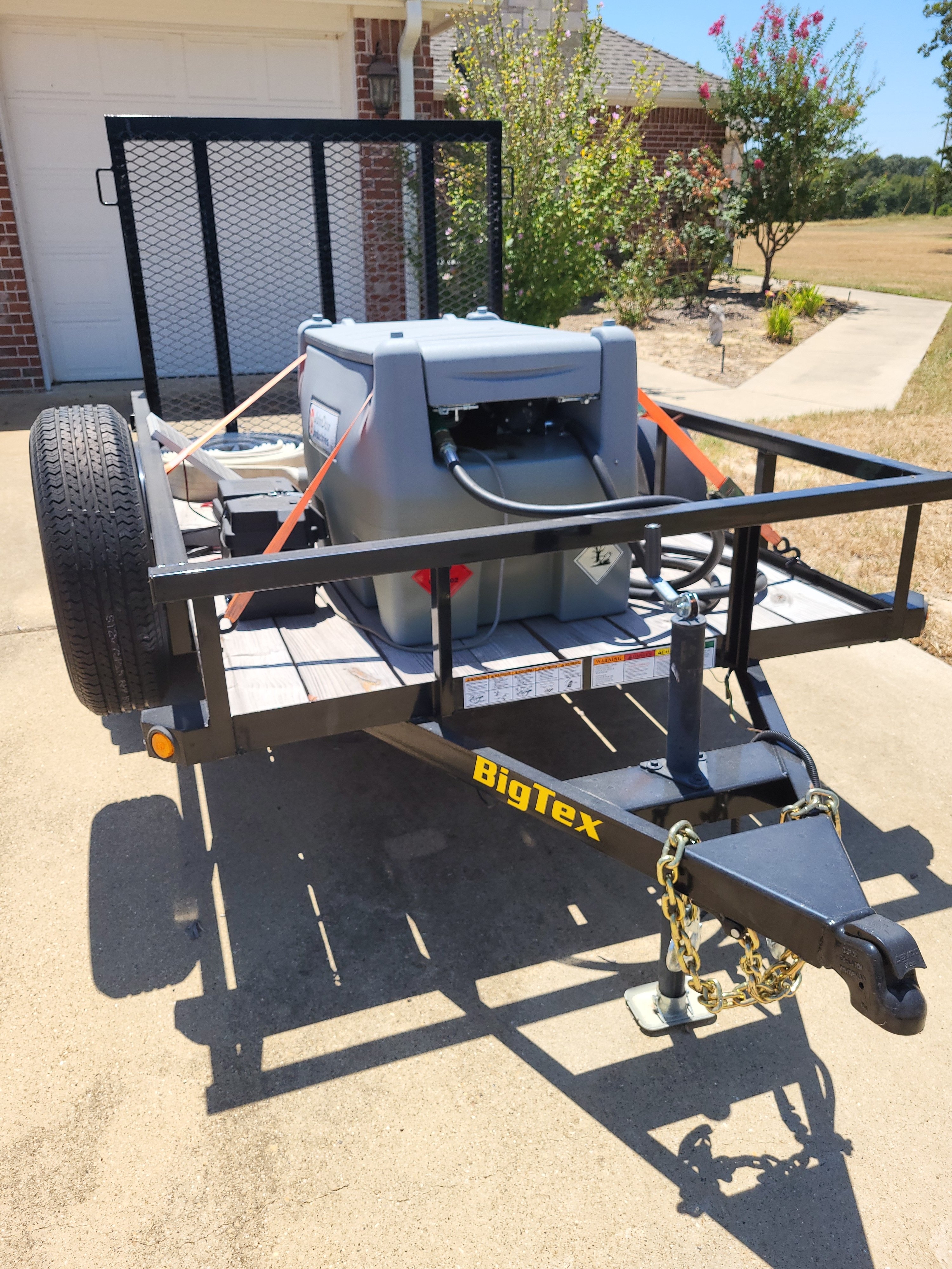

I am bothered by hauling it in the back of your truck. I use an open dual axle trailer so I can tie it down sloshing fuel has a lot of power. Also diesel vapor especially in warmer months is highly explosive in enclosed areas. Just a thought. Diesel fuel not real dangerous but diesel vapor very dangerous. Need to treat it
Like gasoline for safety
