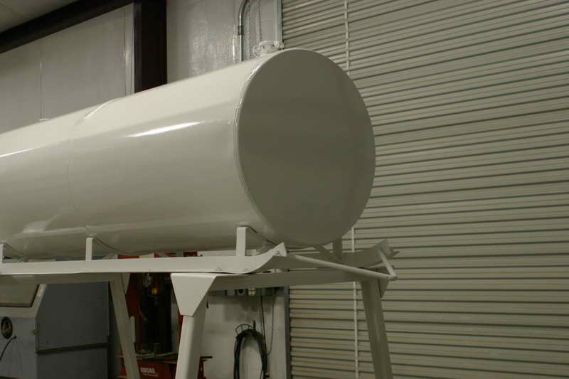

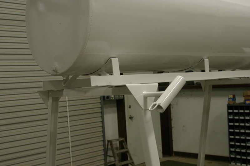

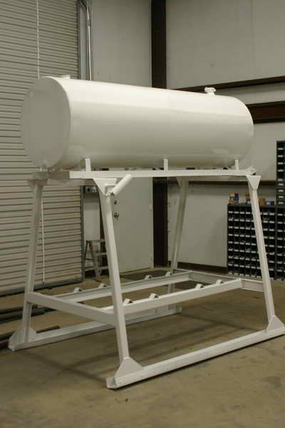

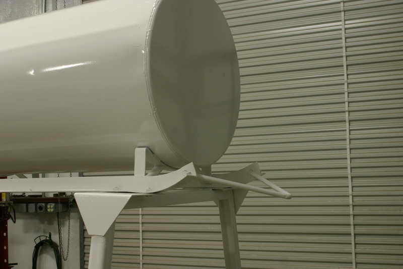

Well, I seem to be on a tank rebuilding run. I picked up another tank, this one for $25. The stand is in good shape so I just cleaned out the tank, sandblasted and painted. I did weld on a nozzle holder, but that was about it. The nozzle and hose are in good enough shape to reuse, so I just have to buy a new filter, ball valve and some fittings. There's a farm auction this weekend not to far away. I think I'll put it in there and see what it brings. Any one want to play the "how much it will go for" guessing game? The tank is 30"x93" so about 280 gallons.

   / Overhead Diesel Tank Project #24
You are a lucky man. When I was trying to find tanks I finally had to give up and build my own.

Well a buddy called today and wanted the tank. Paid $250 for it sight unseen. So, no having to load it up and take it to the auction house.
Funny thing is I don't ever see any of these tanks for sale new, except at one TSC. Maybe there's a secret "tank shop" that I don't know about.
