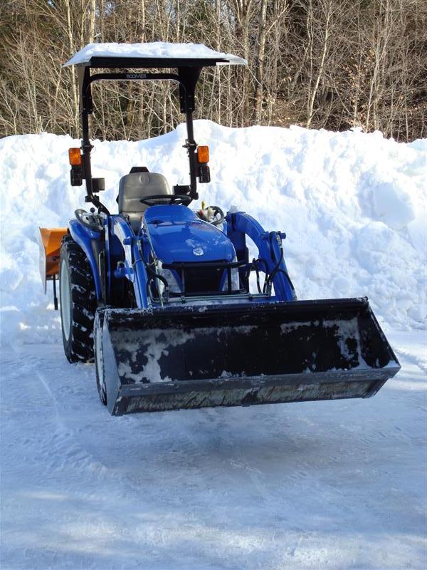

Welcome to TBN :D! They do make Fall Over Protection (FOPS) canopies for aftermarket tractors that mount to the tractor's existing Roll Over Protection (ROPS) roll bar. I got mine through my tractor dealer. I believe that the FOPS manufacturer was the Perry Company out of Texas, but I seem unable to find them on the internet at the moment. Just be aware that there are sunshade type canopies (i.e. fiberglass) and FOPS canopies (metal). I purchased my FOPS after dropping a load of snow in my lap a couple of years ago. They do block branches as well as knock into lower limbs (just another thing to focus on while working the tractor). I have not dinged mine yet :rolleyes:. Jay

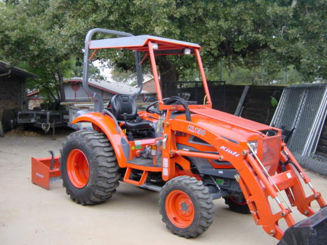

Here is what one guy that posted in the Kioti forum did, and it looks great!

I loved that! I saw it via a google search and tried PM'ing him, but i think something got messed up between the gallery and the forum (gallery said the user was hpowell and the forum said RedRocker). Will try again...it looks very sturdy and i like having the bars up front to push brush out of the way.

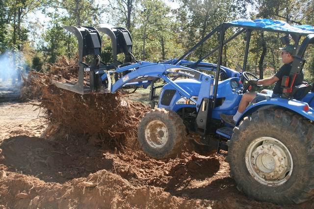

I had a local welder build me an excellent protection system out of square stock and expanded metal (the stuff that looks kinda like a metal screen). It attaches to the rollover bar, forms a canopy overhead, then the frame comes down to attach to the front end loader frame. Then it also goes from the canopy part and angles down over the hood to attach to the front bumper. It all pins in for quick detach/attach, and the expanded metal even has it's own framing made of flat steel pieces. The expanded metal part also quick-pins on. It deters some of your view but not enough to worry when you're in the woods.....heck I leave it on alot of the time. It's the best thing I've ever seen and trust me.....you don't wanna buy one of these NH plastic hoods............$3,800.....I know..... that's why I had this made.
I don't have real good pics of it right now but here's one that shows the expanded metal off. I have a make-shift tarp on the top for shade.

That looks really good! I like the front reinforcement on it. If it was ROPS mounted only, something heavy would probably fold the whole thing in your face. Also gives me a place to mount some brush guards to keep from getting whapped by the scrub (esp the Hawthornes)
