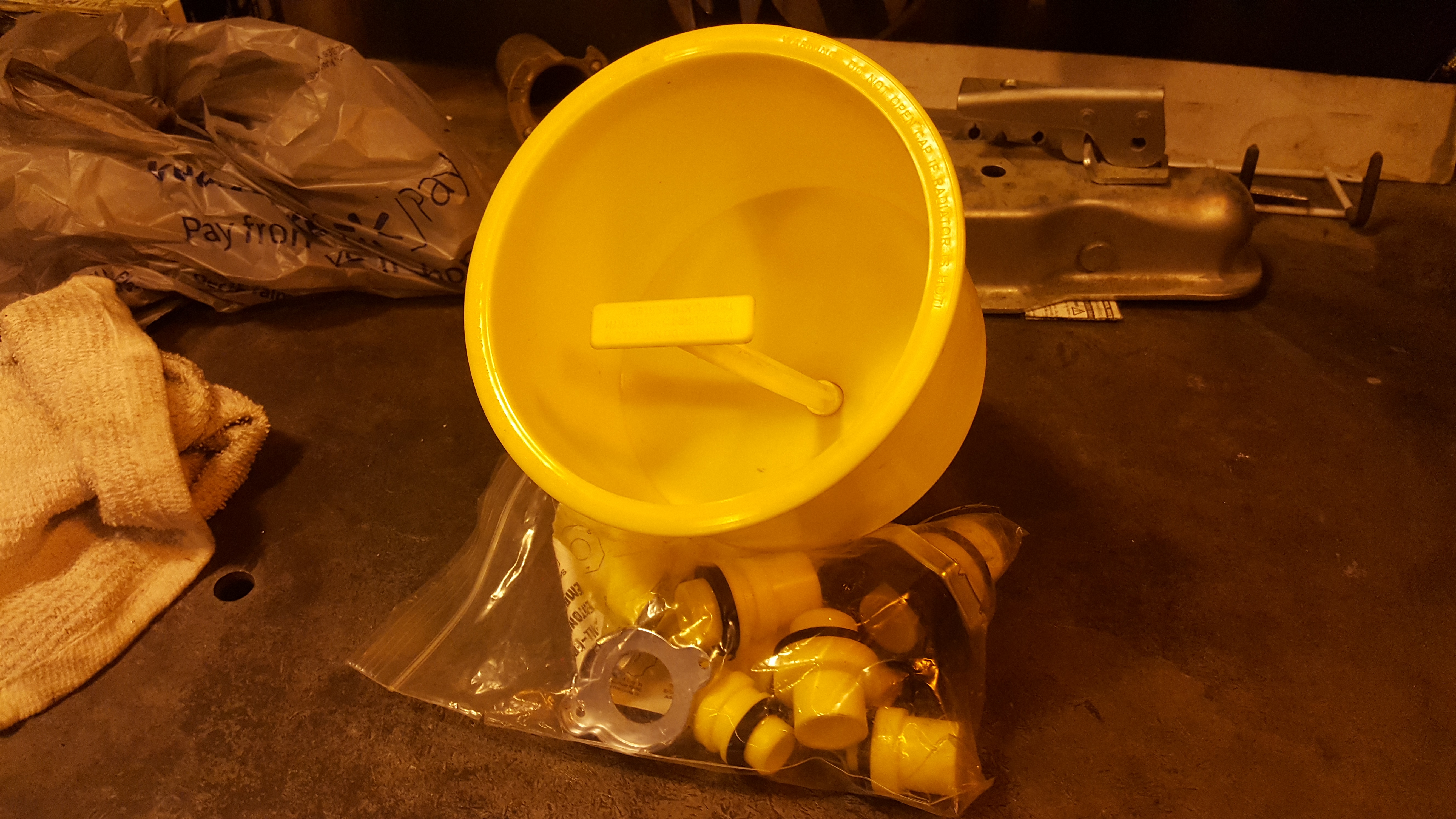

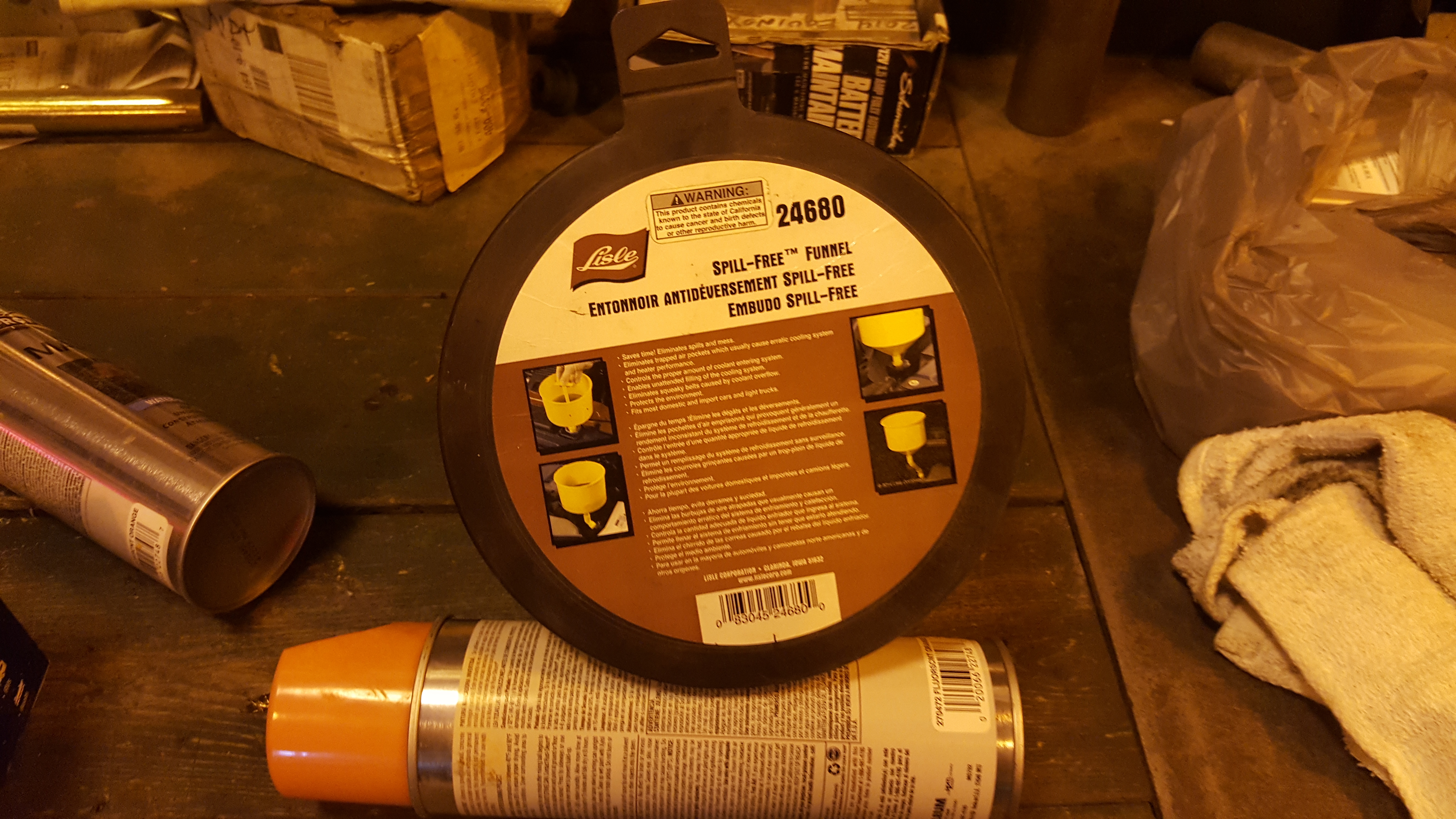

This will be my last comments. I looked on the JD web site and what I think is your engine details. I am not exactly sure because of maybe a serial number break. Anyways I think you have a lot of plumbing above the radiator fill. Just maybe over time your have been leaking a small amount almost un-noticeable amount of coolant/ loose clamp etc. You over heat one day and check things out and try a new thermostat. Just maybe you didn't get the system completely full, aka an air pocket per se. An easy way to fill your system is to get one of the special plastic funnels kits. I have one and it cost something under $30. I use it to fill my gator coolant system because of the heater arrangement being above the radiator fill. I makes it such that you can fill above the highest point in the system using some of the special extensions in the kit. My is a Lisle, attached pics. I got it from Amazon. Depending upon the highest point of your coolant system you can always add an extension hose if needed. Because of the small cost I would get one just for it's no spill design. On Utube "Eric the Car Guy" has a instructional video using this system. That's it. Later.
