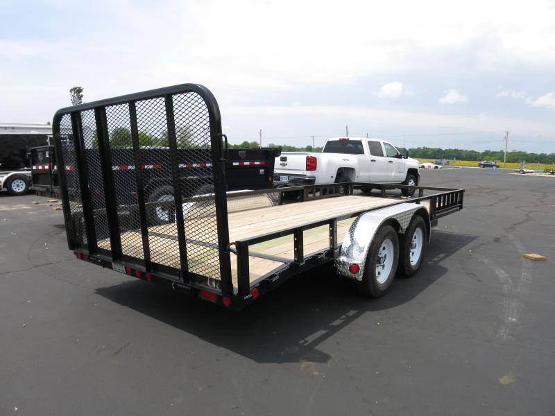

I ordered a PJ 7716 utility trailer with a bed height of 21", improved to 18" with a 2 ft dovetail. The drop really helps, and won't make any difference on my loads.
I'm also going to build a loading berm at the places I use the most. Stack up some railroad ties and fill one side with dirt. I'm also ending up with 6' aluminum ramps and the 51" PJ ramps to use together. That will be fine. Apparently I wasn't the first person who needed to use a second set of ramps to move something low.

Is this a deck over trailer?
   / ? overlap ramps to improve angle ?
#23
Not a deck over. Mine is similar to the pic, but I didn't order the fold up gate cuz it's too short to help me load and not strong enough for my tractor. They'll delete the gate and put a rub rail across the back so I can use either the short ATV ramps that come with it, or the 6' ramps I'm getting on my own.
