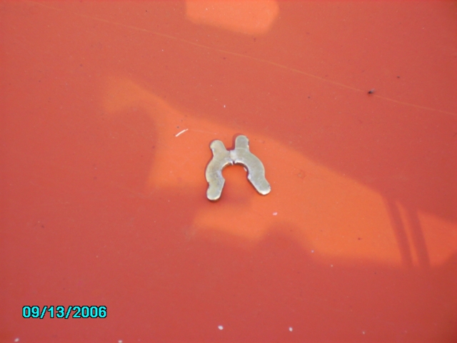

Don't know how mine look before it came off .But if it was braded they forgot to do it.Maybe Hoyetractor or some one will post a picture of a new one.I would like to see a picture of one . Because I do need a new one for my YM1700 so I don't have to take them off all the time.

I was at tractor supply today and theres were braded no c- clip . But if you look at the picture in my first post you can see there is no braded marks on it.

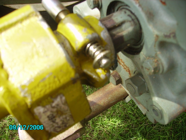

I was bush hogging today and the over running clutch came off the tractor's PTO shaft. Just like what happened to most people on this thread, the spring and pin came out. It is lost in the field somewhere. It is the tupe that does NOT have the C-clip.
My question is: Can just the spring and pin be replaced? If so, WHERE can I get the replacement parts with a c-clip?
If the replacement parts can't be found, then I will buy the over running clutch with the roll pin.

Tractor supply will have them . if you get the pin at tractor supply .go to a hardware and get the c-clip it will be a better one.
/ Overrun Clutch #26
I have one of the same overrun clutches and it fell apart the first day I received it, I did find my pin and spring. I when to the Auto parts store and got a C -clip and it is doing good TODAY.
