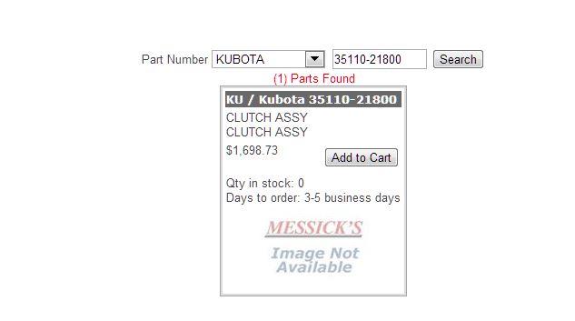

A L245DT has an internal clutch on the pto shaft that I think is an ORC.
