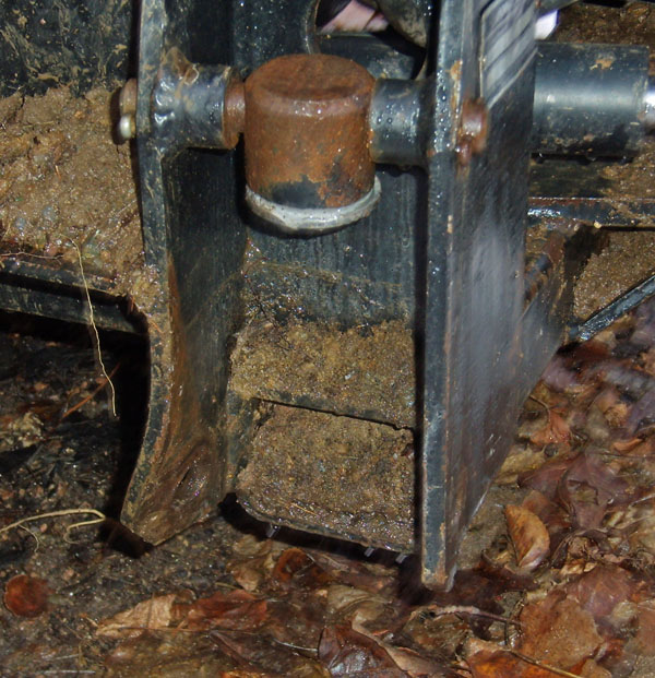

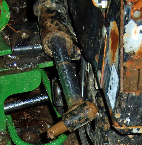

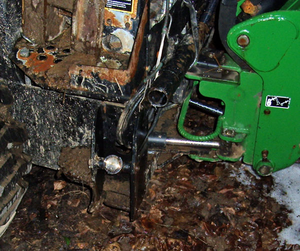

Got careless and broke the stabilizer hydraulic cylinder on the backhoe.:mad:
Thinking I can maybe have it welded back up.???:confused:
Pictures show bent flanges for the inboard end of the stabilizer and the broken cylinder.

OUCH. :(..must have been real hard pack snow drift.;)
I've seen good welder make such repair to a cylinder..not bent,straight break..little heat w/heavy hammer flanges should be good as new.
What a bizarre break, EGON. Must have been a crappy weld. By
all means, weld it up. That will be easier than bending back the
bent parts. The spray of oil must have been dramatic!

No oil spray. the weld was OK. The pin holding the stabilizer to the sub frame broke. It showed signs of previously having started to break.
Heated the flanges up and straightened them. Pulled the cylinder apart and had the ram straightened and then the cylinder end was welded back on. All done this morning for $168.00.
A new cylinder was $750.00

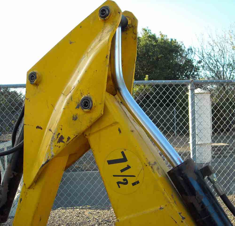

Well, EGON, nobody should have to pay $750 for a new cylinder. The
dipper cyl in the photo is from a Praire Dog hoe like mine. It buckled when
the whole weight of the tractor fel on the retracted dipper. This is
a 2.5x16.3x1.25" cylinder and I got a new one from the maker for $350.
The owner went to a hyd shop and was quoted $380 to do a new one
from scratch, unpainted. If it were mine, I would have bought a new cyl
from SurpCntr for about $175 and welded on the correct cross tubes.
New cyls from most tractor dealers are insanely priced. Even if nothing is
salvagable from the damaged cyl (as in this case), making a cyl from
scratch is heaps less.
