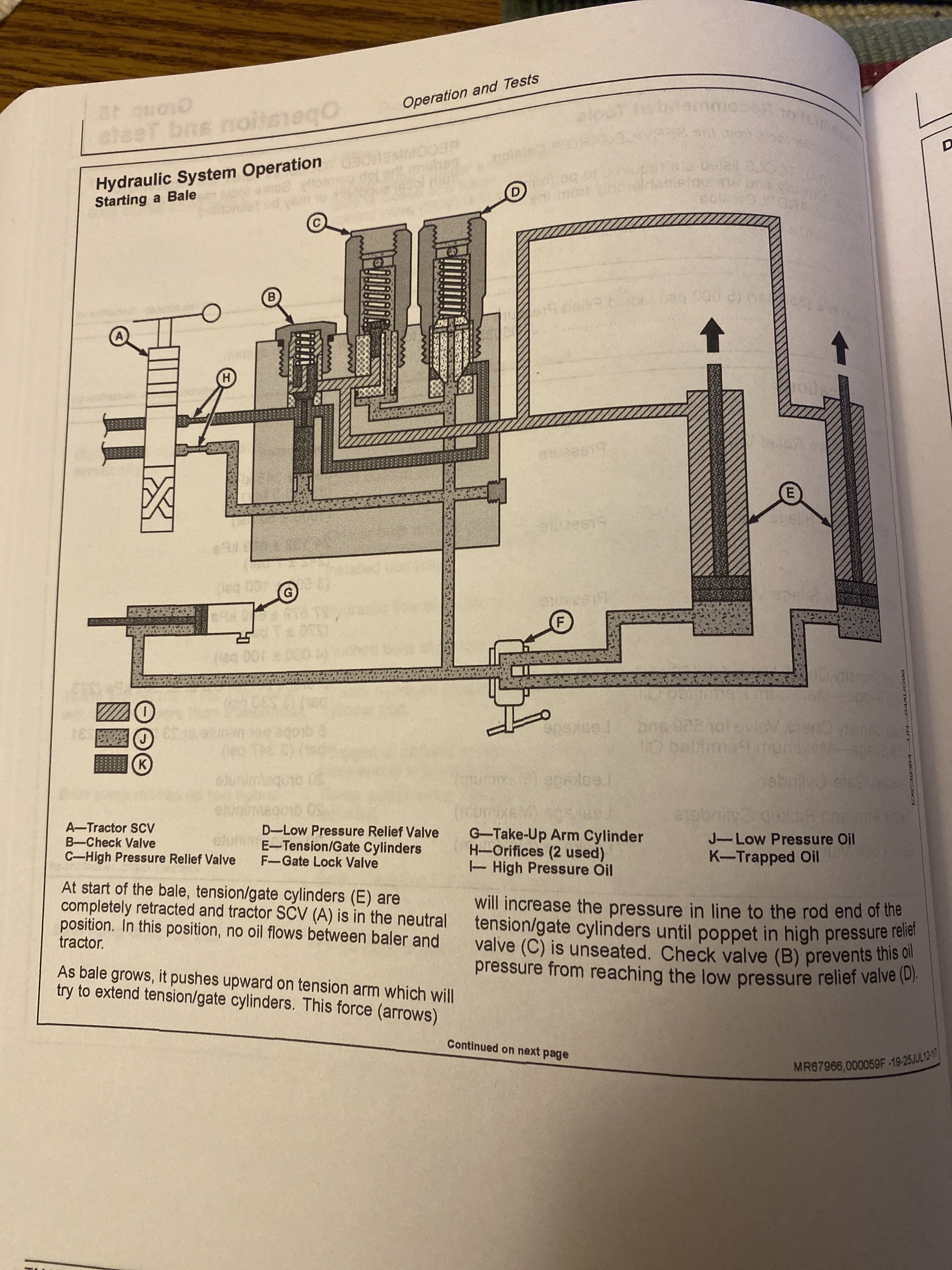

Screen for catching pieces of O-rings?
Since not sure what the schematic or circuit looks like I am only guessing but suspect the intent of the screen is to catch debris in lines from cylinder to manifold.
Screens on valves are semi worthless unless they only flow in one direction since flow in the side of the valve screen collects debris while flow in the nose debris is flushed back into the system.
Looking at picture that check prevents(blocks) flow from side to nose based on O-ring and backup ring orientation.

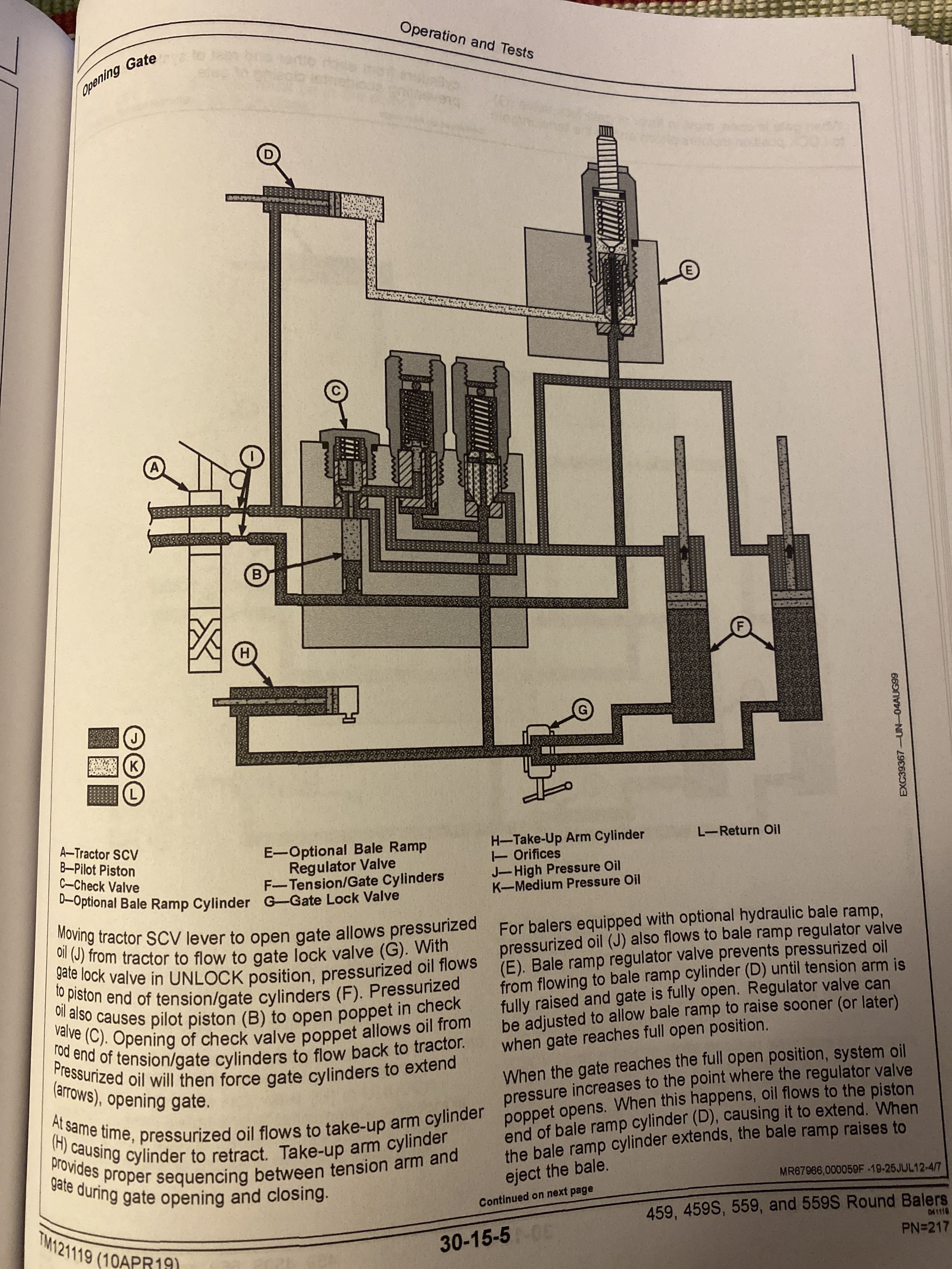

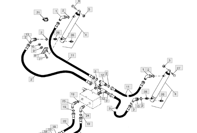

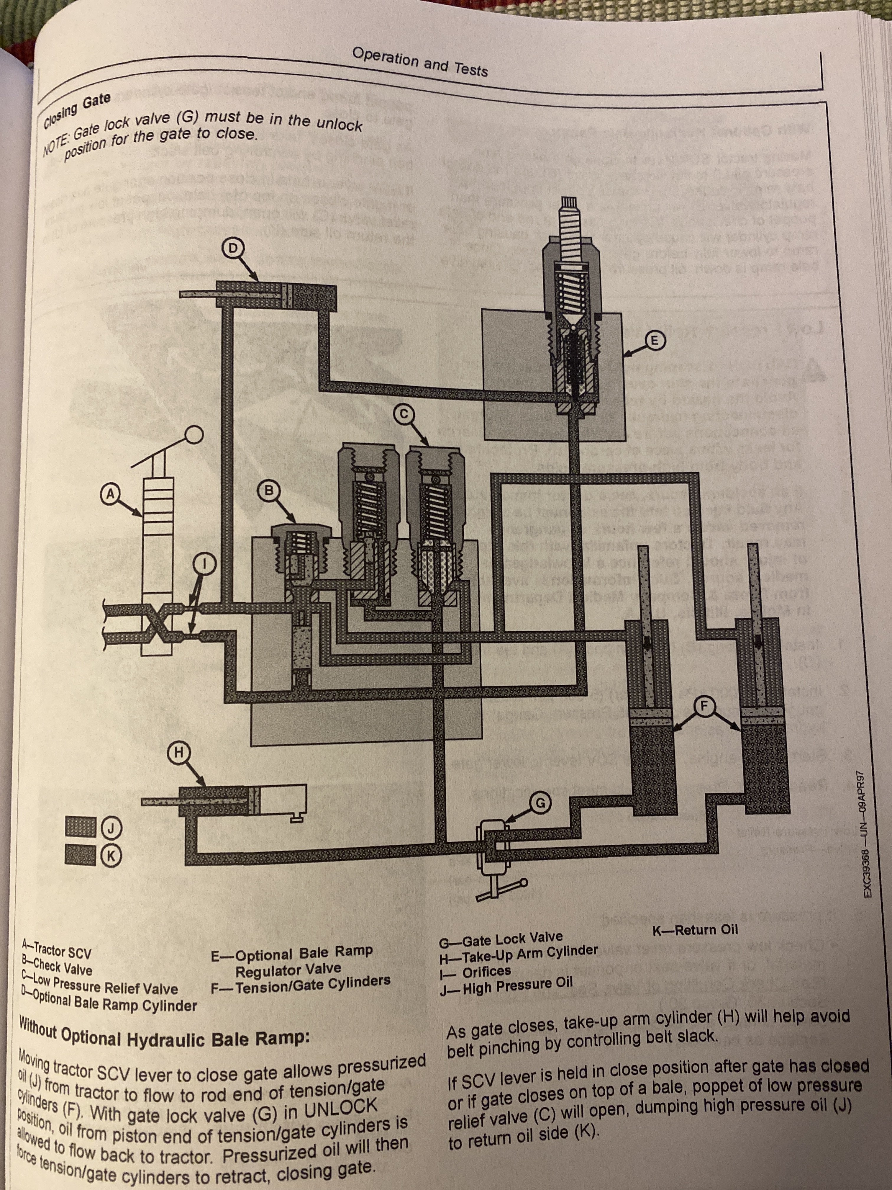

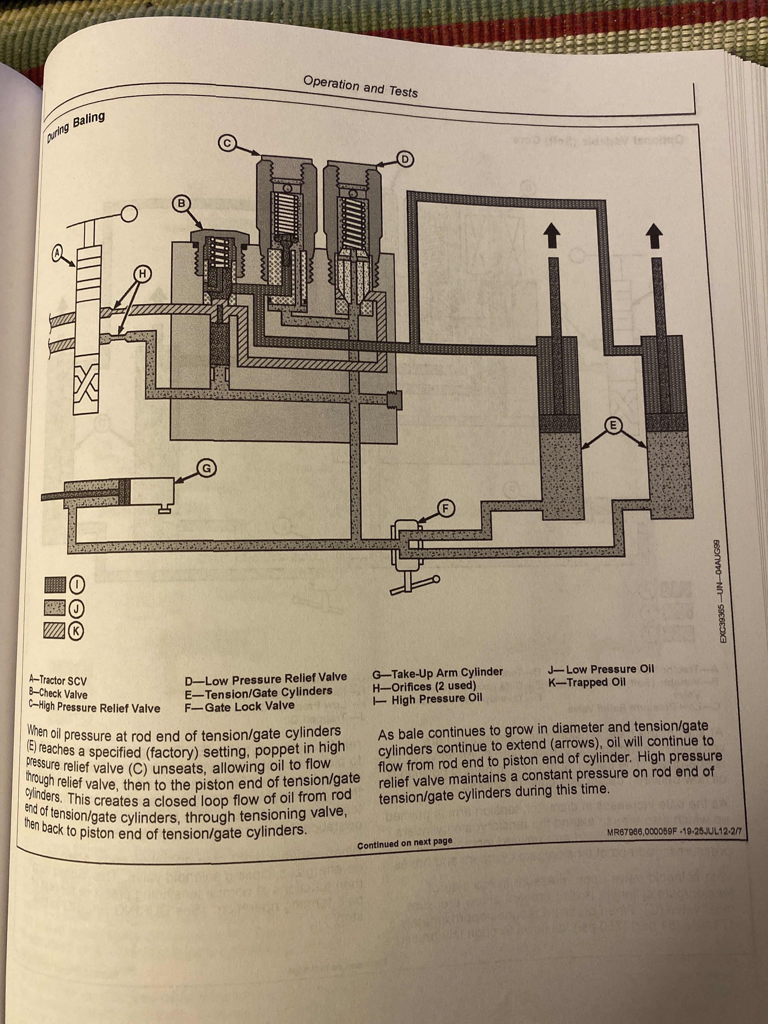

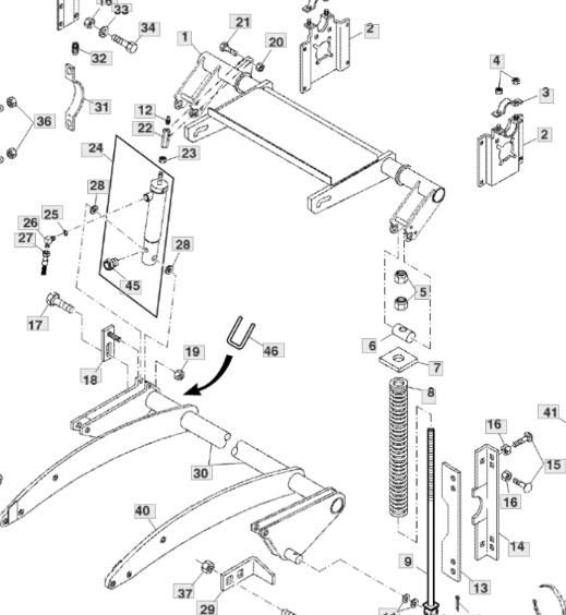

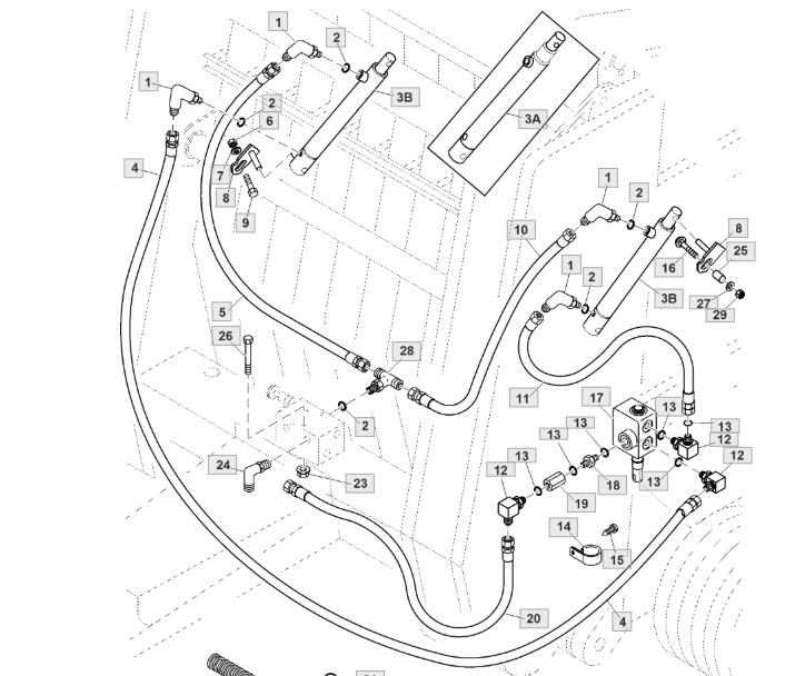

I'd like to clarify that this thread should be titled 45X not 4XX. JD rd balers capable of making 6 ft diameter bales have 2 double acting tension arm cylinders not 1 single acting cylinder on tension arm. 1st two photos are 457 next 2 photos are 467
Thank you Jim. I corrected it on the other forum as well. I should have known better.

Thanks for posting those diagrams on how this circuit functions.
It looks like the high pressure relief is a semi-special relief in that it is pilot operated with pressure in the side. I suspect would require some special tools to disassemble and clean. The cap or plug will unscrew out of the top of the valve but would most likely require a collet to grip the OD of the plug. Then underneath that plug is an adjusting screw that unscrews to remove the internals. Problem now is without some form of test stand you have no way of resetting the valve.
A small piece of debris trapped on the pilot seat will reduce the set pressure.
The service manager unscrewed the low pressure valve and cleaned. He did say the high pressure comes apart similar and have to be careful how it’s gripped to unscrew it. I’m calling salvage yard today and see what a used one costs. I’m more likely to play with one if I have a known good one on hand. What the service manager said was that the high pressure valve uses shims to change pressure.
Yes I’m curious if I can manipulate it but not until I have a back up.
