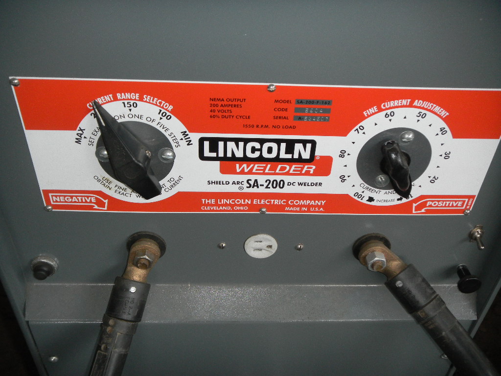

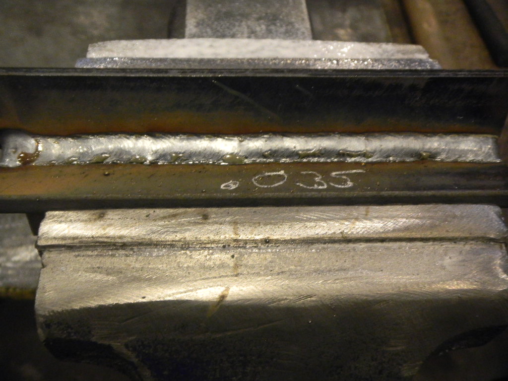

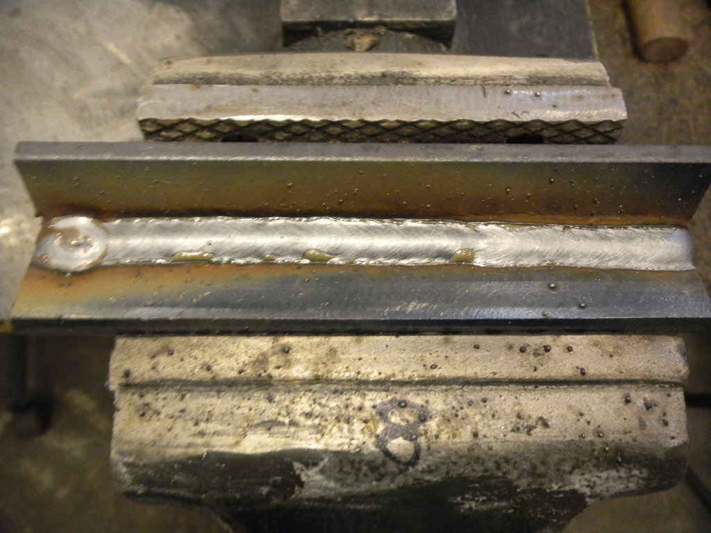

Well they won't run Mig, they're CC only welders. Here is what Mig looks like when run on a CC only welder. I did this with my 1966 Lincoln SA-200 engine drive.
Very, very hot!

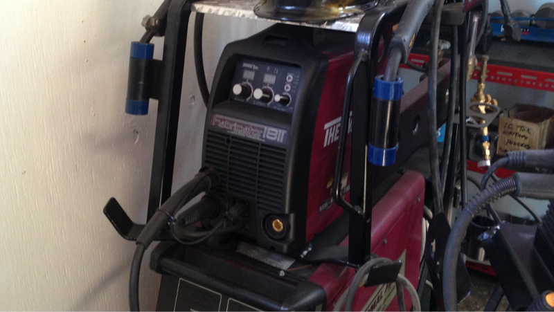

Here's another route to consider: Brand new Lincoln or Tweco 3in1 machines in the $1000 range. Mig Stick DC tig. dual voltage inverters. Put it on your credit card get the airmiles and 3 year warranty.
Here's my Tweco/ Thermal Arc
Happy researching (and shopping)!
Terry
