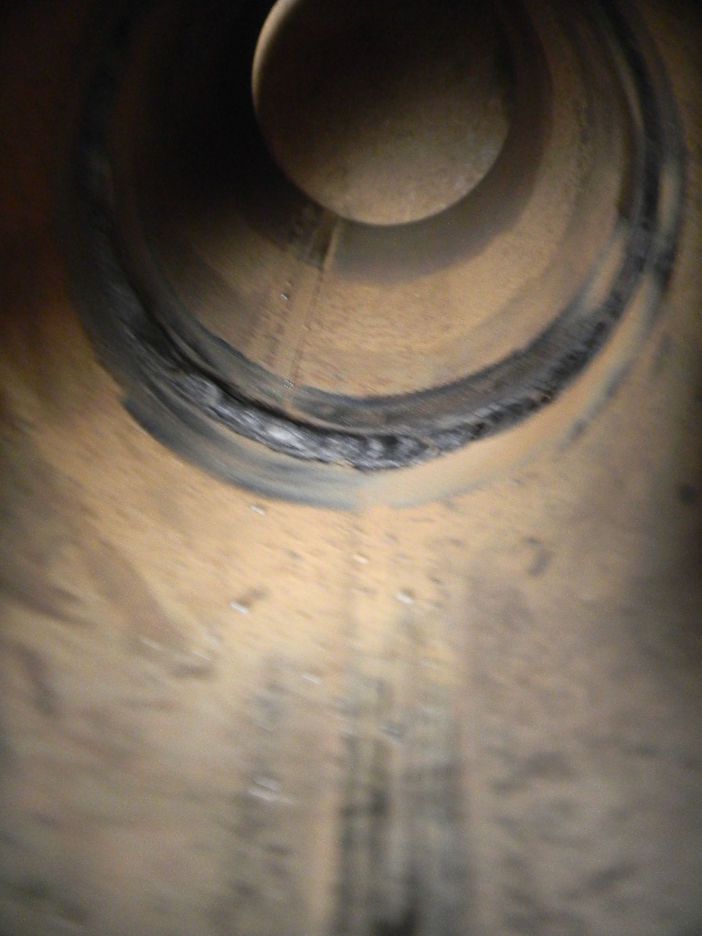

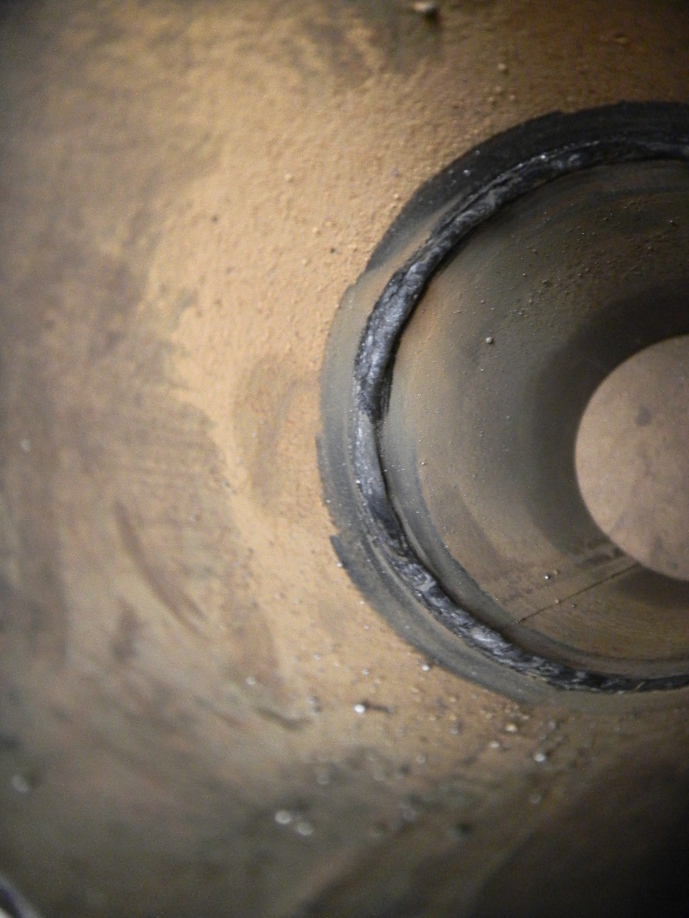

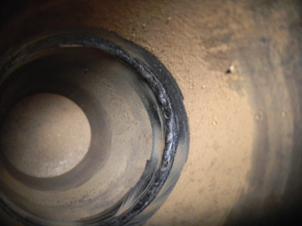

I use the lay wire technique on pipe for the root pass, and sometimes the hot pass. Depending how I feel at the time.

I'm not much of a Tig weldor either:eek:. One thing that will be a big help in learning to feed wire with your hand. When setting watching TV, or anything that will allow enough room. Take a rod and practice feeding it through your fingers! Do this when ever you have free time! It won't take long until it is second nature to you. Remember to practice with both hands!!!!!!!!!!!!!!!!:thumbsup:
   / PA160 STH unboxing! #127
I think your problem is the small wire that you are using. I never used anything smaller than 3/32" nor larger than 1/8" when TIG welding professionally and that is regardless of the alloy. 1/16 " is so small that you have to feed it faster than most folks can do comfortably in order to have any kind of puddle which shows up in the weld as erratic wire feed. 80-100 amps is plenty of power to use 1/8" wire but stick with the 3/32 for a while to develop your wire feed technique. Some folks will just hold the wire about 10" or so from the puddle (depending on how steady your nerves are) and feed it down as needed till the fingers get too close then momentarily freeze the wire in the puddle while sliding your fingers back up the wire for a new length. This is fairly easy to do, but practice like Shield Arc says to smoothly walk the wire thru your fingers.
You shouldn't have any undercut on the sides of your root pass since this is indicative of too many amps and or too little fill. Practice on tying in the sides but putting enough filler to reduce the side "wash out".
