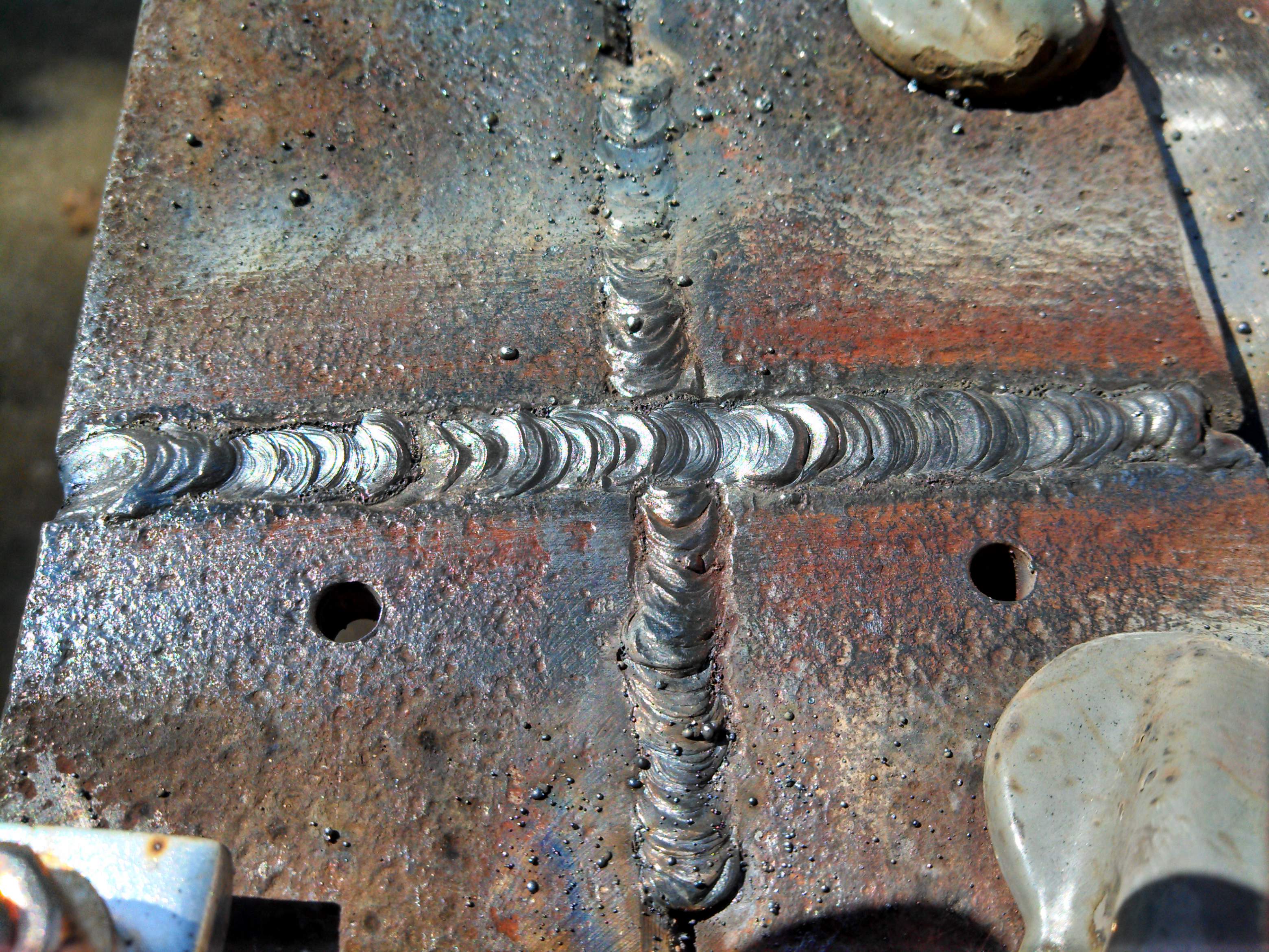

I did a little more practice today, with extra focus on joint prep: small lands (penny or less) and larger gap.
1/8" E6011, 85 amps. A little rough at the restrikes, and I still have trouble filling the crater at the end, but otherwise I'm very happy.
I was pretty pleased with the profile too.

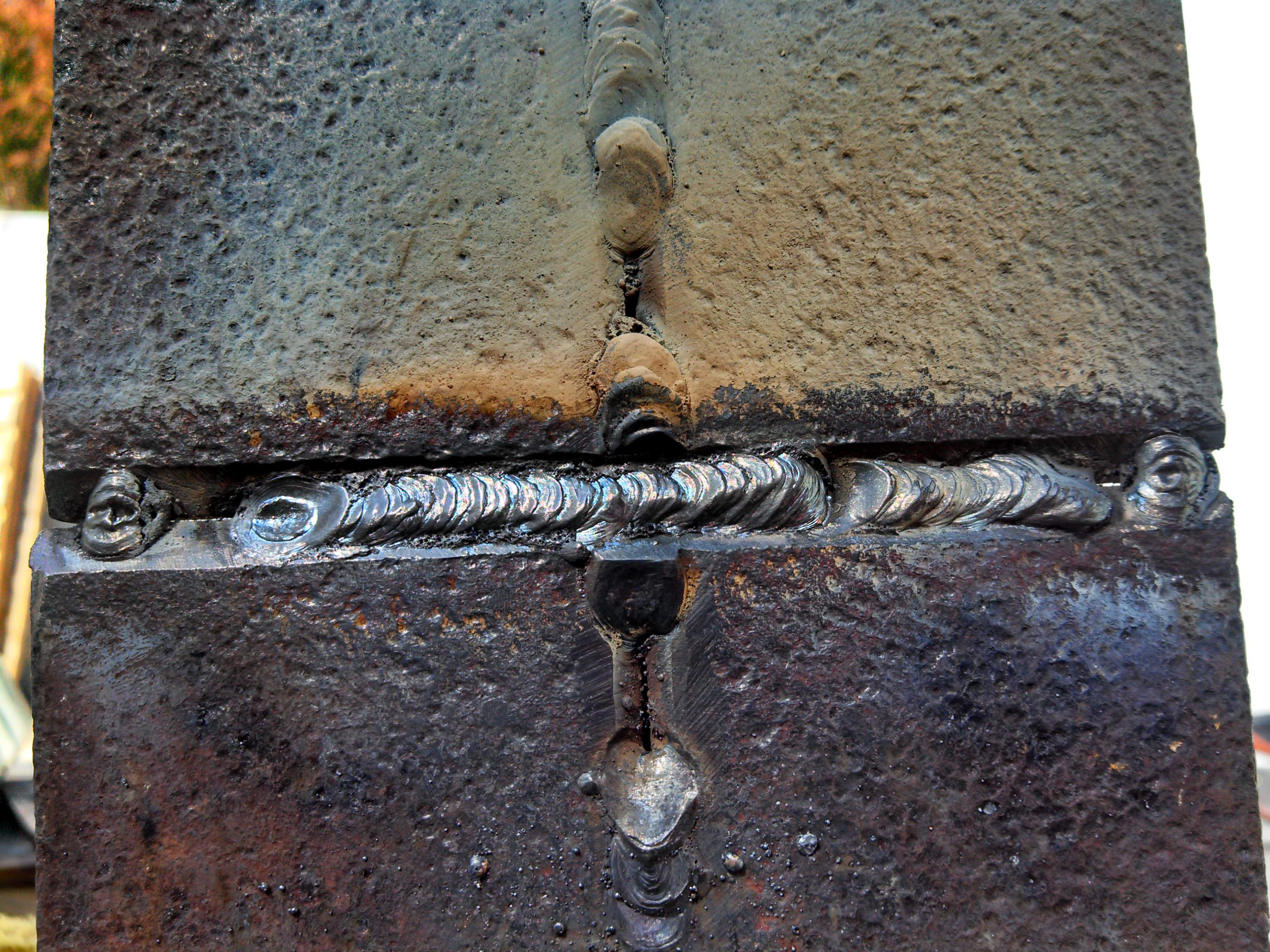

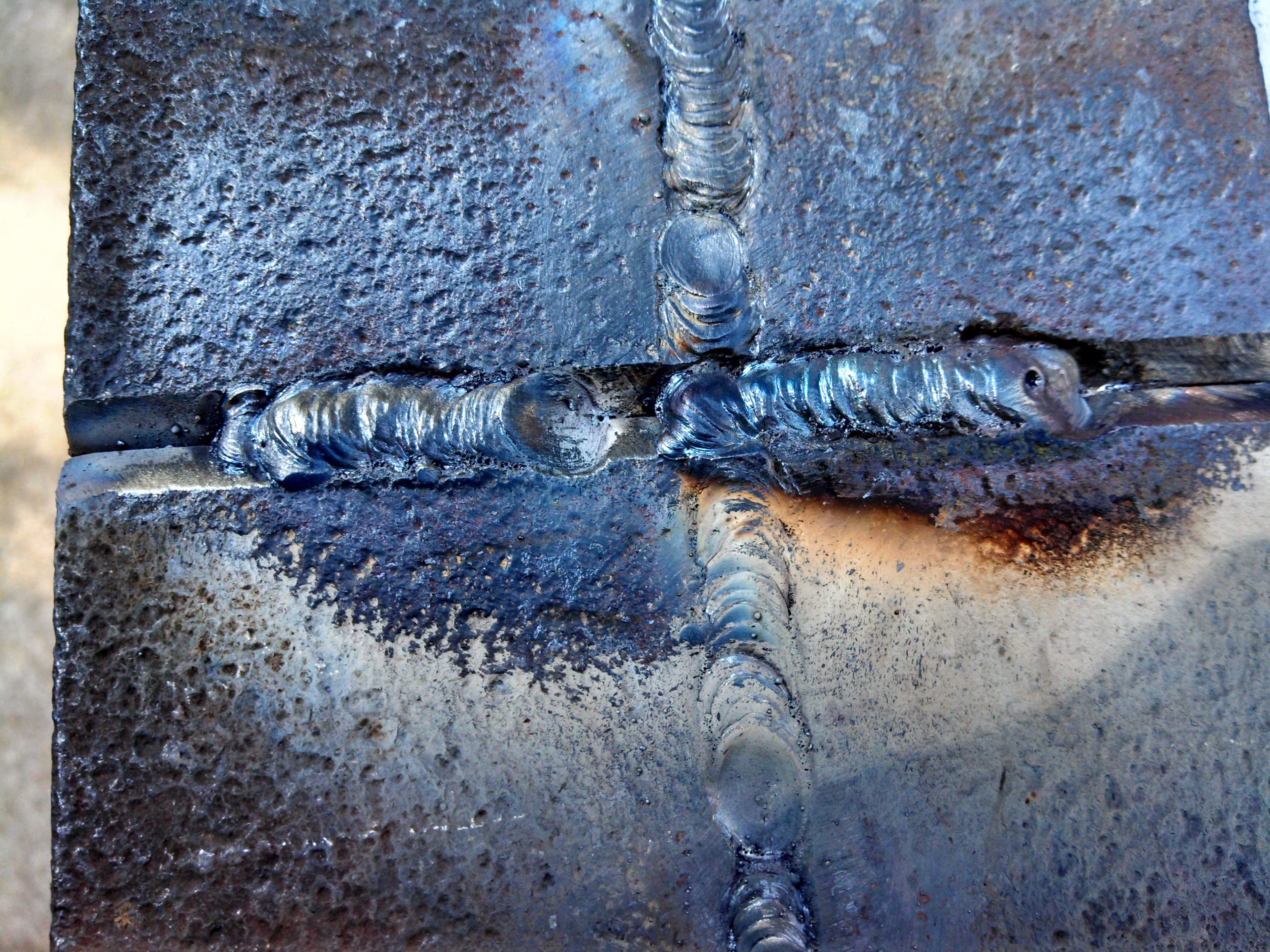

I was so happy at my flat welds that I decided to try some out of position.
Horizontal position, 1/8" E6011, 90 amps.
Vertical up. 1/8" E6011, 90 amps, then 95 amps. Don't let the fact that the photo is on its side fool you--it was vertical up.
Wow, this welder is night and day compared to my old one. Makes me kind of look like I'm not a total hack!
   / PA160 STH unboxing! #67
Those look pretty darn good.:thumbsup:
Far as filling the craters. Try closing up the arc length, and back up 3/8 to 1/2-inch.
   / PA160 STH unboxing! #70
I think it would help if you had some plate that wasn't so rusty. It looks like your plates have no gap at all. When doing doing root passes for the first time it will seem like you're going to blow a big hole right through because of the sound. When you have a perfect keyhole, you would just about be able to push the rod right through. A good root pass will almost look like you welded it from the other side. Shield Arc has probably posted pictures of this as well as the stack of dimes look. To weld with 6010/6011 you normally use a slow back and forth whipping motion instead of a straight progression like other rods. 1/4" forward, 1/8" back, 1/4" forward, 1/8" back, etc. etc. The idea is to dig kind of a trench and then go back and fill it up. Sometimes you have to adjust the whipping motion to suit the job. It's good to experiment with the back and forth motion.
