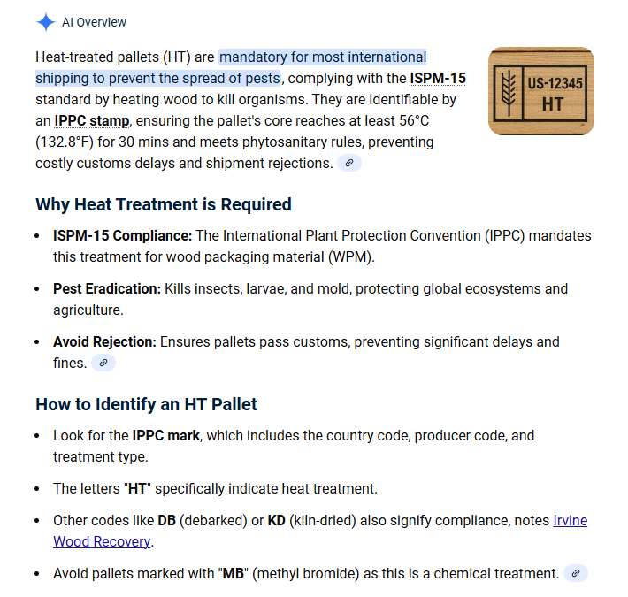

For international shipment you also need to look at whether or not your pallets will need to be heat treated. We have to use heat treated pallets with a certification mark (IPPC) that can be tracked back to the time, date, location, and company that did the heat treating. Something to do with making sure bugs don't get transported with the wood.
Yeah, this is all new to me! My first time doing a palletized export on my own, without a third party intermediary. Thankfully customer is in Taiwan, who have pretty loose standards. It seems any pallet of any age and origin will pass, as long as it has the IPPC's ISPM 15 heat treat marking.
I'm going to go check my pallet inventory later, to see what markings are on these we already have. I usually just re-use pallets received with our component orders, I always seem to have more coming in than going out, so I just save the nicest for re-use and burn the junkers. If I have a bunch with heat treat markings on them, I'll set them aside for this job, but I could also buy a few new pallets for this job if I need to. Heck, I could even buy plastic "international" pallets, if I really wanted to splurge.

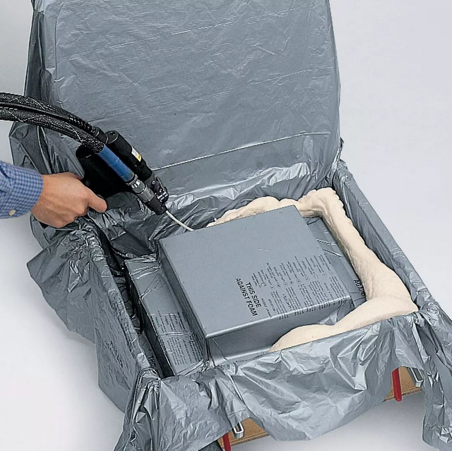

When I worked at St. Louis Music, we packed almost all of the Ampeg, Crate, Crate Pro Audio, and Audio Centron stuff with Instapak inserts made in a mold to fit each unit (like the one pictured below). It was a vacuum forming mold (we literally used a modified shopvac) with the two-part spayed in, close the lid, and let it expand for a few seconds. Open it up, trim off the edges with a sharp knife, and start another one. We shipped everything from light weight single rack space preamps to 70 & 80 pound SVT-IIPro & SVT-CL tube amplifiers. That stuff held up great.
(pic from the Instapak website)
The lighter weight rack gear was easy because we just made one piece that fit either side, made in a multi-unit mold. I probably have one around here somewhere. I'll see if I can find it and take a pic.
During my time at Masterclock, we teamed up with a local packaging company to develop what we needed. Their engineers came up with some pretty crafty cardboard origami inserts to protect those expensive clocks and displays. If you have a packaging supply place nearby, that may be an option, too.
That's the stuff we'd get a lot of equipment in at my old job. My current employer orders light fixtures in bulk. They come on 4'x 4' x 4' pallets in a box with that stuff laid in all around them.

For anyone else packing stuff, you can buy that material in pre-loaded bags now, with the two parts in separate bladders within the same bag. All you need to do is kneed the bag to rupture the two internal bladders and mix the material. I use a lot of them, in my business, as it's less messy and usually more convenient than having the old gun and hose system around.
Check out InstaPak, if you want to see the most popular version of this product.
However, in the case of these assemblies being like a stack of flat table tops (i.e. 50 pieces of deep 1U rack chasses), spray foam becomes a much less attractive option, as it would cause the boxes to bulge out on the broad face. I think I can get away with cardboard alone for the large faces, with sheet foam around the perimeter.
